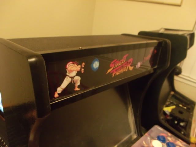

What do you mean by "marquee retainers hanging over the side panels" ?
I mean, like these:
I mean, like these:
That is not very nice at all,
im thinking of making a slot for the marquee to slide into from above

« Reply #9 on: March 04, 2013, 04:25:09 pm »
Hey now, after the constructive criticism I bought better marquee retainers. Aluminum L shaped thingys from Home- Depot.

« Reply #15 on: March 05, 2013, 08:09:49 am »
I mean, like these:
Good Choice, I didn't make a slot for my marquee to slide into and I am now paying the price. Yep that overhanging Bracket is almost exactly what mine looks like currently  :P I have a feeling some very careful routing will be in my immediate future  :banghead:
I mean, like these:
unstupid, what causes this to happen?  What can someone do to prevent the retainers from hanging over the side panels?
BobA
  • Posts: 5943
  • What Me Worry?
Re: Wickcade 2 Player BarTop
« Reply #37 on: March 21, 2013, 12:03:28 pm »
To prevent the holder from hanging over the edges just recess the front edges of the area where the marquee goes.  If the top panel and the bottom panel of the marquee area were 1/4 inch behind the sides of the panel there would be no overhang.   Adjust the 1/4 inch recess as required for your holder and plexi.
CoryBee
  • Posts: 2093
  • Bopity Boopy
« Reply #38 on: March 21, 2013, 02:29:27 pm »
Precisely.
Unstupid
  • Posts: 997
Re: Bartop Arcade 2013
« Reply #39 on: March 21, 2013, 07:19:22 pm »
I mean, like these:
Lack of planning..... Draw (by hand/by CAD) what you plan on building before you start cutting.  I lay everything out in Rhino (3d cad software) before I start cutting to make sure everything fits and makes sense before I send it to be cut!    ;)
