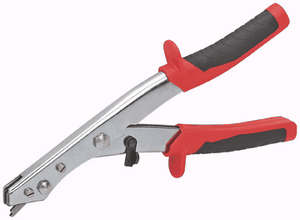

Use something better than a jigsaw to cut it or you'll end up with edges like this.
Angle grinder or dremel with heavy duty cut-off wheel would have been much better.
Harbor Frieght....
There called Nibblers
THIS
OR THIS
