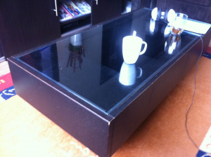

It has been quite a few years since I made my last cab (2004 according to the byoac search feature...) I had to get rid of my old cab due to space limitations, my game room is now my youngest son's bedroom. My wife knew I missed my arcade so together we were brainstorming how to get the arcade back into our house. She didn't mind having an arcade in the house if it was possible to make it not the centerpiece of the livingroom.
So, after some thinking and browsing other furniture arcades I found something that we're both happy with: our coffee table will be turned into a two player cocktail cabinet!
The build is complete and this is the result!

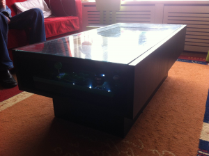

This is what the table looks like when in "coffee table mode":
Once you remove the covers, the control panels become visible:

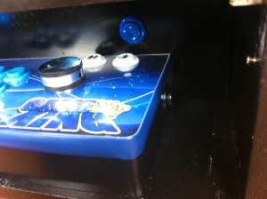

The control panels are illuminated by 3 LEDs. The photo doesn't really do it justice, but you get the idea. Perhaps when it's dark I'll make a new picture.

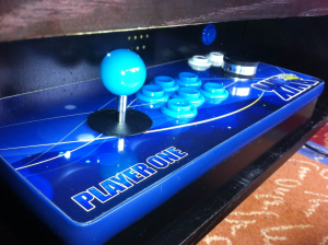

Control panel for player one:
It has 1 servostik joystick, 6 buttons, 1 spintrak and 2 flipper buttons. It also has the P1 start and P2 start buttons and a coin button.

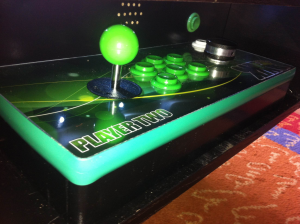

Control panel for player two:
It has 1 servostik joystick, 6 buttons, 1 spintrak. It has a P2 start button and a coin button.

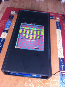

Arkanoid! The 32"LED TV is excellent for vertical games:

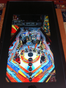

The PC runs Future Pinball perfectly:

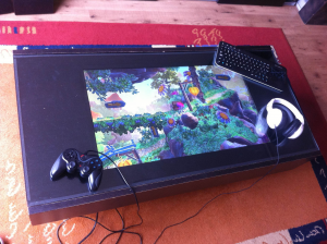

The PC is an Intel i3 3220 with Radeon HD6670 videocard.
For modern gaming the table has connectors for 2xUSB gamepads, headphones. The table also has WiFi and a bluetooth wireless keyboard with touchpad- so I can use it while sitting on the couch.
Running Giana Sisters: Twisted Dreams

Updates to the table itself: fitted USB ports, power button and power connector and headphone connector. The connectors are underneath the table surface so obscured from view. The TV automatically starts in the HDMI mode when the power is connected. Also, the mainboard had a BIOS setting that enabled booting when the board receives power.
I have also drilled holes for the speakers and soldered LEDs on wires to light the control panels. The LEDs and speakers are not yet in place- the three small top holes in the 2nd picture are drilled downwards and is where the LEDs will be.
Horizontal games go in cocktail mode, each player then has a 20" 4:3 screen.
