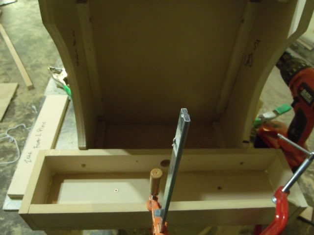

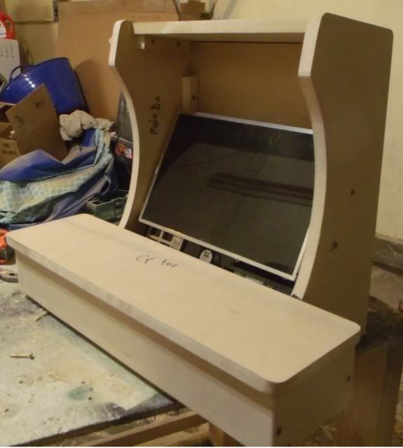

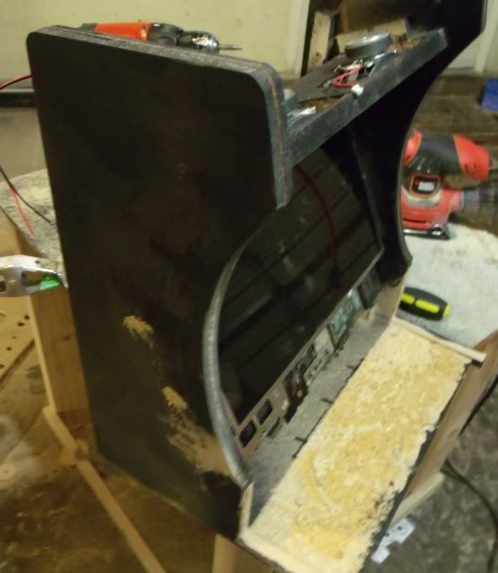

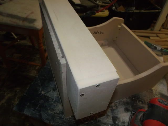

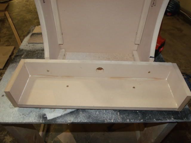

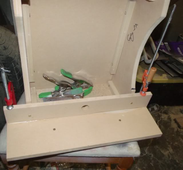

Number 3 - "2 Player Bartop"

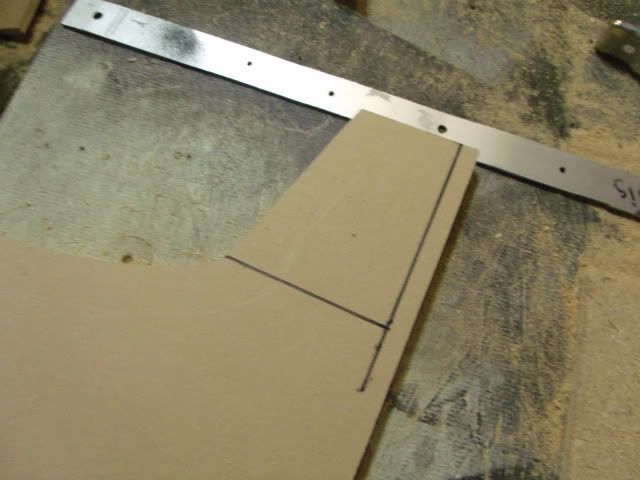

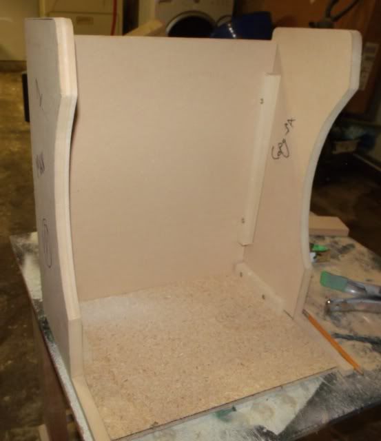

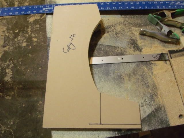

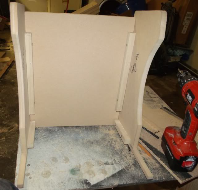

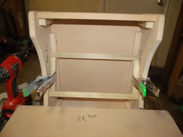

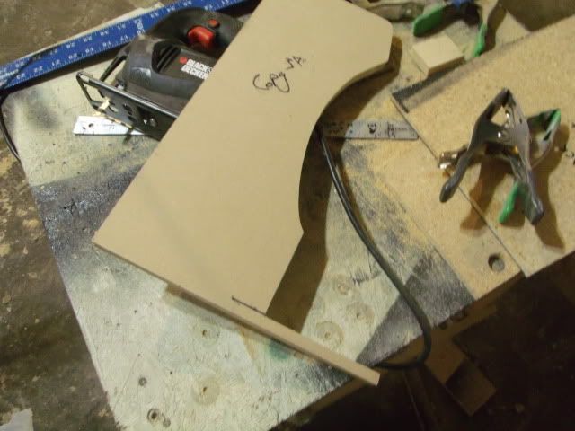

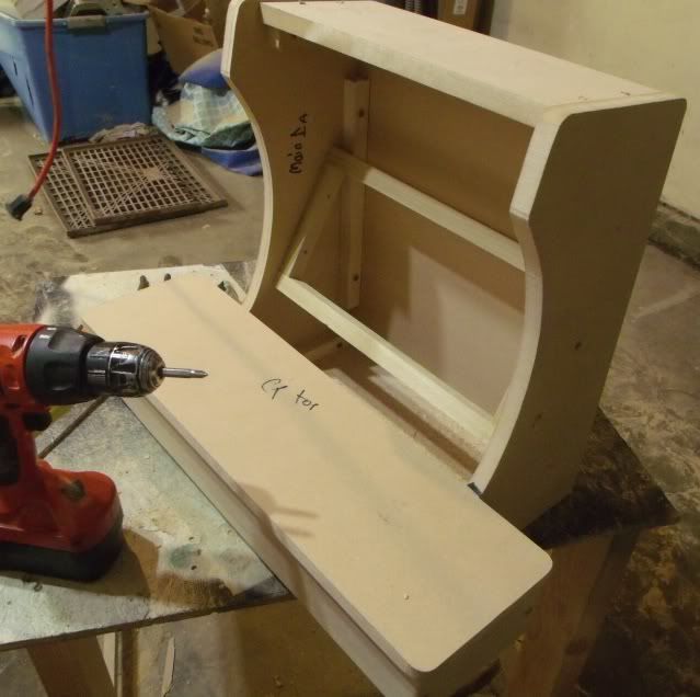

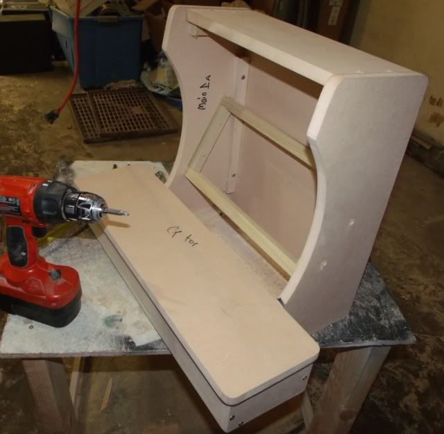

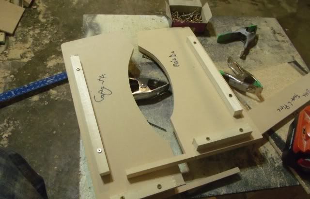

Got a ton of the work done last night, side panels were already cut and shown in this thread "Trio of Bartops"
Side panels trimmed to accept the future control panel box

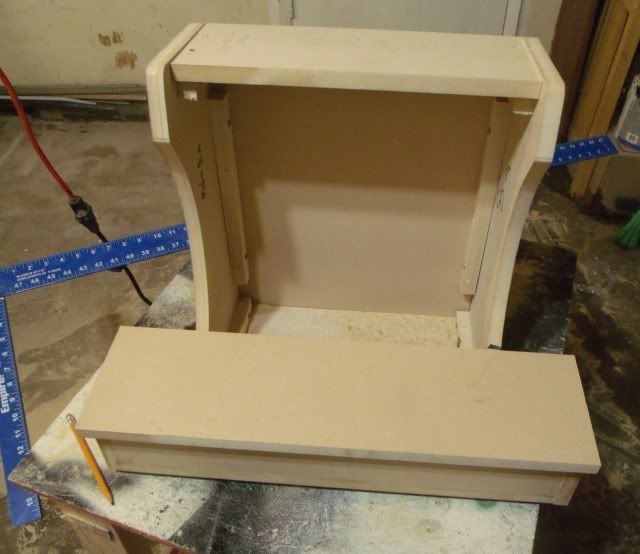

Supports added

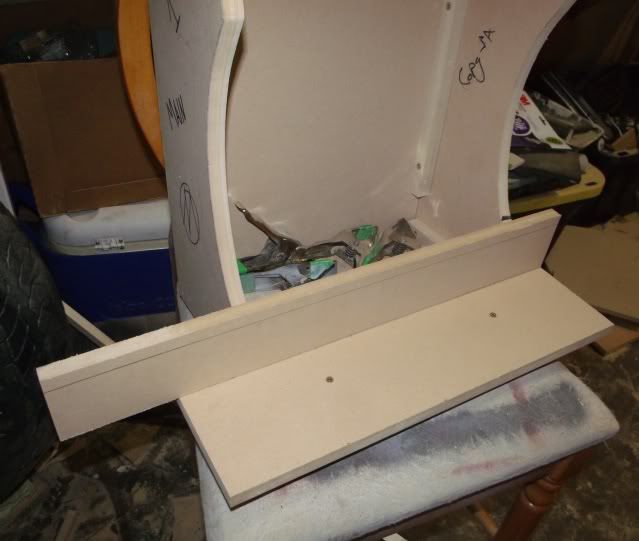

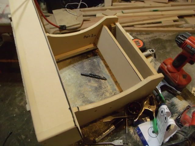

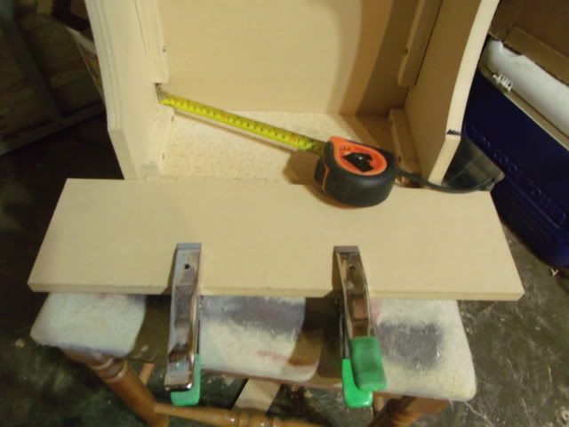

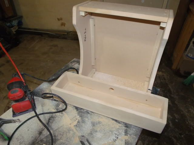

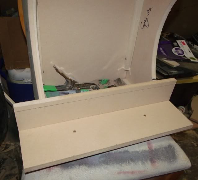

Chose to use particle board for the base because my MDF board is too thick, would add to much height to the thing
Cp base glued and clamped in place, all screws used on this are just to hold pieces together and will be removed and filled up after it dries

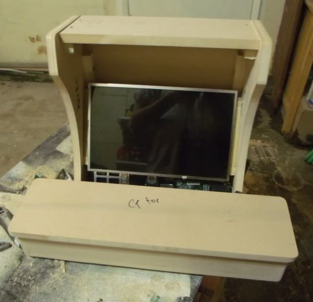

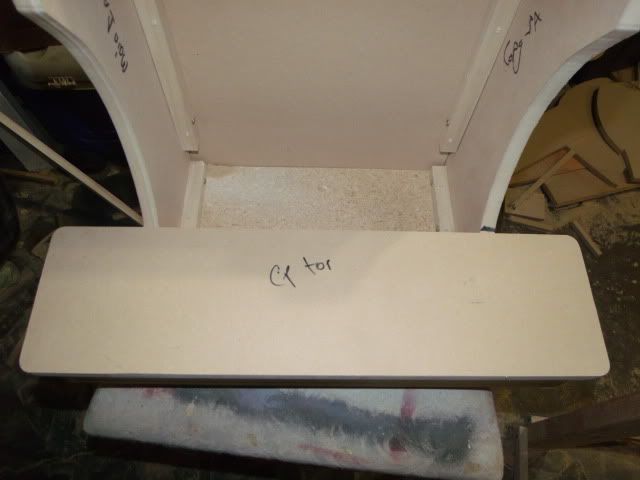

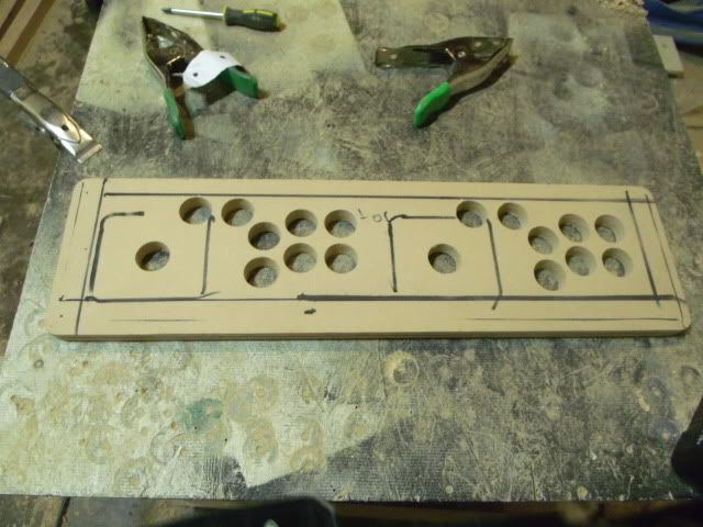

Cp top cut and rounded
Sanding any blemishes or miss cuts
Smooooooth

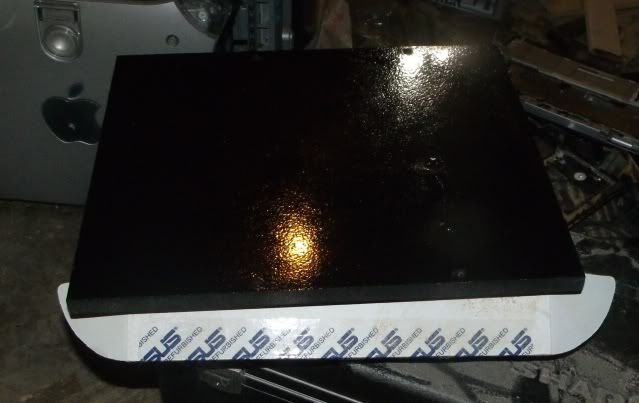

Laptop mount made out of 0.75" x 0.75"
« Last Edit: December 03, 2012, 05:44:38 pm by CoryDee »

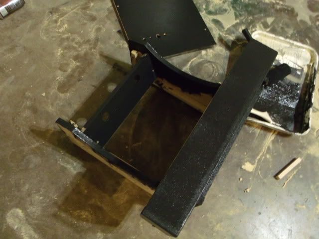

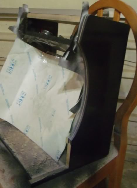

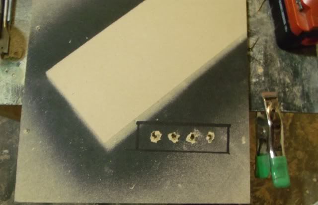

Speaker panel cut and added
Paint + Speaker holes drilled and special gap routed behind it

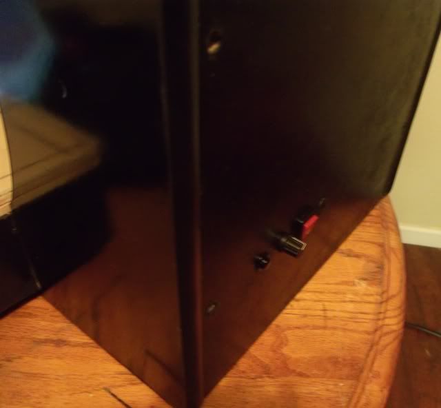

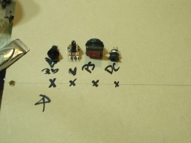

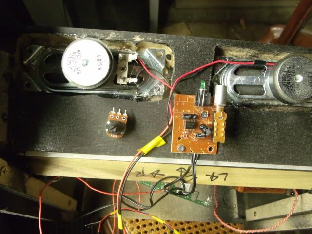

Had to remove the control panel cause I forgot to route for t-molding first, not a big issue. Also easier to add the final layer of paint with it off.
Routed
I broke one of the contacts on the speaker that came on the PC amplifier (cheap thing), so I replaced both of them with some TV speakers I had from a broken screen set. Hooked up to the amp and all is well again, actually sounds way better.

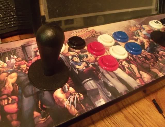

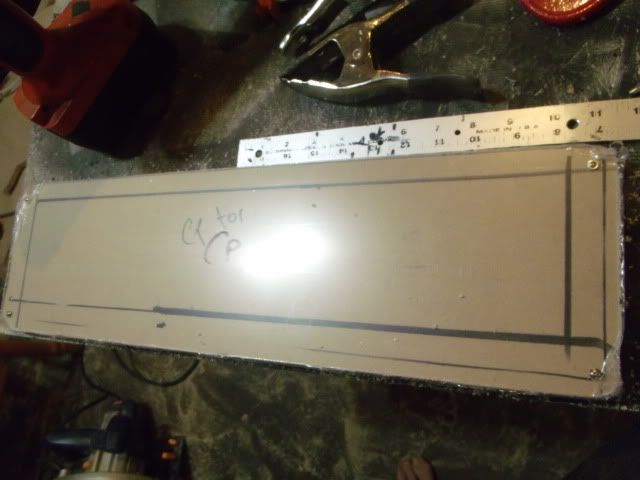

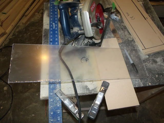

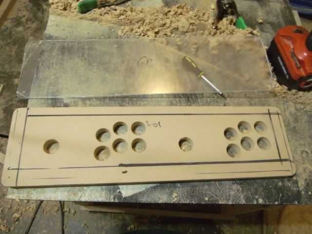

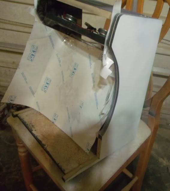

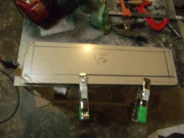

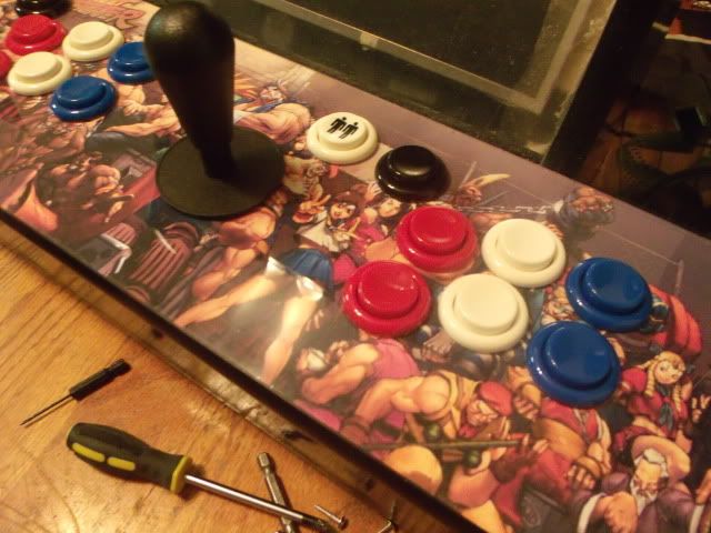

Cut the acrylic for the CP, then used the flush trim bit on the bastard to keep it clean
Tiny screws to hold it in place - ( angled shot )

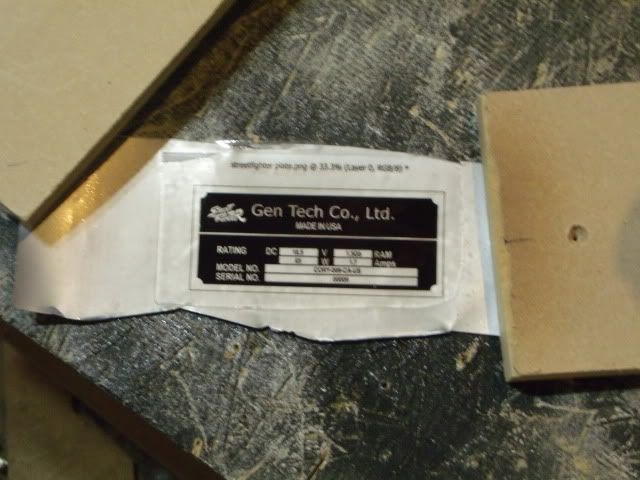

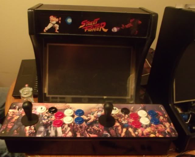

Got my Avery stickers in and clear coat in hand - Let's see how it works out
Test print to get everything perfect - ( make sure to set the printer settings to label )
The clear coat should soak into the sticker and let the aluminum shine through

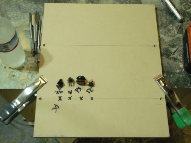

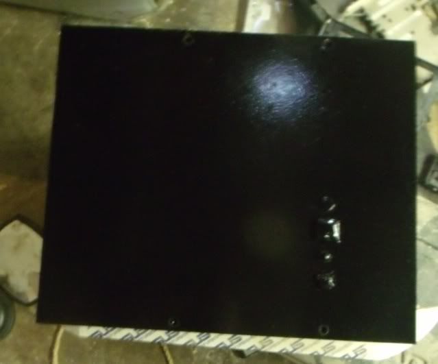

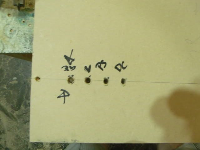

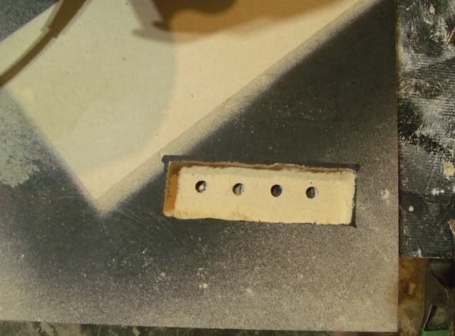

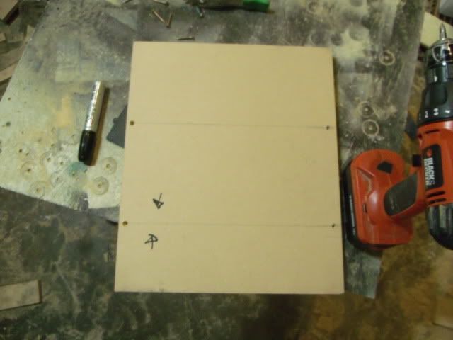

Back panel work - organizing the spots, drilling starter holes, routing out the other side so they can screw in properly
Primed and painted 1st coat

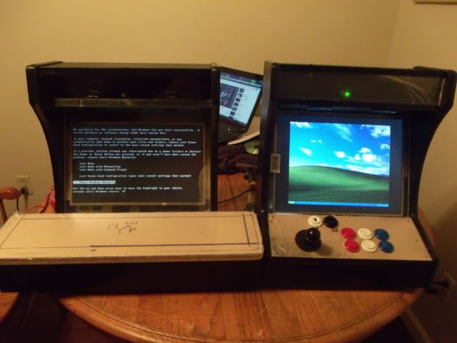

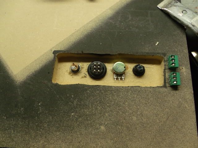

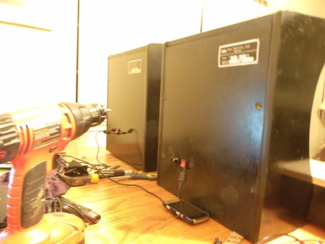

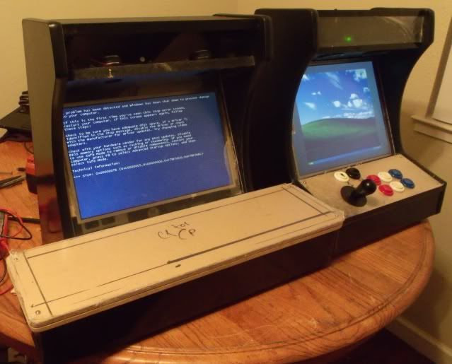

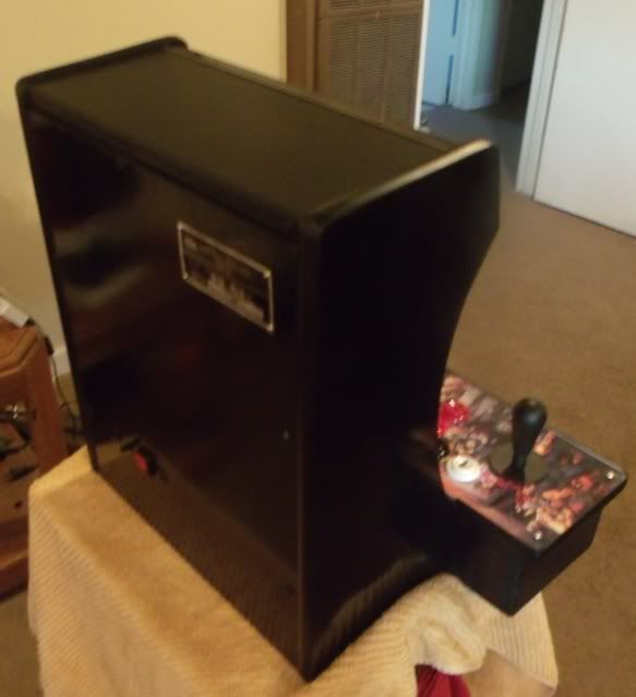

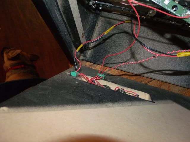

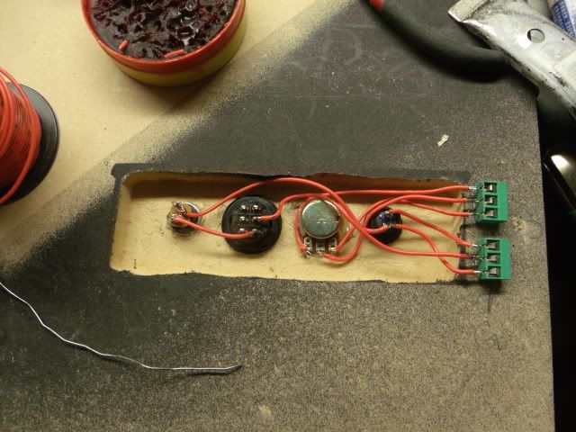

Back panel electronics installation - one of my favorite parts
Ended up putting one of the terminals on the bottom because I didn't like how the power wires were being stretched a little bit
I apologize for the ---smurfy--- pictures taken in this room, the lighting is horrible for my camera

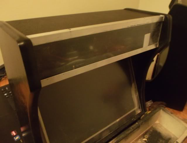

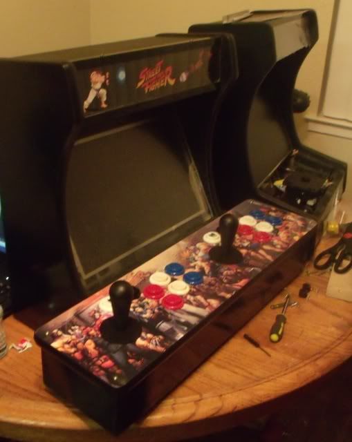

Aluminum marquee retainers (these ones fit!) - they are currently drying from paint
Side by side shots with the single player build here "Link"
Don't mind the resolution issue or the "blue screen of death" - these laptops haven't had windows reinstalled on them yet
One on the left I painted the side panels, the one on the right is vinyl

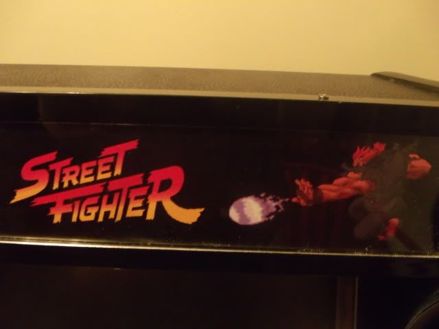

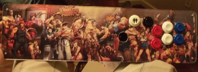

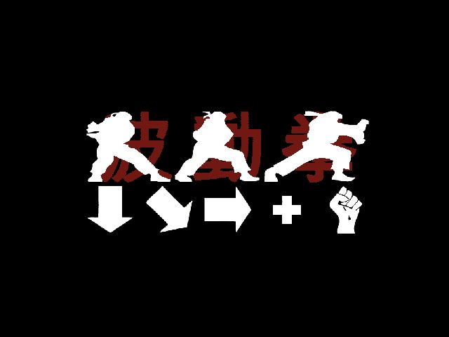

Art
Marquee
Control Panel
Boot Logo

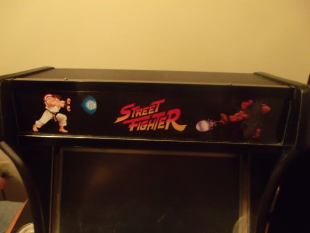

« Reply #19 on: December 08, 2012, 10:15:53 pm »
I think the Street Fighter marquee needs more.  It's just those three things floating in empty space.
Mainly it's bad in comparison, because that control panel art is so detailed.  That looks reeeeeaally cool.  Where did that come from?  Link?
CoryBee
  • Posts: 2093
  • Bopity Boopy
Re: 2-Player Street Fighter Themed Bartop
« Reply #20 on: December 08, 2012, 11:01:15 pm »
I left it blank like that because the cab is a solid black and figured it would look nice

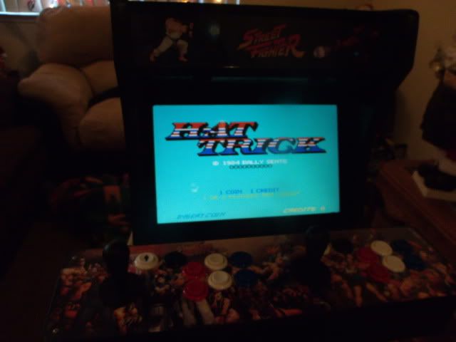

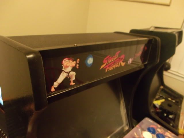

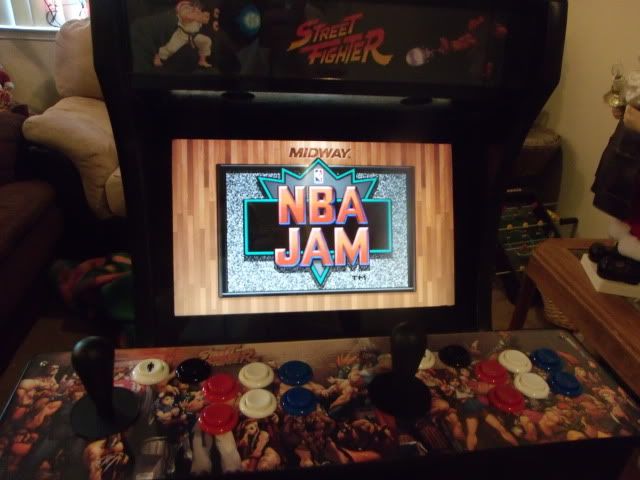

Had to kick up some more dust to get the art applied
CP art on and buttons half in
Marquee looks really nice - minus the dust, need to clean that up as usual when it is all completed and the acrylic loses some static
More of the CP and the finished artsy stuffs

« Reply #32 on: December 18, 2012, 01:29:41 pm »
Spray the bezel!
Re-Spray the back panel because I didn't like the way it looked
Showed the customer some pictures to choose the marquee and he told me to keep the one I already made. Hey Mikey....he likes it!
And cause I am bored, I give you;
Yoshi eating Blinky
CoryBee
  • Posts: 2093
  • Bopity Boopy
« Reply #33 on: December 18, 2012, 08:35:26 pm »
Back panel looking extra shinny now!  :applaud: Just how I like it, getting better at this whole paint thing (baby steps anyways)
Anyways, 2 of 3 bartops complete   :woot
Couple pictures and a quick video of the boot screen and what have you
Video
Edit: Long gameplay test video
« Last Edit: December 18, 2012, 09:12:17 pm by CoryBee »

Nice boot screen.  The cab looks good overall, but the quality of everything else does still kind of make the marquee look weak by comparison.
Looks like you've got some orange peel on the large black areas.  Not sure how you're painting, but here's what I do: build up a fairly thick layer of clear coat by applying a few thin coats one at a time, keep sanding to keep it flat, start using finer and finer sand paper, then finish it off with some rubbing compound and a rag.  I use a 3M auto polishing compound with recycled cotton shirt rags.  I can check exactly what grits of sandpaper and the name of the compound if you're interested.
CoryBee
  • Posts: 2093
  • Bopity Boopy
« Reply #37 on: December 18, 2012, 09:34:27 pm »
Thanks, and.... what do you mean by orange peel?

Orange peel is the texture you get when you paint and don't sand the first coat properly.  It causes the paint to build up and it looks like the outside of an orange.
For your selling rigs what your doing is fine, as getting rid of orange peel and getting a mirror/smooth finish is a ---smurfette---....
For giggles.....
Prime, let dry, and sand, then prime again, and sand with a finer grit sand paper.....get you some tack cloth and wipe it clean....
It should feel really smooth to the touch....first coats should be light, then cut it back with a finer grit sandpaper, then paint again and if you do it right no orange peel......Let dry
Then hit it with like 4 or 5 coats of clear, wet sand, and then you can hit it with a compound, swirl x and then buff with wax......mirror like results....
This is sick....

On the subject of marquee art, can any of you guys that have better ideas than I edit this .psd file with something more fitting to the CP?
Everything I find isn't resizing right and is becoming a pain cause I want to get it to the customer. He already said he liked what I had on it but if I put something better I am sure he wont mind.

I came up with this, found some better graphics, and overlayed
rCadeGaming
  • Posts: 1256
  • Just call me Rob!
« Reply #41 on: December 21, 2012, 12:47:20 am »
Damn.  That gets my vote.
