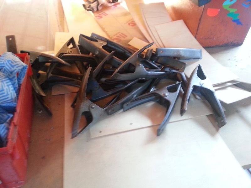

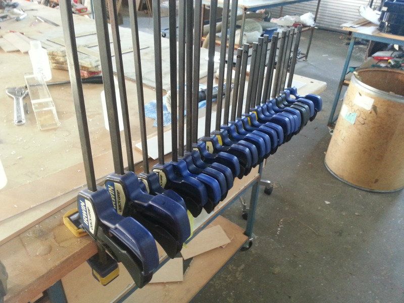

Clamps, clamps, clamps, and also some clamps.  You can never have enough different types and sizes of clamps.

Oh yeah a few clamps are nice but I still would like more...

Oh, did anyone mention Clamps?  :D
