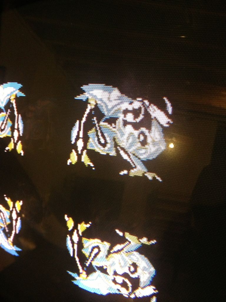

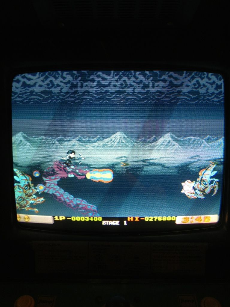

I have a weird sprite issue on my Dragon Breed. Made by Irem, it runs on the M-81 hardware. The dragon/player/enemies are all partly transparent and the colors that are present are off. I reseated every socketed chip on both boards as well as cleaned the legs with a pink eraser. (Though didn't look like it needed it, board in tip top shape visually)
See pics...

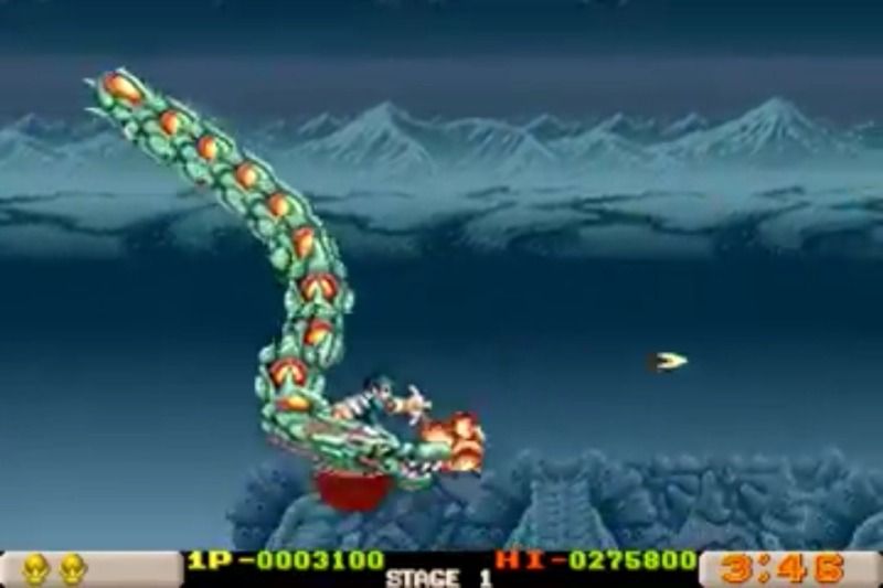

This is what it's SUPPPOSE to look like..
This is what it looks like..note the off colored explosion as well.

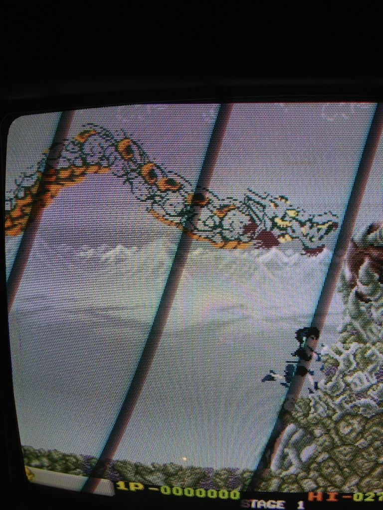

Here is a pic with all the lightning right at the start of the game, to show the transparency/color issue better
This is the only problem. The BGs are great, sound is killer (love the music in this one), and its quite playable as is, but obviously want to tackle the sprite issue. Thoughts?

Yes. Ram/rom check ok. But character screen shows the problem/transparency:

if you have the ability, pull the ROM chips and do a checksum/compare with a known good copy.
system tests are sometimes fudged to make it look like it's actually checking...wherein the are actually just doing a basic connectivity check. (IE no CRC or check summing the contents.)

this seems pretty regular. I'm leaning to corrupted RAM data. This is why people are suggestion cleaning the legs of the chips and checking voltages. both can corrupt the data streaming out of the chip on it's way to it's destination.
have you checked the voltages (particularly the 5 volt line?) some machines can get pretty picky. check at the ROM chips too. usually the 5 volt input on them is opposite of the pin 1 (opposite sided pin of the dot marking pin 1 or to the right side of the "notch") they all should be 5.00 volts or more. never anything less.
