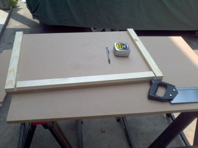

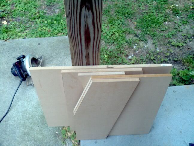

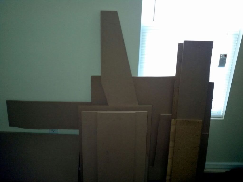

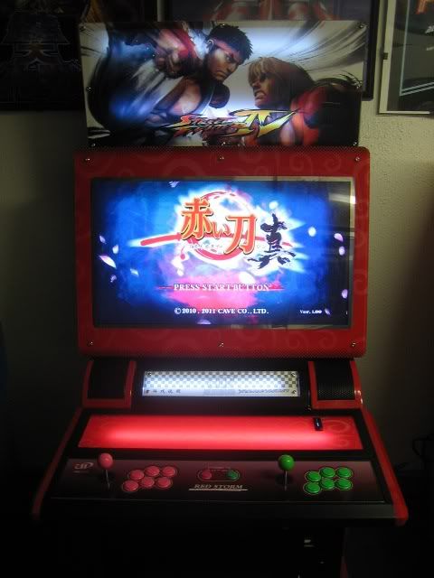

So this is a build that started out about a year ago that never got done and at the time I was going for SNAAKE's american vewlix look
so I got my wood cut out
and started to assemble the parts
and that's as far as I got befor it got cold out and lost interest in it untill last night when I decided to do a redesign on the cab to look like the Red Storm cab
so now this is where I'm going with this cab
using what I already had from the "american vewlix" I started to cut it up to the above
so this is where I'm at right now and hope to get some more work done in the next few days

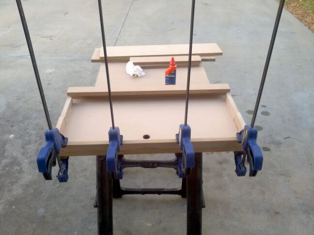

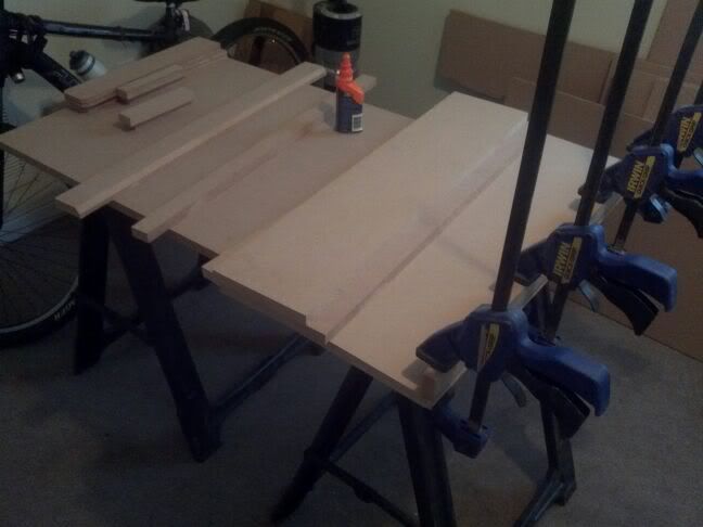

Got the bottom box all clamped up ready to  assemble
And  promptly got it screwed together
Its not perfect but will do the job, now all that's left for the bottom half is fill and sand the screw holes and  attach the sides

Re: Re: Blue Storm
« Reply #2 on: July 03, 2012, 03:01:26 pm »
Got the sides attached today but this is about all I can do until I get more wood

« Reply #5 on: July 05, 2012, 05:39:42 am »

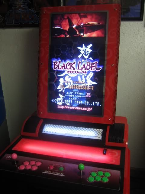

Looking good so far. Is the screen going to 'tate for shmups? It would be truly awsome if it did.
Click a pic for a video tour
  • Posts: 9794
  • Last login:Today at 12:28:37 am
Re: Blue Storm
« Reply #6 on: July 05, 2012, 05:54:00 am »
Please tell me we aren't starting this thread derail again!  >:D

Yes the plan is to be able to rotate the screen not sure how I want to go about that yet but I'll prob just keep it real simple.
Right now I'm working on the cp overlay
Close up shot of what I got so far  really don't like working with such a big image  its 6 3/4 x 30"
Sent from my Xoom using Tapatalk

That red storm cab is really nice, can't wait to see this finished,. how does the red storm screen rotate?

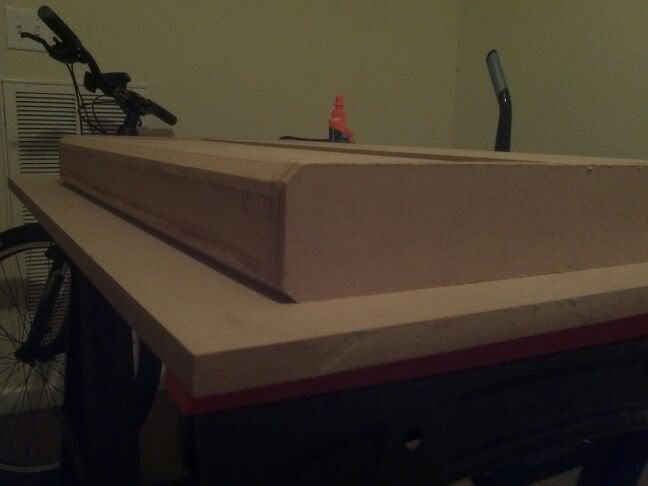

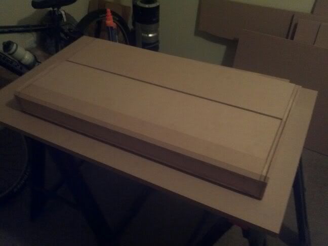

« Reply #22 on: July 16, 2012, 05:18:53 am »
Got some work done today, got the speaker box almost done and most of the new cp cut out
Speaker box
Still need to do some work on the part with the  angle
New cp sanded and dry fit
The cp is almost ready to glue up just need to trim off 1/16 from the back and front glue it up and bevel the front and bottom I hope to do this tomorrow.

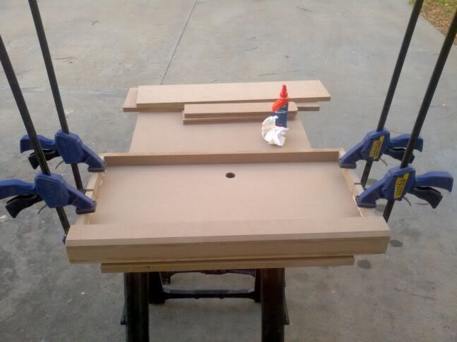

Getting the cp glued up
Didn't have the time to finish the cp up so will get that done tonight and routed tomorrow.

Quick question how much space is there on vewlix cabinets from the bottom of the cp to the floor?
Sent from my SCH-M828C using Tapatalk
Dave_K.
  • Posts: 1807
  • Last login:July 06, 2022, 03:27:30 pm
    • Arcade Fever
Re: Blue Storm
« Reply #27 on: July 16, 2012, 10:36:36 pm »
On the Red Storm, its 22+1/2" from the red foot to the bottom of the control panel, but there are leg levelers that can adjust +/- 4".  So with the leveler, its currently sitting 24" from floor to bottom of panel.
Not sure of vewlix, but I'd expect similar ~24".  To compare, a standard Sega Astro is a lot lower at 22" to bottom of panel.

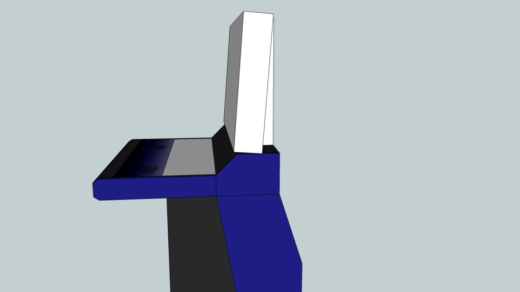

Now I'm off to finish up the sketchup model and maybe work on some more of the artwork

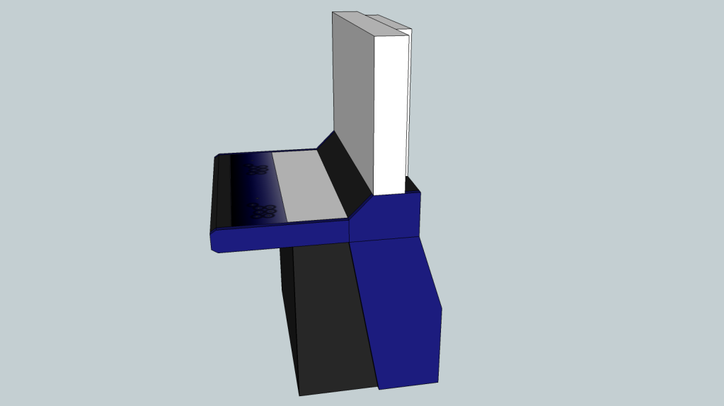

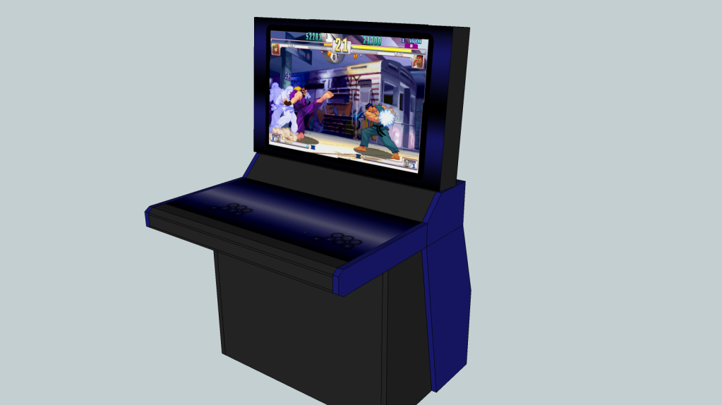

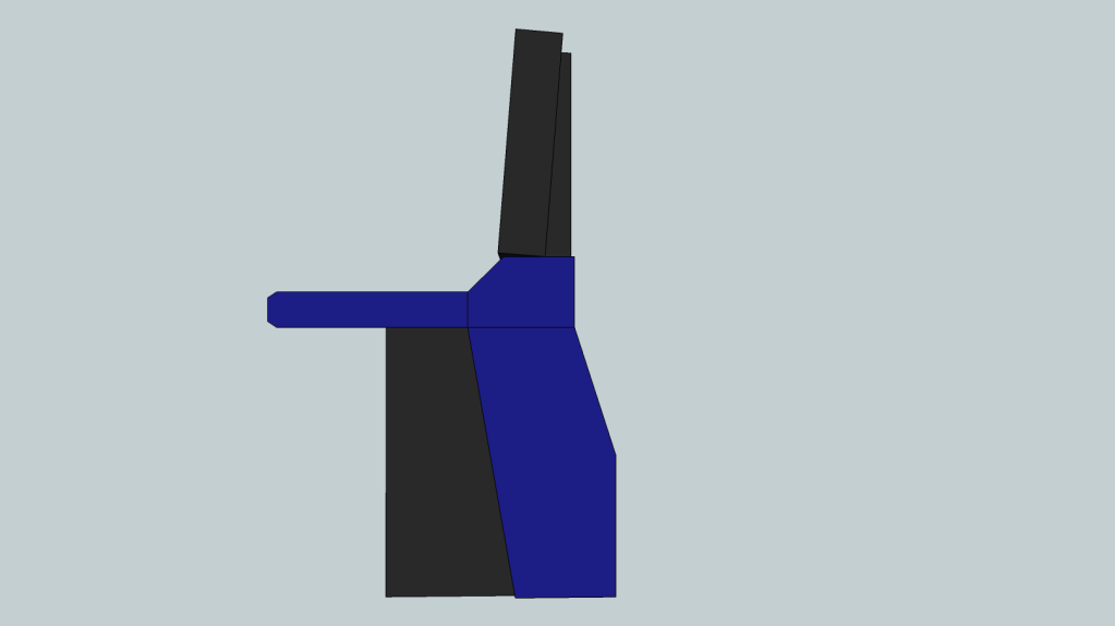

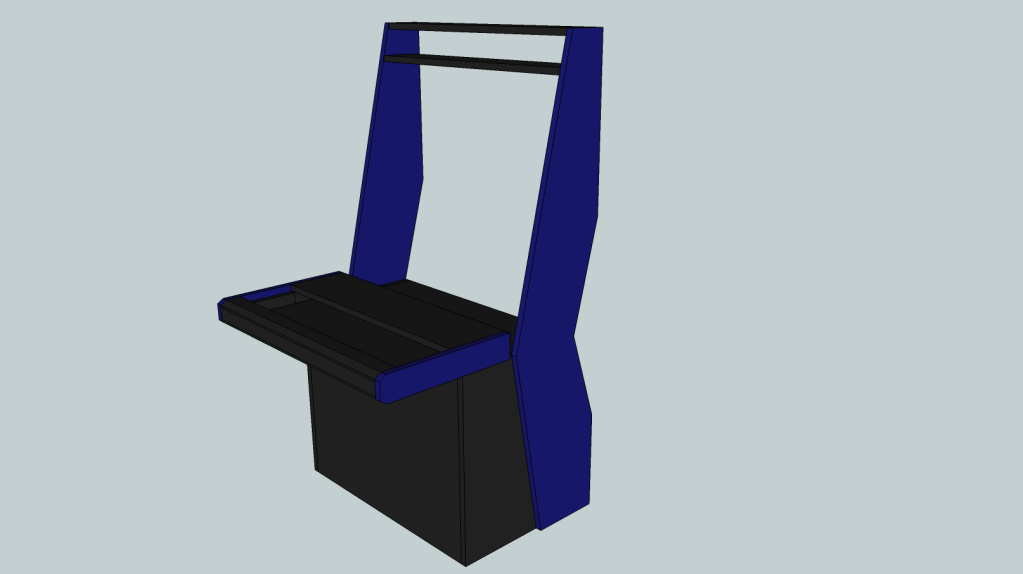

« Reply #30 on: July 17, 2012, 05:23:00 pm »
looking for some opinions
straight on
or angled
  • Posts: 2021
  • Last login:October 04, 2026, 05:40:18 pm
Re: Blue Storm
« Reply #31 on: July 17, 2012, 05:26:16 pm »
Straight.
  • Posts: 9290
Re: Blue Storm
« Reply #32 on: July 17, 2012, 06:19:33 pm »
Mock it up ----> whichever feels right.

« Reply #34 on: July 17, 2012, 11:34:12 pm »
straight on
or angled
Angled, since that's how it is on the Red Storm.
  • Posts: 2021
Re: Blue Storm
« Reply #35 on: July 18, 2012, 03:33:03 pm »
Changed my vote to angled.  :cheers:

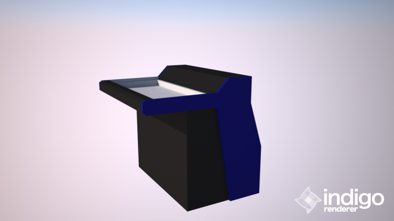

« Reply #36 on: July 18, 2012, 11:39:54 pm »
looks like angled it is. when its all done it should hopefully turn out like this
All artwork is done may need to change it up alittle wont know untill i do some test prints on it
cp still need to add the p1 and p2 start
cp 2
bezel
