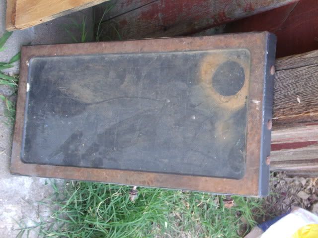

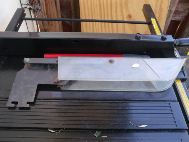

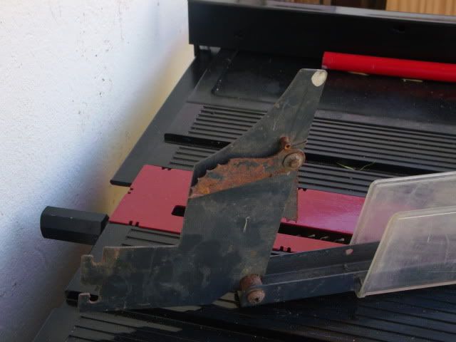

Thanks for the information guys, anyone know how I attach this thing?  :dunno
The person I got the table saw from said that this blade guard goes to this saw, but I don't see it..... :dizzy:
There is also this thing she says goes to it -  :dunno
Thanks again guys, I'd buy you a beer and a sandwich if you lived close to me  :cheers:

Theres probably a sheet metal or cast iron thing that holds the motor and blade, under the tabletop.  this is referred to as the blade trunnion on belt drive saws.  I think you have a direct drive saw, don't know what it's called in that case.   You can see it by looking down under the blade insert plate.  look for two tapped screw holes in that piece on the back of the blade.  They go with the hook shaped slots and allow the guard to come up behind and over the blade.  Also, check your model # online, most sears/emerson saws have manuals available.  you'll probably have to get a couple of machine screws.
The other sheet metal piece is a second table wing like the one you have installed, to go on the left side of the blade/table.  your fence rails are set way to the right, to extend the right rip capacity beyond what's probably a good idea on that saw.  I would look at the holes in the cast tabletop piece and see if there are additional holes that would allow the fence rails to be reinstalled further right.  Then, they could support your extra wing.  nice for supporting wider workpieces.
