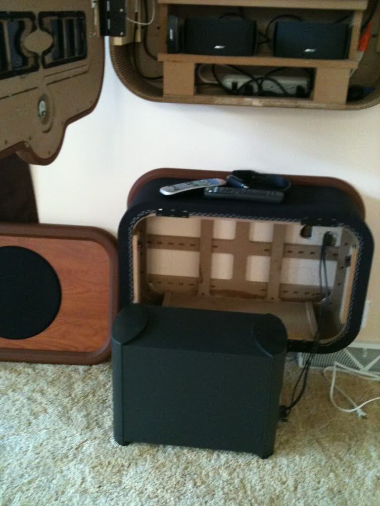

Well it looks like you got the right friend , the right tools and some CnC skills ...
But unless you go wireless (in wall) and you have a place for your sub woofer ... you wont really be happy ;-) ...
(yes i know you can see 1 wire , still a work inprogress )
Good luck with your build , I will be watching this post closely ...
