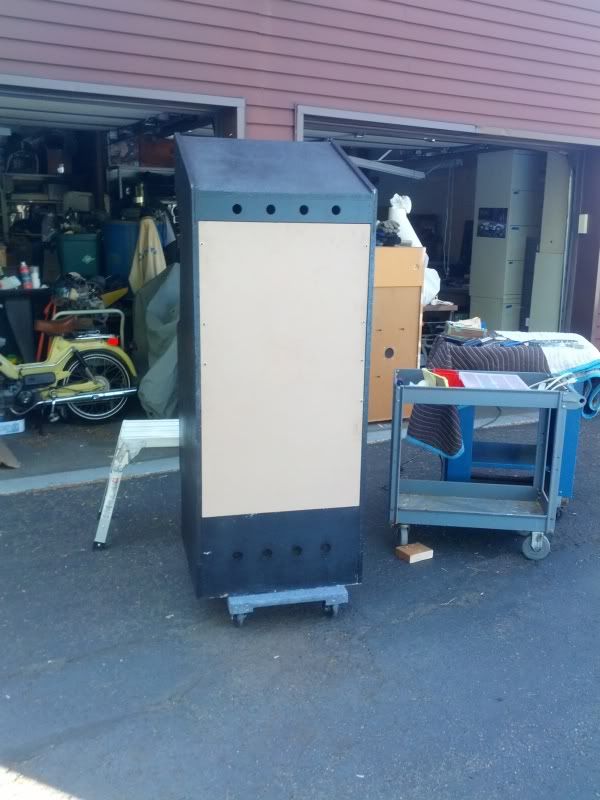

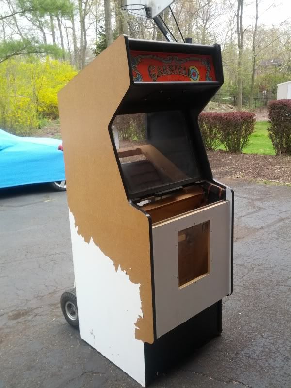

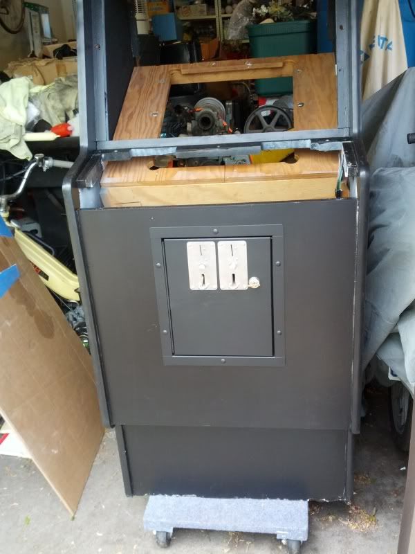

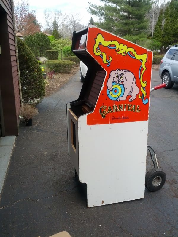

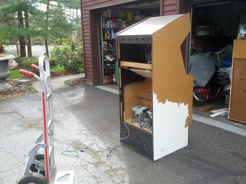

Welp, I picked up this cab last year for free, it was missing a monitor, and was in bad disrepair. The coin door was missing and various parts were gone. Funny enough, the gameboard was still intact, but a wiring nightmare. I spent a week figuring out the wiring, a year trying to source an original working 1980/81 WG k4600 vert monitor with zero luck.

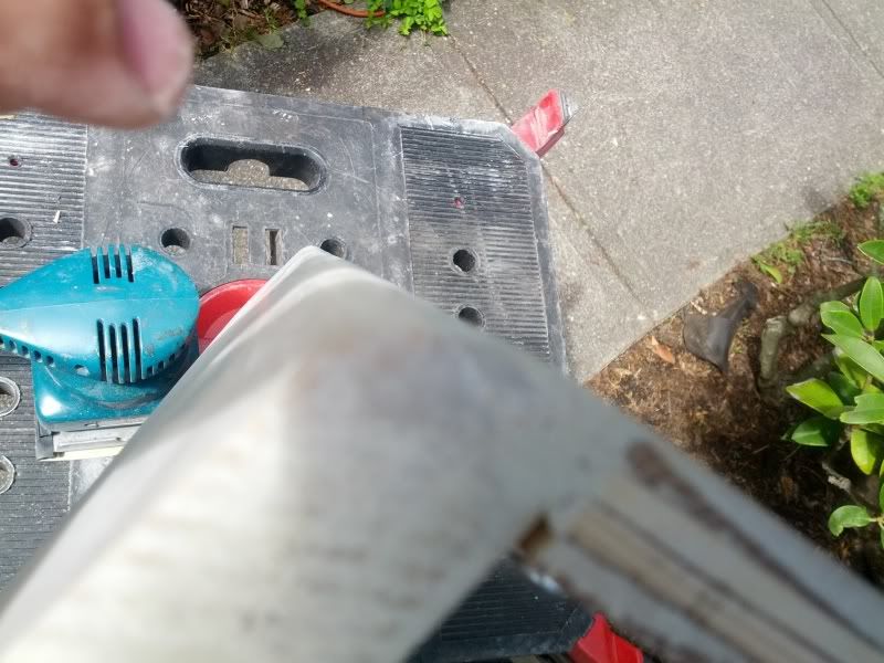

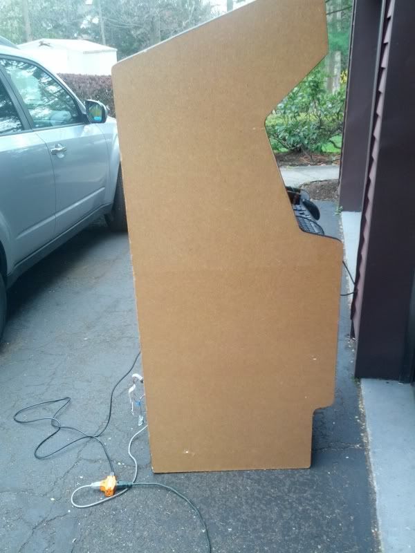

Realizing I'd never be able to find side art repro for this cab, that i don't really enjoy the game, that the roms on the board were shot, and that their was acid damage to the board, I decided on something different.

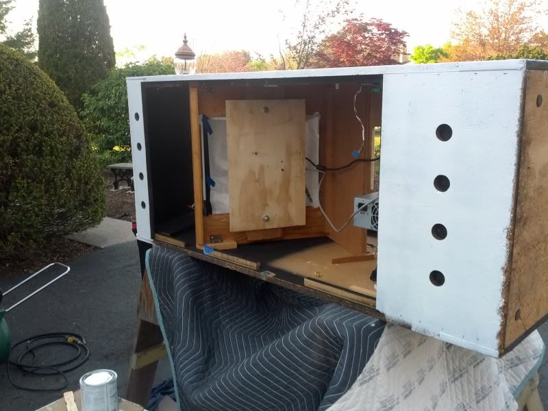

Two days ago i started peeling back the sideart, and found i could expose the base side mdf fairly easy.

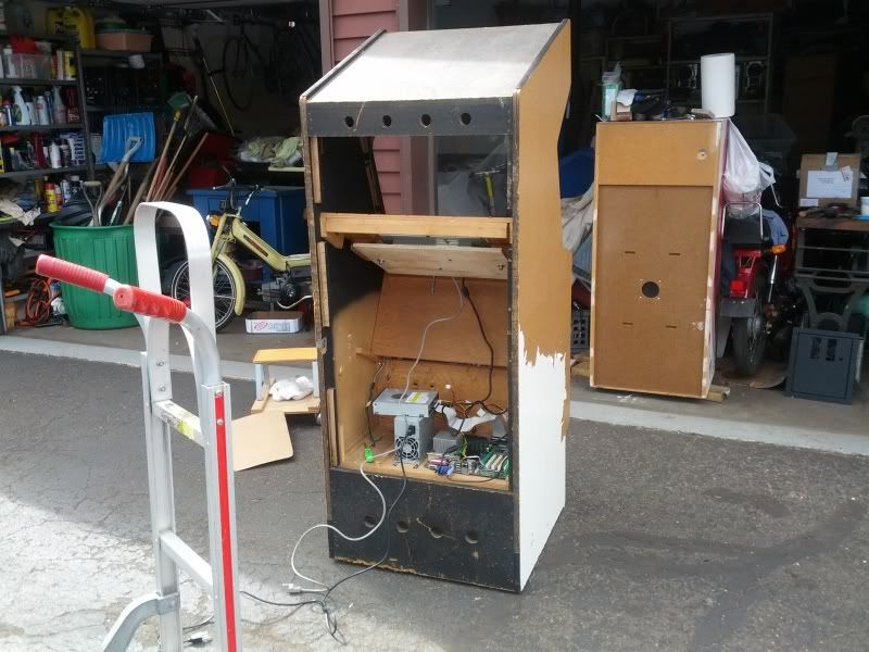

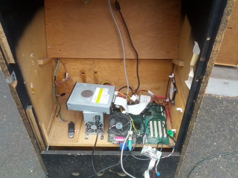

Last night i put together some left over old pc parts from an old client i re-did his computers and took the old POS dells. I booted up windows tiny XP in my basement open without a case just to test out the system.

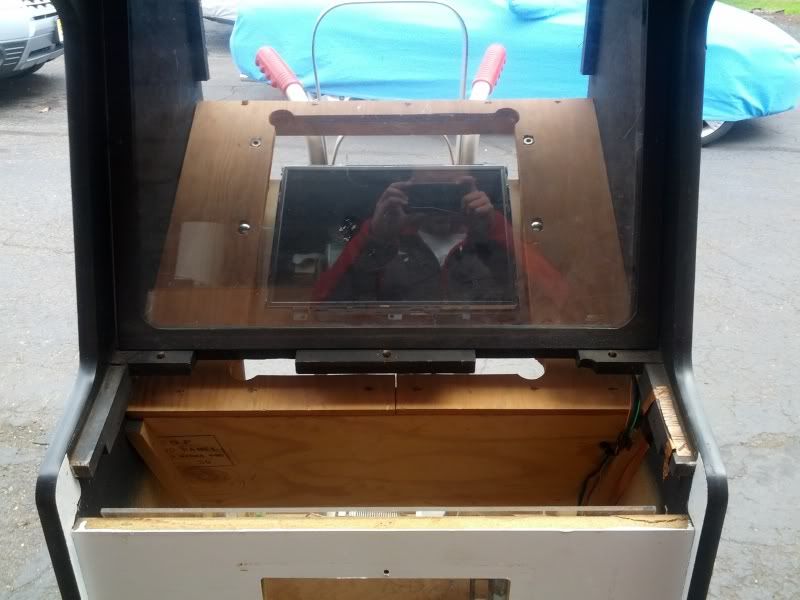

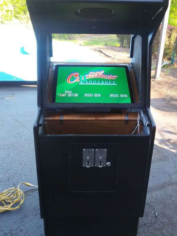

Also today I found a small 4:3 Dell monitor and de-cased it and mounted it in the cab. It looks small but it will do the trick. I haven't decided whether or not to make it a vertical mame machine or a horizontal.
I worked all day on installing the screen and pc.  Once installed, I tried a few different builds of OS's Tiny 7 which was outdated and missing several needed components like .net framework. I eventually settled on MicroXP, no frills, boots ok on this old 2.6gh Dell Optiplex GX270 parts machine.
However, I have a slight problem with the mobo.  In moving the unit into the cab and installing it there, I somehow caused an issue with either the BIOS, CMOS, and or Caps are going to explode.  I cannot get the ---smurfy--- dell mobo to POST after shutting down the unit.  I have tried multiple different power supplys none makes a difference. I've found if i pull out the CR2032 bat and reset the cmos i can get the box to reboot but it gives me errors.  Either way i am spending too much time on this outdated useless watt guzzling p4 dell mobo.  I have found a work around by ripping the power cord out the back and letting the system run out of power.
it will do for now.

GX270's are notoriously bad for blown capacitors, are you getting any lights at all, if you just get an orange light (I think it may flash) then check seating of cpu & Ram, check the psu and then finally check the caps towards the back of the board (VGA Socket area etc).  If you were UK I would send you a brand new replacement for the board :) We got a cupboard full of them at work, dell sent us them due to how many were failing. Also if you can get into the Bios there should be an option to disable the tamper switch :)

thanks guys. I will eventually install a CRT monitor once I get the machine up and running.  I am on the lookout on north jersey NJ craigslist scouting for 27" sony trinitron with 1080i output. right now they can only be found for over 100 dollars and not working.
As for the POS dell. I got what I deserved.  I had these part lying around and I have more.  I am at the point where I know there's a CMOS/BIOS error memory failure that is preventing me from starting the machine.  I have unlocked and disabled the tamper control switch in the bios.  I have also disabled everything possible in the bios. Still the only way to trigger this unit on is by pulling the power and waiting until the yellow status light on the mobo goes out then powering back on the power supply and hoping that when the cpu fan starts it doesnt stop.  Anyways, I will use this until the mobo dies or the cpu sets fire.  Which one will occur first is the question...
Here's a pic of the mobo with raised caps..

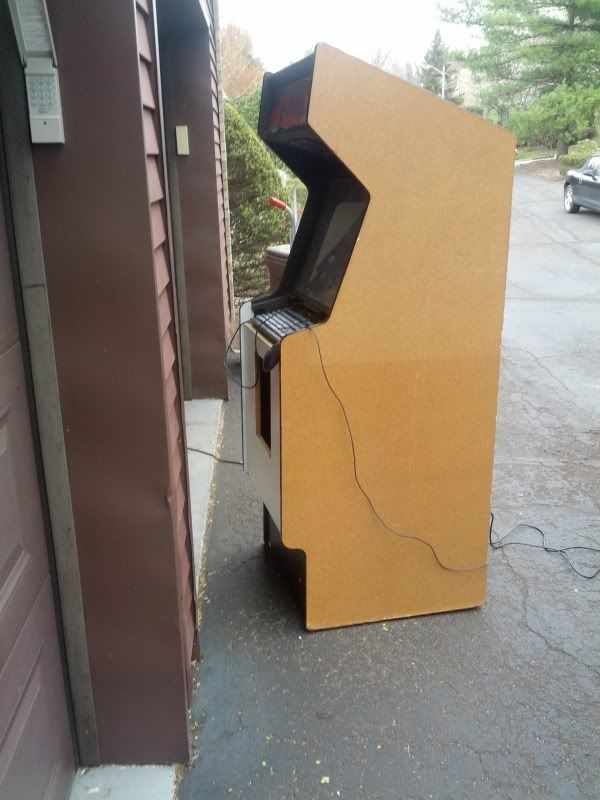

I removed the other side vinyl as well.
Sanded and prepped for primer
I am going to spray paint it with thick primer and try some flat black. see my results and decided whether or not to try vinyl or formica

if you know how to solder, just replace the cap in question. at least it will buy you some time until the rest pop. I've done tons of mobo and graphics card recapping over the years.

yes will do. i have tons of caps from donor boards lying around.  There's visibly one cap with a sharpie mark on it that is bumped up but not leaking. Either way I will address this with removal and replacement.

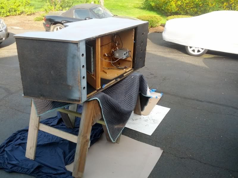

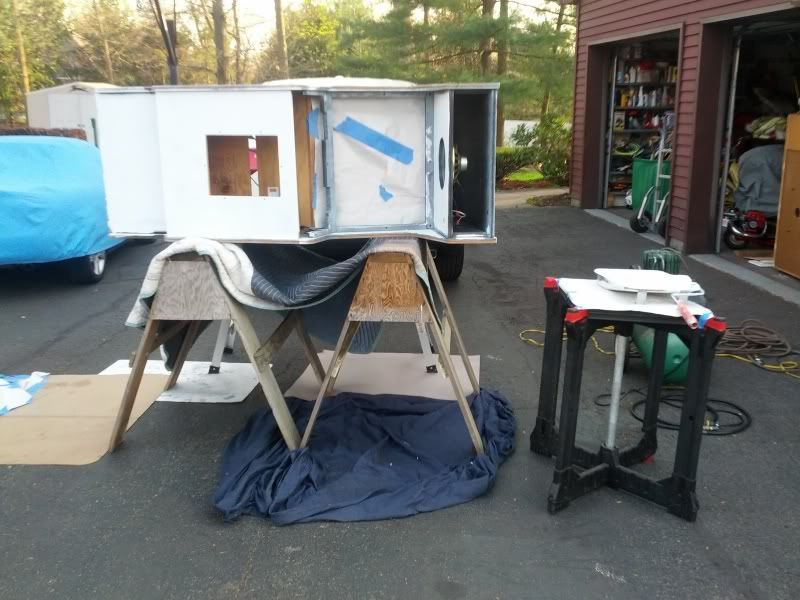

back from the airport and getting ready to roll my first time:

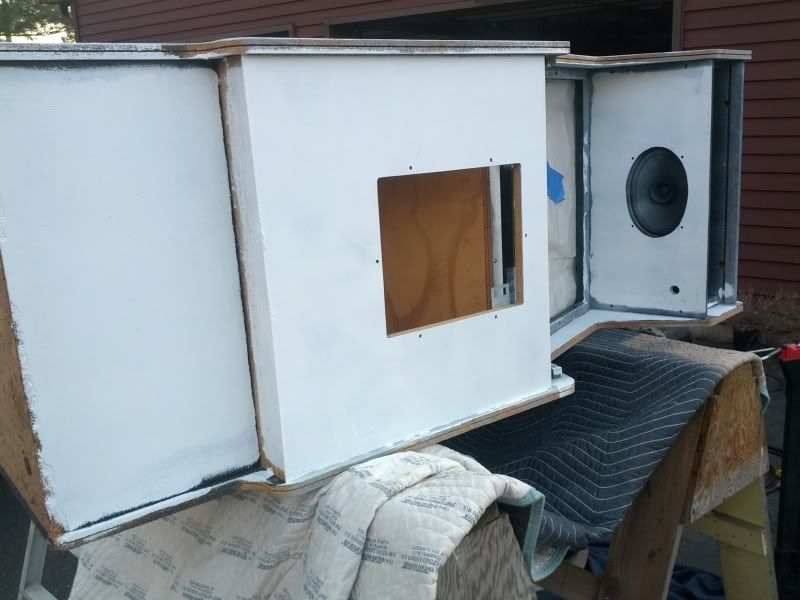

This is the stuff I bought. I hope this is the right type of primer to use, the homedepot paint specialist insisted for MDF to use this primer and go with this semi-gloss black.
Preprep pimer filler, and bondo applied and sanded:
Don't ask me how I got this thing on the saw horses by myself, i couldn't tell you.
OK i hope this is correct, i am going to go for the primer roller, with a 9" roller.  Hope it all goes well.

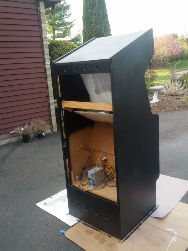

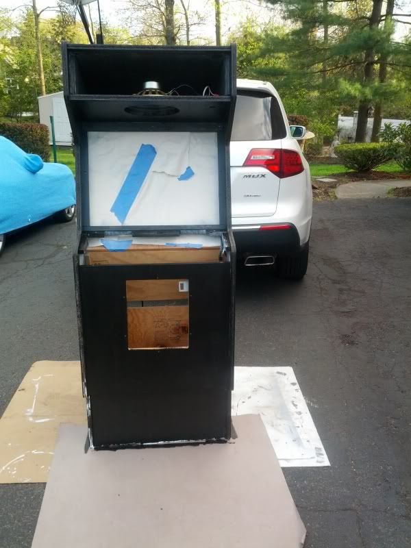

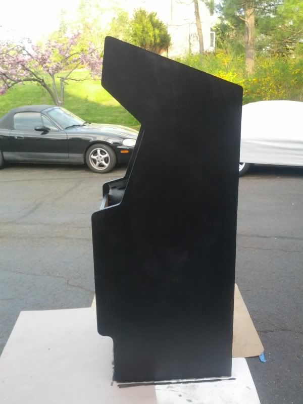

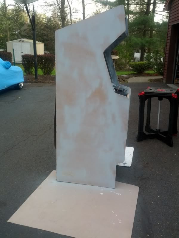

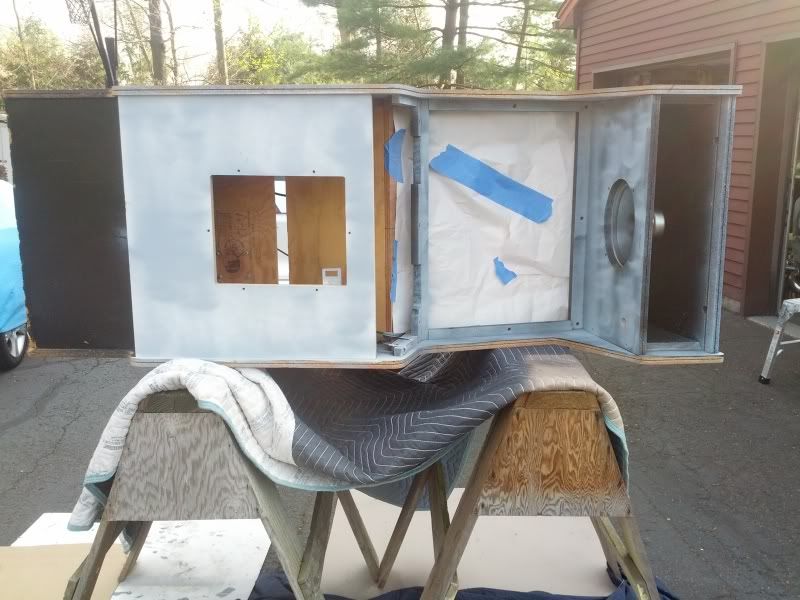

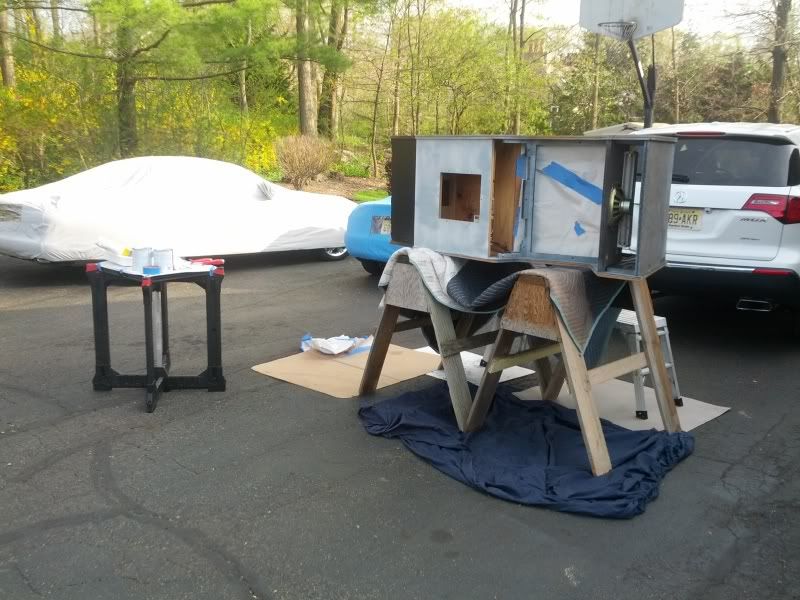

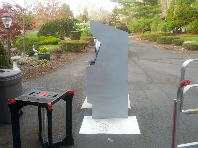

primed the whole thing yesterday:
Need to sand down with 400/320 grit and blow off the dust, apply the semi-gloss today
Mikeosoft
  • Posts: 46
  • Last login:May 17, 2026, 10:03:09 pm
Re: Gutted Sega/Gremlin Carnival cab destined for trash bin Mame build
« Reply #9 on: April 18, 2012, 01:00:04 am »

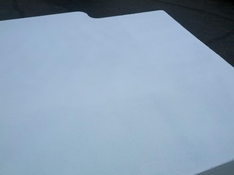

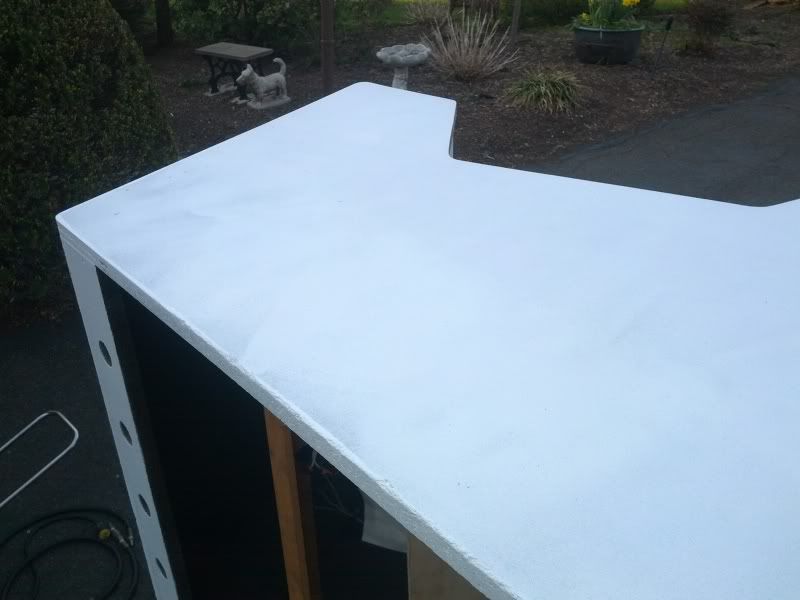

ok i sanded down the primer, and did a first coat of semi-gloss:
I can see the cross lines where the small roller moves and makes v shapes when i roll.  Also i am unsure of how hard i should be pressing with pressure.
Tomorrow i need to work, but if i get home early i will apply a second coat.

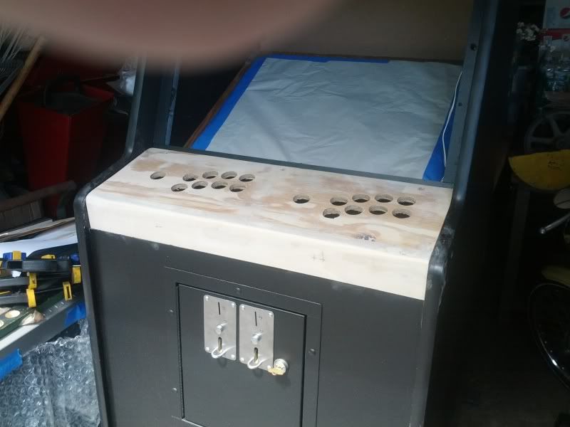

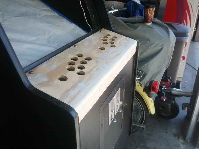

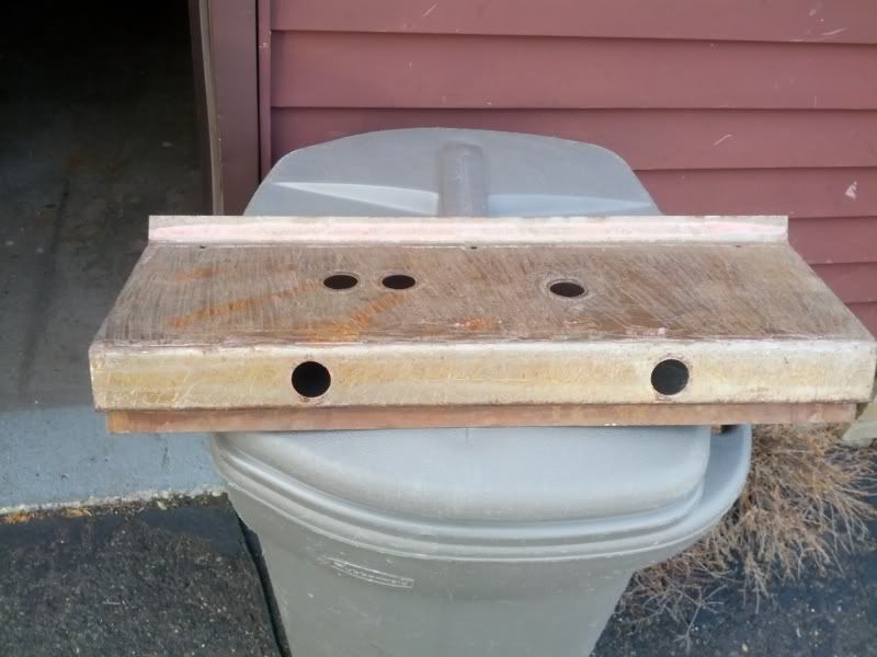

I found the Carnival metal Control Panel that went to the machine:
It needs to be cleaned and i have to remove the sticky stuff that is stuck to the metal.  Any ideas?
And began painting the coindoor:
Came out nice but i want to do a few more coats

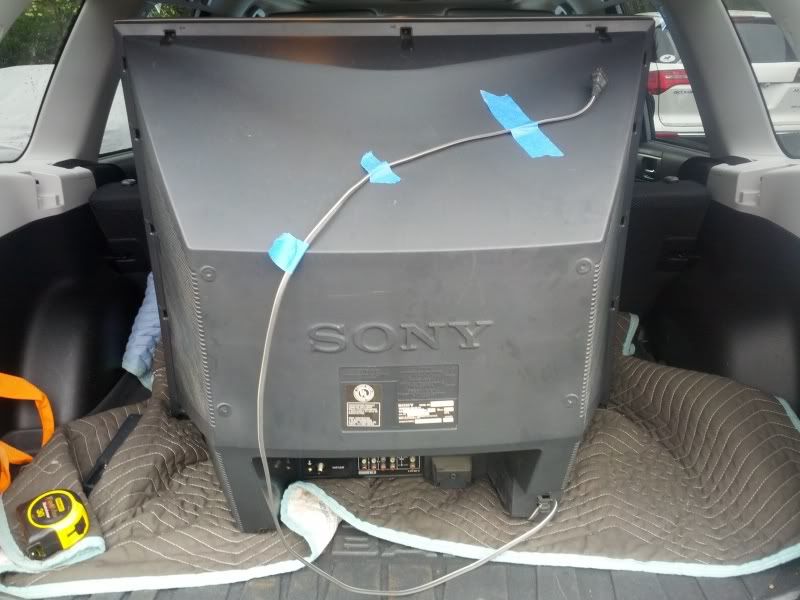

But something that was really getting to me about this machine was that small LCD.  At the angle it is at it is impossible to see the image without maxing out all the colors on the lcd and maxing out brightness.  I think this monitor is not the right monitor for me.
So... I started searching for TVs that make great arcade machine tubes, I came across some Sony Wega threads on this site and others where some people decase them and since they have 4 mounting holes on the sides, make excellent mounting tubes.  Also the flat tube screen is a win win, and the fact that 480p over component only sweetens the deal in my opinion.
So i went on craigslist and picked up 2 tv:

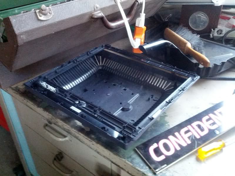

A sony wega 32 inch, which was waaaay too big but i might make a second cab from scratch to fit it, and this 24"
I need to decase this TV and also its probably important to discharge the monitor. I havent done a discharge of an arcade monitor in many years, and never a home tv before.  Anyone have any pointers?

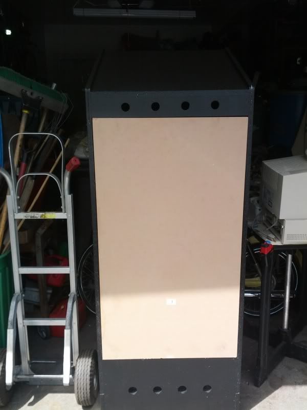

Finally, I got around to cutting a back panel for the cab:

A few things about the TV-
Are you sure it is 480p and not 480i?  I have de-cased 3 different TV's with component input and all turned out to be 480i.  I like 480i over component personally because of the scanlines.  I was amazed at how windows 7 handled my 480i tate/vertical TV natively without the ATI drivers or software in place.  Getting it to work in XP was a HUGE chore.  I picked up a crapy ATI Radeon1650 card and it drove a DVI to component dongle (monoprice) with various resolution dip switches perfectly.
I was freaked out when I did my first couple of discharges so I mage a huge PVC chicken stick, discharged it, waited 15 minutes, and discharged it again to be sure.

dude you are spot on, its 480i i am getting mixed up with al these special connectors (component, RGB, VGA) and resolution combinations, not to mention refresh rate syncs, etc.
It does 480i and i have the exact same tv.

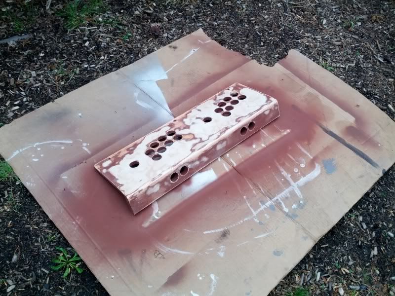

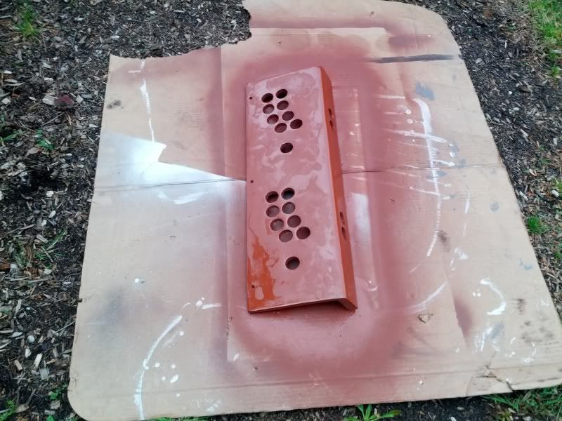

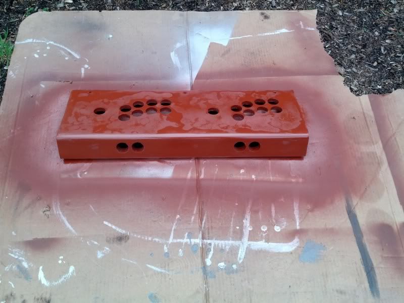

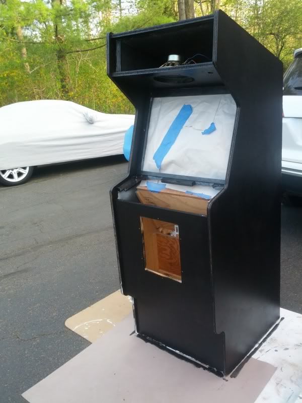

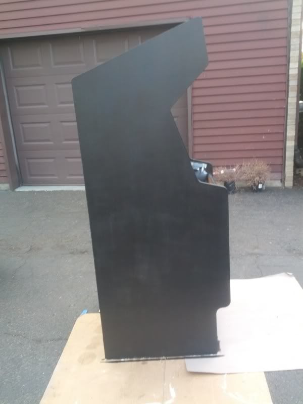

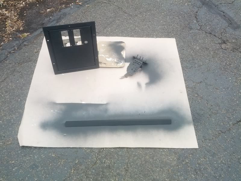

Yesterday I got to work cleaning up the metal parts and prepping for flat black paint.  I took the bolts, screws, coin door, and metal grill and scuffed up the metal after cleaning with a wire wheel.  I used scotch-bite and brillow pads to scratch up the surface enough to grip the primer and black paint.
The hope was to paint first thing in the morning however I was sidetracked this morning with recycling old pc parts at the town dump.

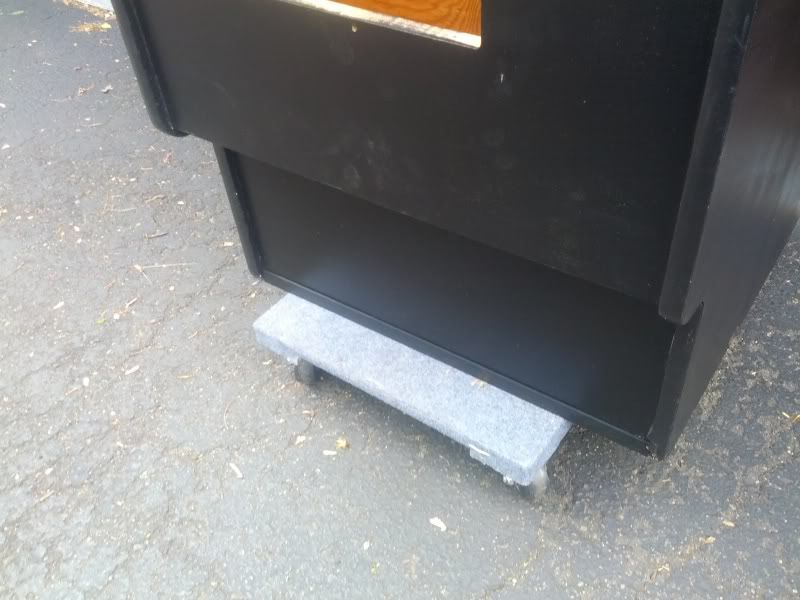

So when i got home around 11am I immediately got to work:

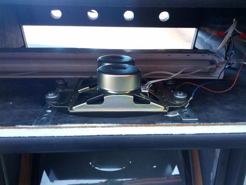

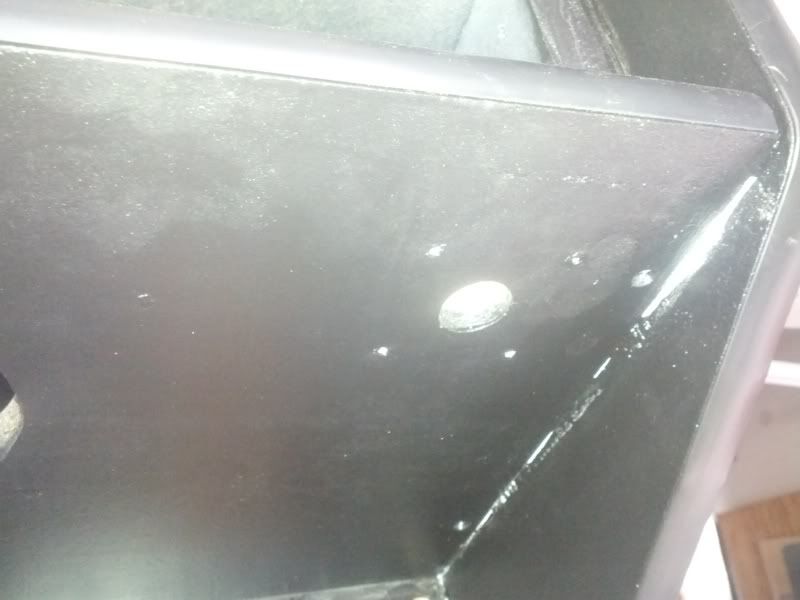

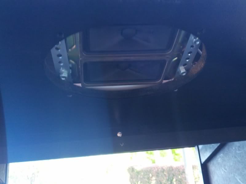

I noticed that the speaker panel/underside of the top panel was missing the screws that hold it to the machine, so I painted it like that.  I don't know how I missed that.  So i sourced some recessed wood screws to match flush.
I will need to touch up the missing paint where i thought the unit was seated correctly before painting.  Also I noticed this hole missing a mounting bracket:
Anyone know what used to go here? On/Off switch? What size? Either way the hole itself is 1 inch, if i need to I have located 4 small wood screws and painted flat black, and have one of these to plug the hole:

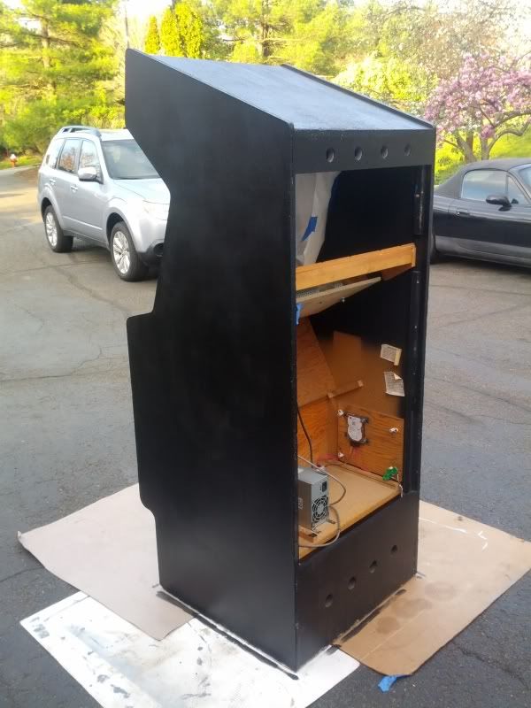

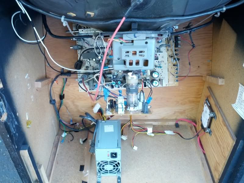

While I was painting that, it started getting cloudy so I know the rain would come soon. It's been raining on and off this whole week so no surprise, just sad.  I quickly got to work marking up the wiring harnesses with black sharpie to mark the direction just in case they weren't keyed and labling the parts from A to H

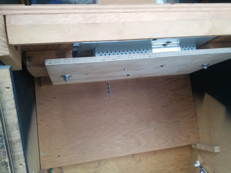

I was able to remove the yoke from the crt as well as disconnect all the wiring, isolating the tube from the other electronics.
I am getting closer to mounting this tube into the machine.  I need to figure out what angle to mount it.  I think the current mounting is too low and at too much of an angle.  I think with this size of a monitor it's important to mount it almost vertically.  I figure i can work my way up, until I am satisfied with the angle of the monitor.  Anything I should be aware of as far as angle glare in the glass reflections etc?

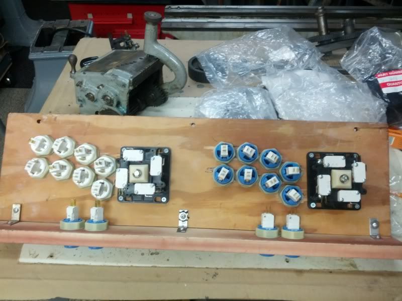

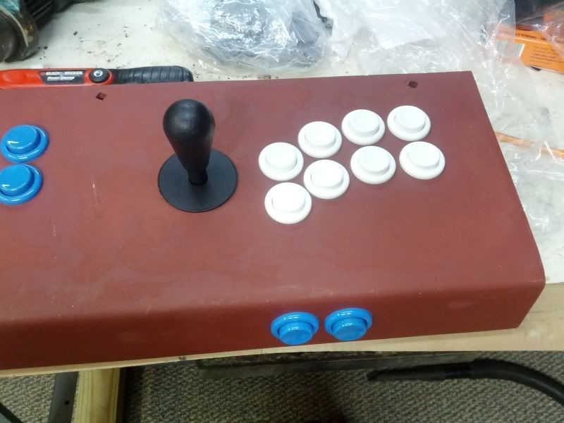

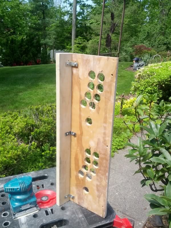

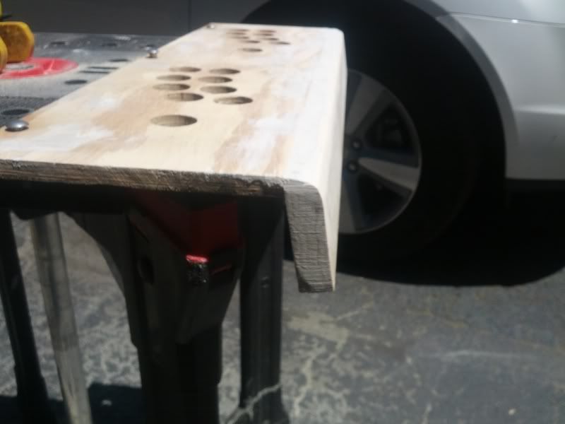

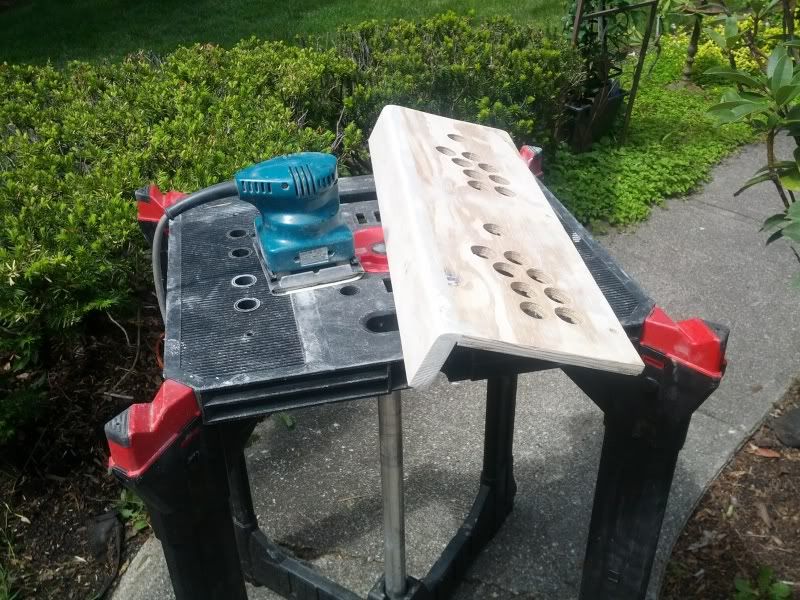

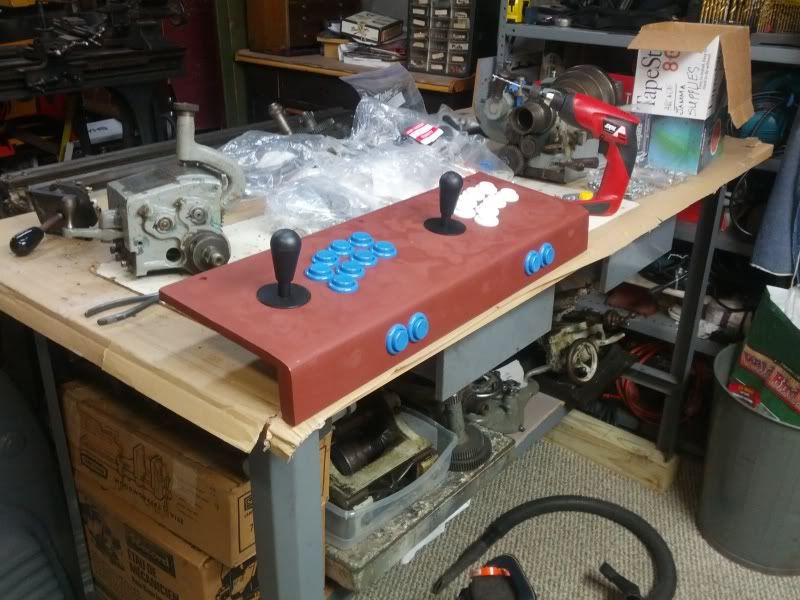

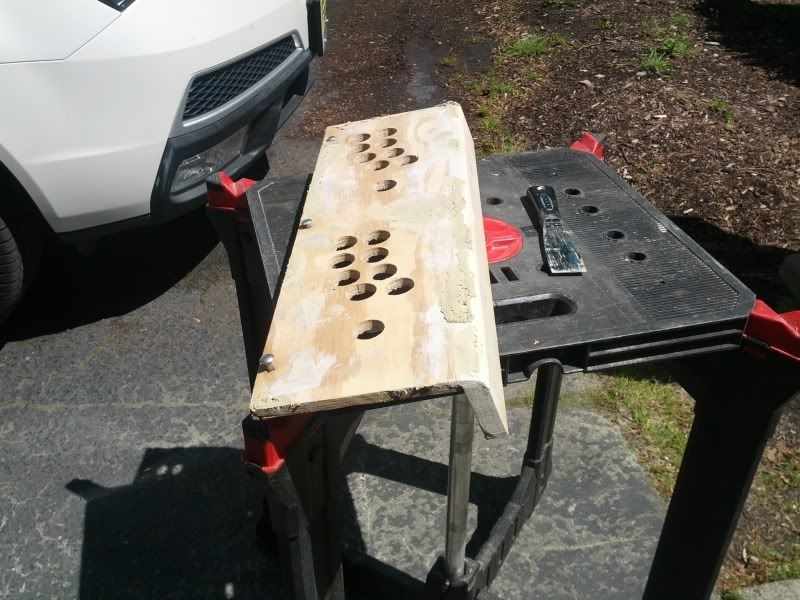

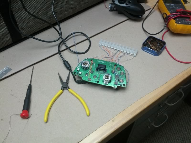

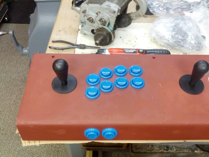

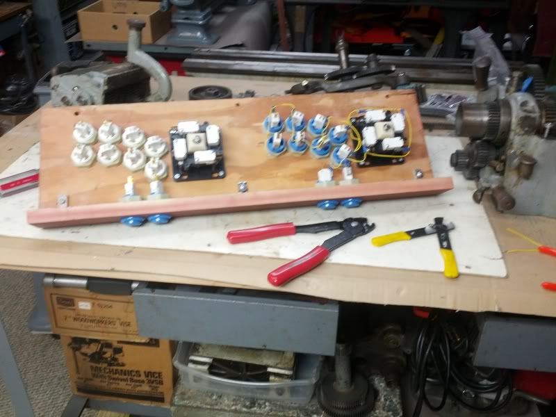

The next big obstacle on the horizon with this cab is the control panel.  I have realized the placement of the already cut stock button holes do not correspond well to a 6 button street fighter/4 button neo geo layout.  This means I will either have to tackweld on some metal and fill the height differences and hope i can cut thru it, or scratch going with the original metal cp and build a new one out of thin plywood.
I took some measurements and will try working with google sketch-up although I have never used it before.
I have

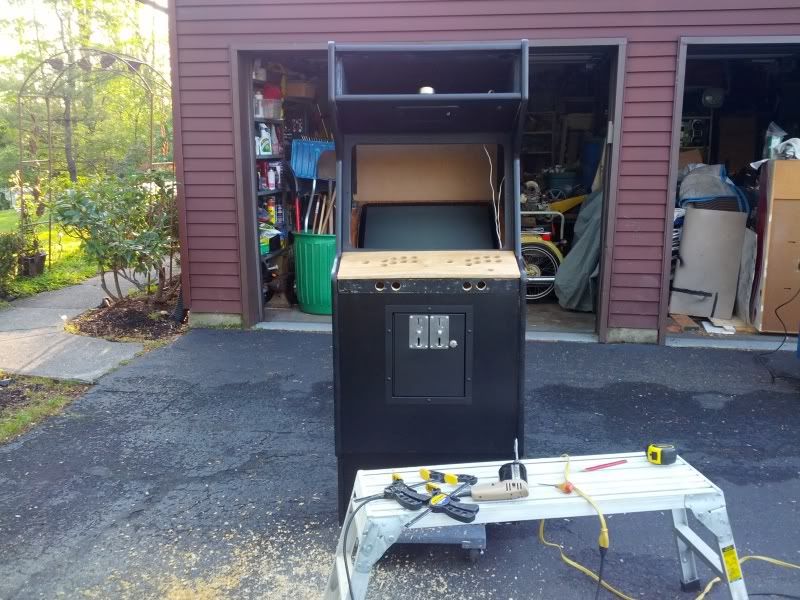

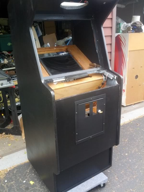

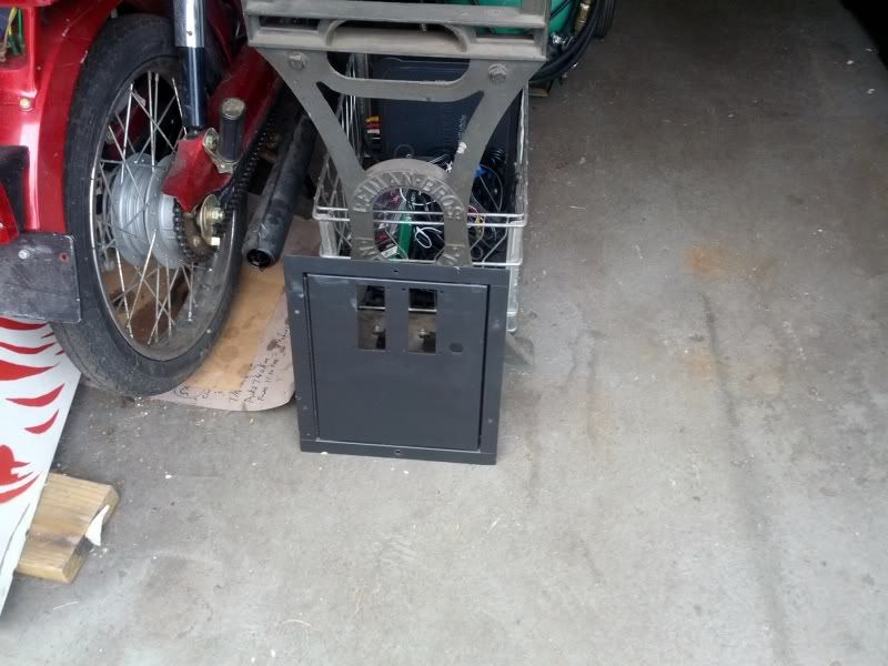

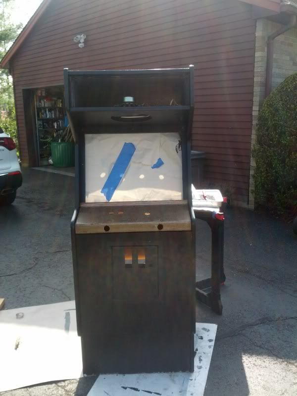

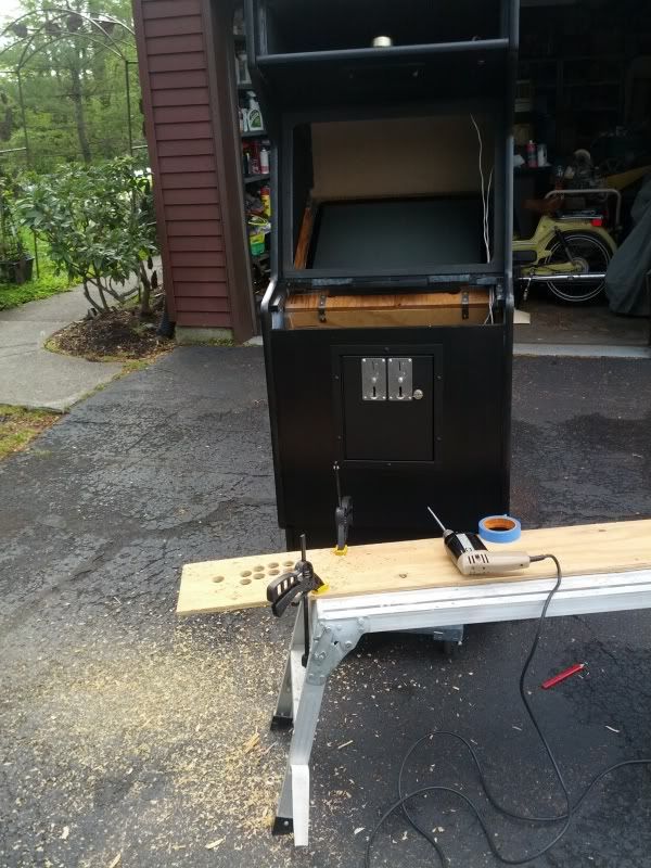

Today I did some more small things to the machine.

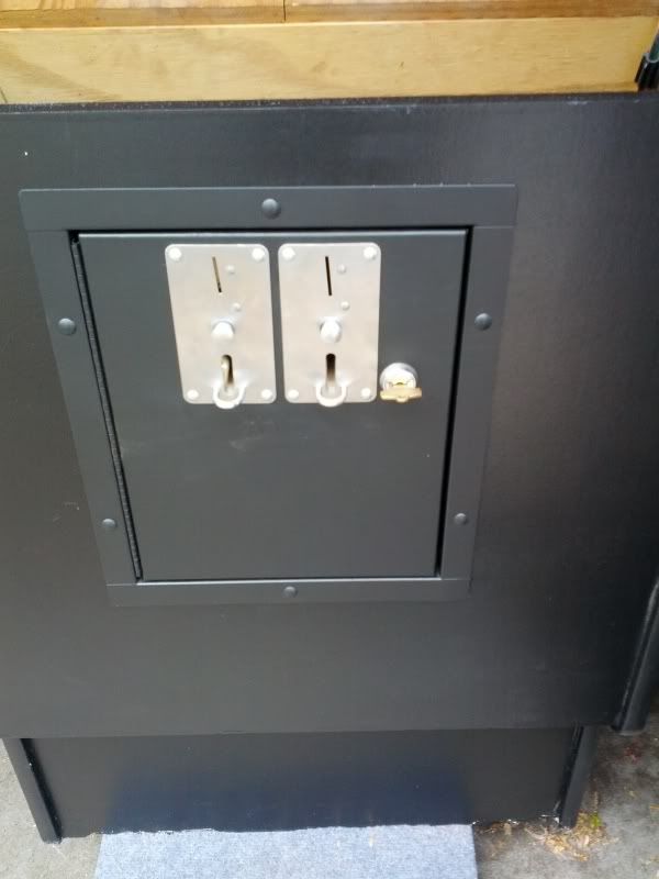

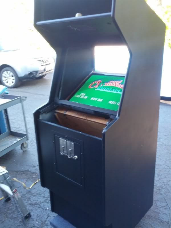

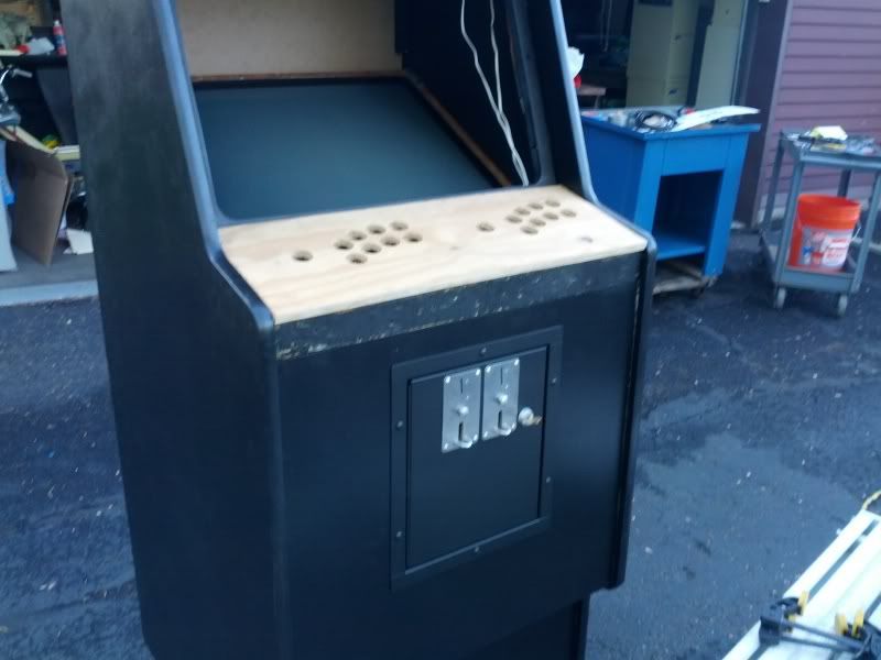

I installed the coin door:
While I was installing the coin door I grabbed a lock mech from my dad's pinball parts bin stash, and I think it's a nice touch.

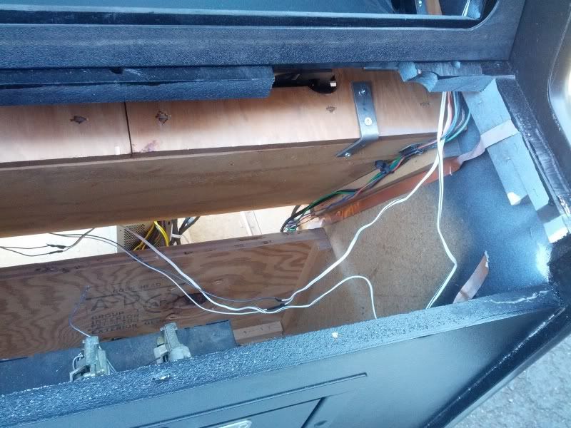

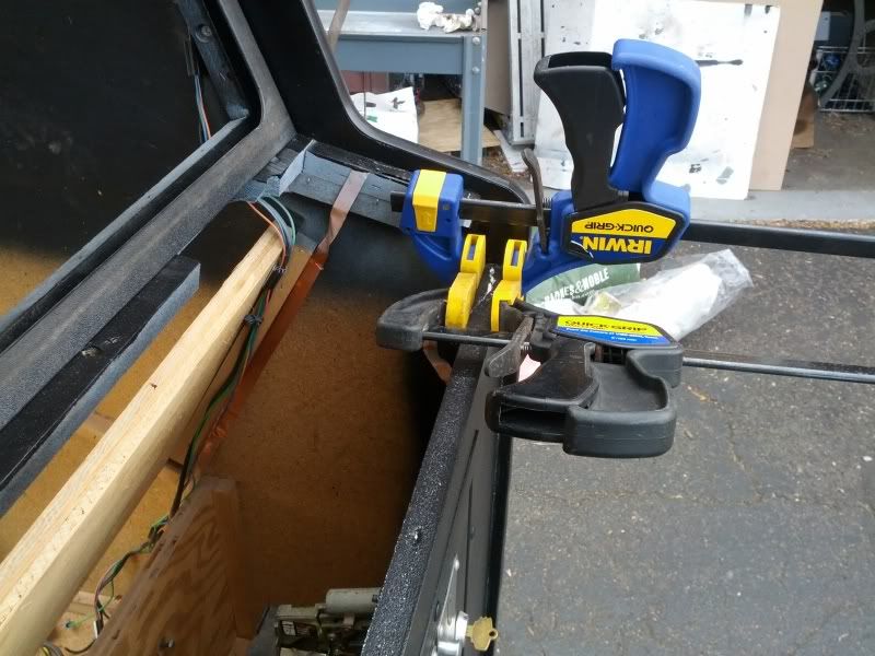

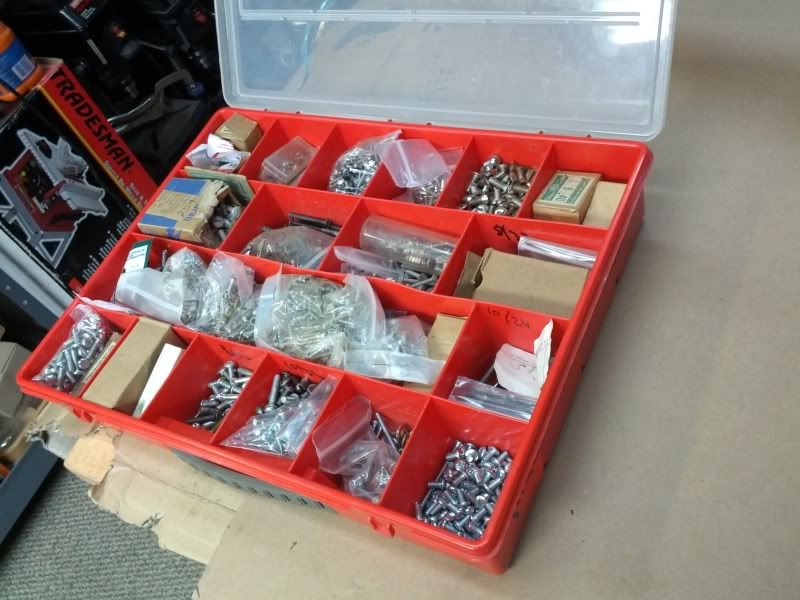

I also installed the top screws and re-enforced the underpanel for the marquee.  Now it sits correctly and there is some paint touchup work I need to do.

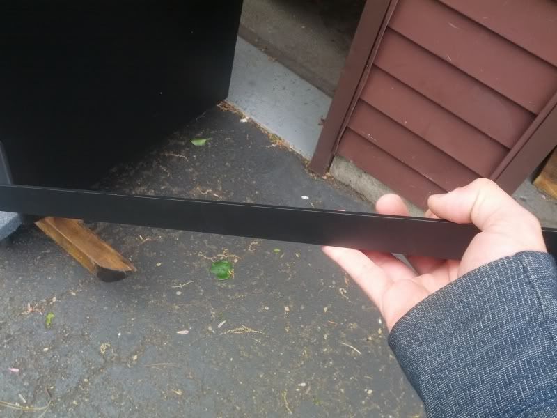

Also I installed the speical piece of metal angle brace I bought from Home Depot and painted black:
It will hide the kicked up rough bottom edge without looking "OCC bling Trashy" as my buddy called it by using diamond kick-plate...
I think it looks good.

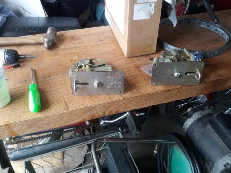

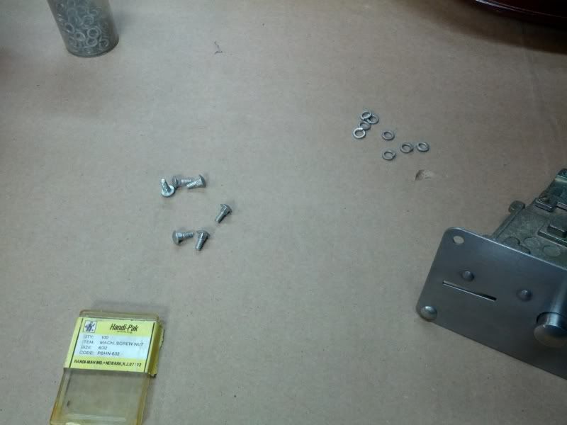

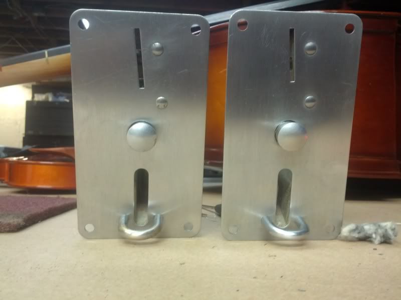

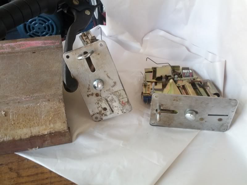

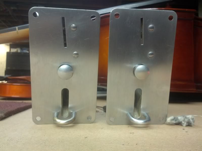

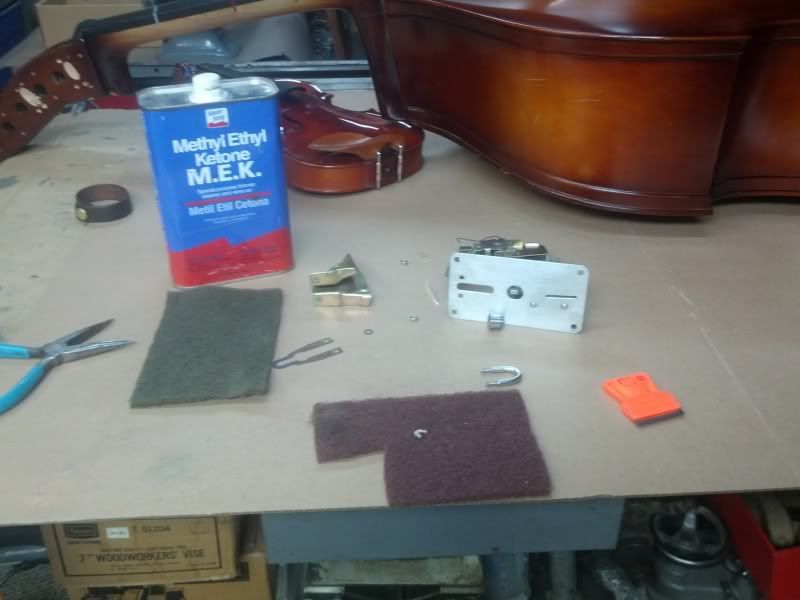

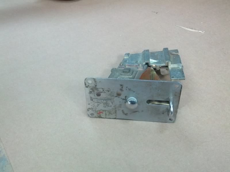

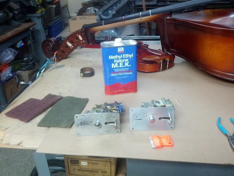

Now to attack those pesky ugly dirt ridden coin acceptors...

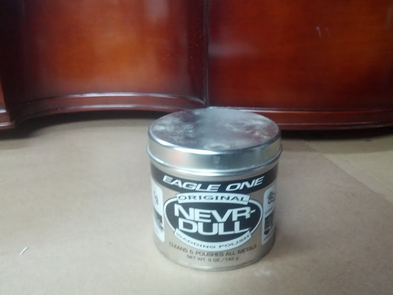

As I received them:
I figured they were shot, and to look online for new units.  I couldn't source an exact replacement, although i found something close for 120 dollars us per unit.  No thanks! Ebay has some cheap chinese replacements that look like they will fit but are advertised as made for Pachinko machines... 10 a piece plus 10 shipping. 30 usd for a cheap but new look.  Hmm maybe.
But I figured what the heck to try and waste an hour or so and refurbish these suckers if there's any bit of life left in them.
The tools:
Some MEK, a needle-nose pliers to remove the coin eject button and nuts on the back, 2 types of scotchbrite (big and small), and a razor blade to clean off old dried tape and residue.  I also used a rag to apply and rub the MEK to clean the surface.
First one is done, here's a comparison!
Both completed:
As a final step I rubbed some of this stuff on there to prevent rust and damage to the remaining chrome finish...
All in all I am very happy with how they came out.  I am missing some parts with one of them, but this isn't a big deal.  I think I will try and restore them both to working order.  This depends if i want to wire the machine to Jamma spec or not. Still a decision up in the air.

Today was long and big.  :afro:
In an effort to finish up the coin acceptors, I asked the old man (my dad) if he had some nice rivets, or lockbolts small enough to use to mount the coin mechs to the coin door.  He said "of course"
Here's them installed:
I am very pleased with how it turned out!
While i was doing that I noticed there was a split in the front particle board,  which meant it was time to pull out the wood glue!
Now it was time to finally tackle the damn mounting of the sony wega tv into the cab...
Took tons of measurements.
Turns out I couldn't have picked a better monitor to use because the clearance of the neck board is within 2 centimeters from the back door...
See pics below.
I used the mount from the old tv since after measuring the cabinet, it is not perfectly square.  This made me feel a tad bit uncomfortable because this is a decision that will be the first time I change something on this cabinet that is irreversible.  But after thinking it through I said it was for the best and went with for it.
Grabbed the measurements, checked 3 times, and spaced everything best I could.  I thought about changing the angle that the tv sits, but quickly realized if I tilted the monutor more "vertically" the neckboard would petrude thru the back.  My dad said i could cut a hole in the back door and use a siding piece at homedepot, he'd seen it done before... I was seriously thinking of trying that for a moment.  But then I realized there was probably a reason the monitor was built to sit recessed and tilted somewhat flatter like it does in the final pictures. So i went with it.  It worked for the best...
I cut out the frame to fit the tv, and I had to sand a bit more for a snug fit with a rasp. But it came out great.  To reinforce the weight of the tv my dad suggested to use some angle brackets as reverse washers, in other words we would take a long countersunk bolt, put it down through an angle bracket and through the wood and into the metal edge of the frame of the tube.  Behind that would be a lockwasher and a nut.  2 of these each for each of the four corners.  Since the Sony tv already had 3 holes in the vorner brackets I used the spacing and just went through it with a 3/16 drill bit to give a bit more clearance.  I am very pleased with the results.
More to come tomorrow.  First turn on and everything tomorrow.  I have reconnected everything but the tv speakers which will be done tomorrow afternoon.  I will post a video up when i test everything out.
  • Posts: 2021
  • Last login:Yesterday at 05:30:39 pm
« Reply #19 on: April 29, 2012, 04:45:48 pm »
That TV looks great in there!  :cheers:

Here's a vid of the first time I powered it on today:
Today I checked all the wires and made sure everything was connected correctly.  I soldered in the speakers from the tv right inside the top of the marquee, built a bracket to hold the two speakers as one where the single speaker would sit above the player's head in the marquee area.  I need to source a bigger speaker grill cover since the one I thought was original doesn't cover the hole completely. I will measure out the ellipse tomorrow and find the proper grill online and order it.
Tomorrow I need to wire back up the POS dell and hope it will boot up.  Also I need to seriously sit down and figure out which path I am going to take with regards to control panel options.  I think I might still try and use the Original Control Panel, since it is a nice piece of steel and has the right dimensions and angles to work nicely.  I just wish it wasn't cut with button holes that predate "common control layouts" like a joystick, which this machine didn't have...

Yesterday adter the morning rain subsided I got to work on the control panel.
I prototyped two nights before on a piece of cardboard with an 8 button layout.  This one:
Man Slagcoin rocks!
Whe ni was happy with the cardboard layout I dropped it on top of the metal control panel just to see where the buttons would line up.  They were not directly over the existing holes but would come into them. Infact, on player 1 button 2,3 and 6, 7, theexisting holes would make a big open hole between the buttons.  Now I have a MIG welder, and I have used it before, but I am horrible at it and get splatter everywhere.  Also even if I cut small squares of metal to tack weld over existing holes I would have to bondo in the holes, then cut into them again to make the controllers fit.  It would not be pretty.  Finally, doing this method would mean al the work I did thus far with keeping the machine "restorable" to a carnival machine would be for nothing as the control panel would be ruined.
So the second option was to try to build a new Control Panel out of wood:
These long cuts were made by me with a steady hand and a zip saw.  I went slow and got lucky.  I have little to no experience with wood working and the next thing I will do from now on is create a sawboard to help me cut straight lines.  Although I am very pleased with the work I did, I seek perfection.
Now the block of wood under the ply was a piece of scrap wood I found in our wood pile that just so happens was cut to the perfect length.  It also is the perfect height. 3 mm of clearance between the ply and the block.
Here's my plan:
Cut a "round over" in the ply edge with my old man's router.
Grab a nice piece of plexiglass and cut it to fit the top.  Leave the bottom longer.  Use a heatgun to heat the edge and bend it under and over the lip of the rounded edge.  Cut a short flat piece of plexi to fit in between the 3mm if there's still open room.
Get some LED strips from IKEA or ebay, with mood lights or something, and wire them in to glow from the underside of the control panel....
I hope this is making sense...
More pics:
« Reply #22 on: May 02, 2012, 12:43:14 pm »
Are you not going to use the metal control panel?
Mikeosoft
  • Posts: 46
« Reply #23 on: May 02, 2012, 02:23:09 pm »
using the original control panel will be more trouble than making a new one. I think that's the biggest reason.  Second, I don't want to cut apart the original panel thus making the possibility of one day restoring the game impossible.
If I could get a new control panel cut and bent with metal I would chose that option but I have no access to metal fabrication facility, and I do not know anyone who would be willing to help.
Do you think this is a bad idea?
« Reply #24 on: May 02, 2012, 02:36:03 pm »
No, not at all! You ended up doing what I did.
I DO have access to a metal cutter, so I'm going to try and make metal CPs. But wood works just fine.

In the meantime I have sourced 2 controllers and am in the process of wiring the second one up.  I am going to run this cab with an xbox running coinops for now, until I get a decent usb multi-console/pc/360 usb controller unit I can wire up and call it a day.
So for now I broke open some old xbox 1 controller S's I had from my younger days.

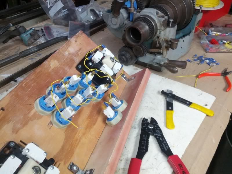

I spent the weekend working on the control panel some more.  I bondo'ed some more, sanded extensively. I repeated. I painted some primer thinking i was done, only to find once it was all 1 color that there were tons of imperfections.
All in all i finished with 2 coats of primer, and had some buttons sitting around so I tried them out.  I will probably order some better colored buttons once I have design set, but for now I am very happy.
What you see in brown is the primer. I am going to spray it flat black once the rain stops, and then cover with a control panel vinyl like
 this:
Does anyone know where I can pick one of those up?
Also I need to get some input and advice on sideart and control panel art. Marquee as well.
I've been playing around in illustrator a bit today but i am completely new to vector stuff and digital stuff.

had a garage sale this past weekend, and moved a ton of stuff out of the garage.  I should now have the room I need to get working on this cab the right way. Not to mention more funds to throw into this.  Although, I have to admit I haven't spent much so far.
In the meantime I managed to work a little more on art designs for this machine, and I need some input on what's the best:
