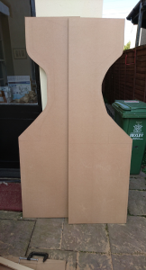

« Reply #446 on: January 23, 2016, 03:44:59 am »
I notice people have used Black primer on most these threads, but I'm struggling to find in anything but spray can... Did you all use spray cans or do I just need to search harder??

Primer - just google/search on priming mdf (or whatever you're using). most people don't use black primer. If you're going for a dark topcoat, use grey. If light, white. I used a spray gun, but you could use a foam roller. Depending on how precise you want to be - some sand between coats for a mirror finish (e.g. OND often gets the finish of a Steinberg, whereas mine, on the other hand, is that of a teenager's face).

vaderag
  • Posts: 363
  • Last login:May 07, 2025, 11:33:07 am
  • Building my own cab :)
Re: Build an OND designed cab 'Metropolis'
« Reply #458 on: February 25, 2016, 12:25:33 pm »
Sorry, I have another question... I may have missed this in the instructions, but how is the cp held in place? I see 3 bolts at the back, but surely something is needed to hold it on to the main body at the bottom as well?
Also, how is maintenance performed on the cp? Is that done from the bottom? If so, how is it affixed? Rescrewing into mdf isn't good I hear, so that doesn't sound like a good idea!
  • Posts: 9794
  • Last login:Yesterday at 03:29:57 pm
« Reply #459 on: February 25, 2016, 08:46:48 pm »
« Reply #460 on: February 26, 2016, 03:48:15 am »
Threaded inserts are your friend.
http://newwiki.arcadecontrols.com/index.php?title=FAQ#Hardware
Awesome, thanks!
So are people screwing the bottom on and fixing the top? It seems the design with the rounded corners doesnt really work with the top opening as it'll be covered in vinyl...
Also, how it is being attached to the actual body - i see the three bolts at the back, but is it screwed into the flat pieces sticking out as well? If so, then surely it has to be top maintainence else there is no way to screw that?
Edit: just to be clear...
On the above image i've tried to very roughly draw the wireframe. There are three bolts at the back, but how is it held onto the straights marked with an arrow? Surely leaving it floating will mean it'll feel loose under strenuous play?
« Last Edit: February 26, 2016, 03:53:14 am by vaderag »
« Reply #461 on: February 26, 2016, 04:33:01 am »
Not sure about that -- haven't looked closely at the Metropolis CP design.   :dunno
I was just commenting on how to avoid pulping the MDF when removing/re-inserting screws.
« Reply #462 on: February 26, 2016, 12:11:00 pm »
Couldnt you just put small battons along inside of side panels under cp unit and screw/bolt down into those?
« Reply #464 on: February 26, 2016, 12:46:42 pm »
Good shout - bolt into the bottom through a baton on each side...
I'd need to do something weird tho if i want it to be bottom access for maintainence too (which it needs to be due to the vinyl...)

« Reply #478 on: April 02, 2016, 02:39:14 pm »
Finally got a nice day with no rain forecast so managed to get some woodwork done today!
It wasn't a full day unfortunately as I had a fence to fix from some recent storms, but the woodwork is underway :)
Got all of the rough cuts done so essentially at a good base point where I don't have to lug around 8x4's any more, and the best thing is, it's starting to look like an arcade cabinet :)
Oh, and i discovered that my new favorite tool is a jigsaw!! So much fun to use!
Biggest lesson from today... circular saw blades are thicker and more destructive than you think... leave more space from your lines than you think!!
Question: Any reason not to use a Jigsaw for the inner curves, rather than freehand routing them?
