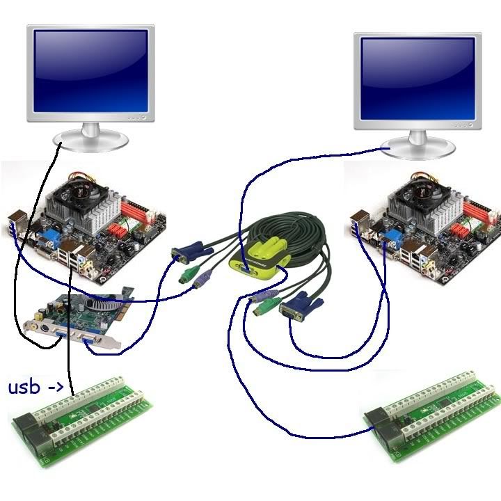

The build will be something like this.
Lines are 100 percent correct in this image- but provides the idea.
I need to sketch up the plans which I am working on tonight- but anyone have any ideas for a name/theme? I want to try and do something original for these this time around.

 I don't see the KB port on the KVM switch being used.  The KVM switches that kb port to either KB 1 or KB 2 connectors.  All I can see is your IPAC connecting to the 2 kb output connectors.   Maybe I don't understand what your overall connections are supposed to accomplish.

@Bob - I realized after I had uploaded that pic that I didn't really draw the connecting lines very well and make it clear- so hopefully this is a better representation of what I am thinking. Keep in mind these are just stock images.
Bartop # 1
-Monitor directly into VGA slot 1
-Player 1 controls connected via USB (ipac or something similar)
-Secondary monitor into VGA slot 2 - routed to KVM switch
-Player 2 controls connected via PS/2 via KVM switch
The second bartop would be similar to the first expect monitor/controls would all be routed through KVM and depending what is selected on the switch it will either show/control the PC inside of bartop 2
or show Bartop #1 display/control Player 2 for bartop #1 - which will be controlled via push button of some kind selecting the scroll lock button.

Ok looks better now.  The KVM moves the ipac ps/2 and monitor 2 from computer 1 to computer 2.   Already on computer 1 are a usb connected ipac and monitor 1.    Now the only thing in limbo is the exact function of the PB that you want to use to switch the mode of the displays.

If whatever KVM switch I use is similar to the cheapy I have now in my home server room- I should be able to route a normal arcade button to the ipac that is programmed for "Scroll Lock"- it should switch displays and player controls back and forth between the 2 machines. Allowing bartop 2 to either have controls monitor on its dedicated machine or the display of bartop # 1 and player 2 controls.
The only thing that will be a little bit of a pain is for Bartop #2 I will need to wire all controls for player #2 keys- and switch the control settings on the mame installation on that arcade around so it will recognize player 2 buttons as 1 on the dedicated machine and then player 2 buttons when it switches over for multilayer.

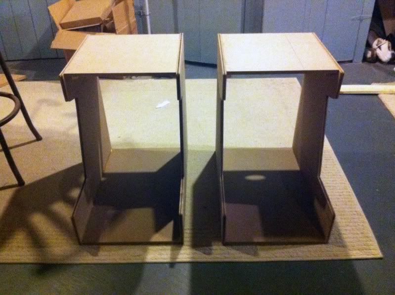

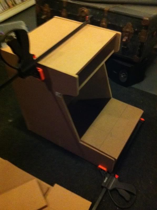

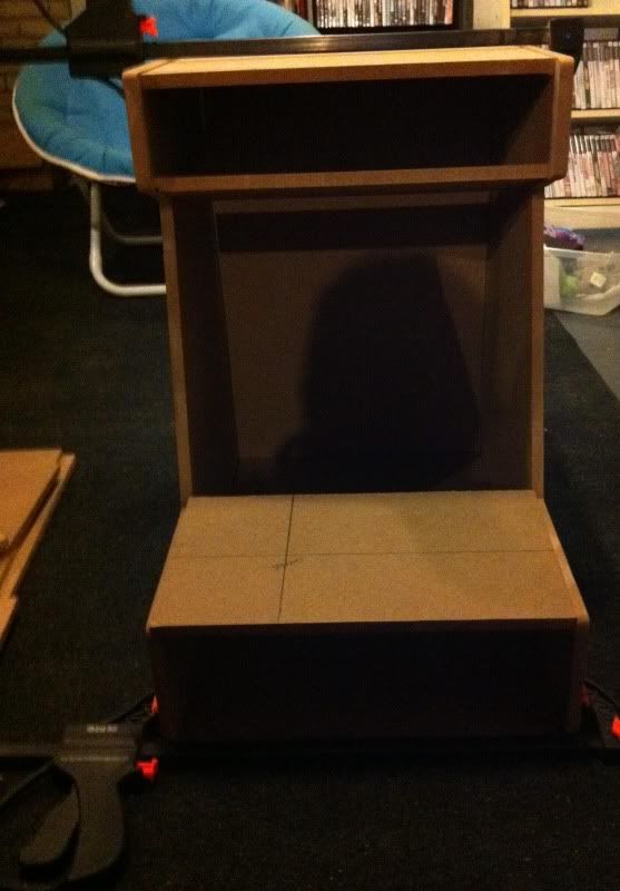

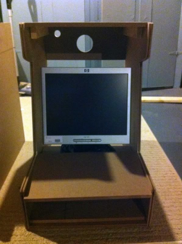

Started cutting out all the pieces today and made some pretty good progress. I've got some more cutting to do and routing/sanding but I should be able to finish that up hopefully tomorrow or Thursday.

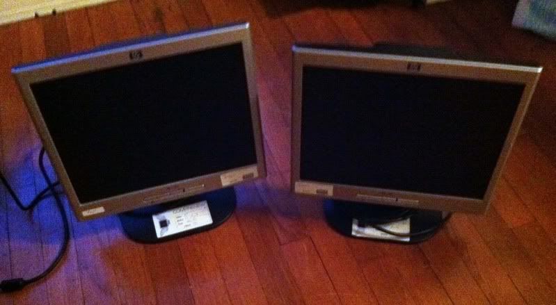

I also stopped by my local electronics/computer thrift store and picked up a couple of monitors $20 each.
I need to still figure out what computers I will be throwing in these. I was thinking about ordering some foxconn boards w/ P4 3.2 from here. Anyone have any thoughts on these? I am looking to try and support a large variety of games/fighters at good speed.

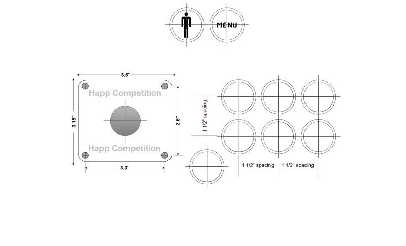

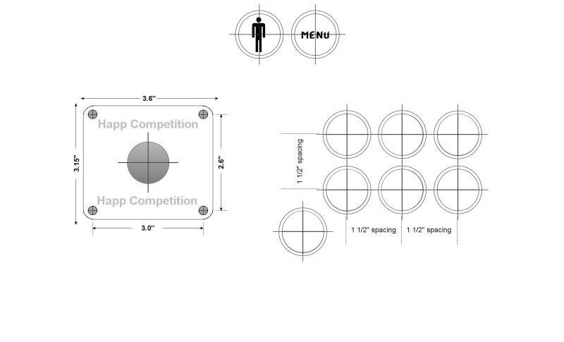

I also need to start planning out the visuals more and could really use some help. I did a quick color mockup using the capcom logo colors for one of them. Anyone have any thoughts/suggestions?
« Last Edit: January 23, 2012, 11:07:27 pm by kb84 »

« Reply #29 on: January 18, 2012, 08:02:02 pm »
I got the rest of the pieces cut today for both units- I just have to do some sanding and drill the holes out for speakers/fan vents/etc. I can say as this is my 2nd build (well 2nd and 3rd builds if you count 2 at the same time) I can say from a woodworking newbie stand point that it definitely gets easier with practice. Also building a saw guide/jig can do wonders for how everything fits.
I did a quick mock up of one of them with clamps- its coming together nicely.

I think that you don't need 2 VGA cards/interfaces...
How about a VGA splitter: 1 input 2 outputs (same images on 2 screens).
The second (slave or dumb) bartop would have the VGA monitor, the CP, an USB encoder, a sound amplifier. The second bartop would have to be pluged on the 127v mains outlet to provide power to the VGA monitor, sound amplifier and a litte power supply to the USB encoder.
The cable between 2 bartops would have the VGA cable, USB cable and audio cable. This cable could be created using a special cable (I don't remember how many signals the VGA have, but audio is 3 and USB is 4 wires) or you can simply enclose the 3 separated cables into a hose like cable...
I think he wants both machines to be stand-alone bartops (i.e. playing completely different games at the same time), but with the option to connect to each other for two-player games with separate screens displaying the same info.  In that latter scenario, the switch will bypass the 2nd bartops VGA and grab the signal from the master's card.
Understood... GREAT IDEA!!! Maybe a custom circuit design using 4066 ICs (quad bilateral switches)...

Quick update- All pieces cut/routed for t-molding and I have started assembling the 2 cabinets. I also drilled out the back power button/fan holes. There is an extra hole on one of them for the toggle button for the KVM switch.
I also have mocked up what I think the control panel layout will be. 7 button simple layout with Player/Menu button at the top. The coin button will be below the control panel.

Grats on the woodworking, looks like you made some big progress.
One question though, are these going to be verts?  Seems like alot of vertical real estate looking in from the front.
Also, why not space out that joystick an inch or two more from the buttons.  Appear to have plenty of room and don't wanna feel cramped.

« Reply #38 on: January 23, 2012, 03:12:43 pm »
Yeah- I designed the cabinets so I could convert them to verticals if I ever decided I needed a switch- better to have options than to not. However with the monitor placed in horizontally there isn't to much wasted space and I don't feel it looks small/awkward. About 3 inches from the top/bottom to the display screen
I agree on the CP layout and I spaced it out a bit more- I'll need to test it out on some cardboard and see how it all feels.

« Reply #39 on: January 23, 2012, 03:20:03 pm »
Since you're still in the planning stages of the CP layout, a suggestion, if I may. Try rotating the button layout counter clockwise to better match the angle your arm rests on the CP while playing. It can be a little uncomfortable with a straight-on button layout like that.
