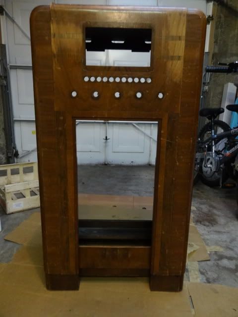

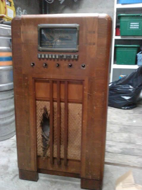

As you can possible see it's a bit rough and in the top left hand front corner there is a bit of damage caused I think by shipping. Thanks UPS  ::)

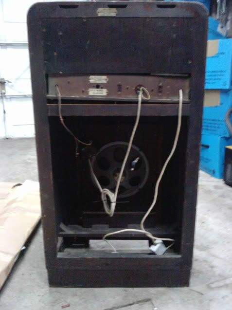

So I've stripped it all out..............eventually. As you might see in the back view the whole inside working has either moved in transit or not been put back together properly after a previous owner had some work done. I assume they've had work done unless Taiwan was making components for Ferguson in 1938?  ;D
But now I'm starting to think it's maybe a shame to cannibalise a bit of history just for my own selfish needs  :-\  I did think that i could get an 8 inch touchscreen in the hole created by the dial though.  But them what to do with the row of 11 small holes and 5 big holes underneath?

Think I'm going to go down the 'restore the woodwork as much as possible and juke it but keep it looking as original as possible' route  ;)

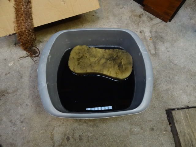

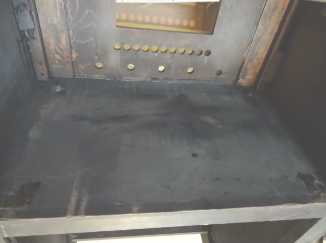

Started cleaning it last night. Man this thing is filthy inside and stinks!!! This is after a couple of washes with hot water and washing up liquid.
Second bucket of water...
I've seriously thought about taking a small pressure washer to the inside to see if that will clean it properly but I'm frightened it might ruin it  :-\

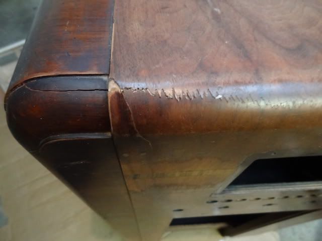

Close-up of the damage caused by dropping it en-route...

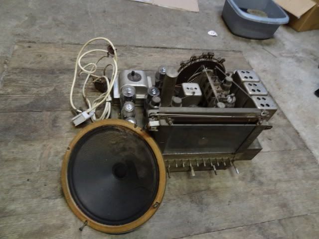

Plenty of room for the old screen-less laptop I have in mind and for the Microsoft 2.1 Speaker System that I also have.
I like the idea of covering the holes with some kind of car related chrome work but living in the UK may seriously limit my chances of finding something suitable at the right price. So another idea is to somehow mount all the original buttons on a frame/bit of wood and just have them as decoration? I'm missing one big knob (ooer missus) so I'm could leave the middle hole empty and install a button to start/shut down the computer in there instead.

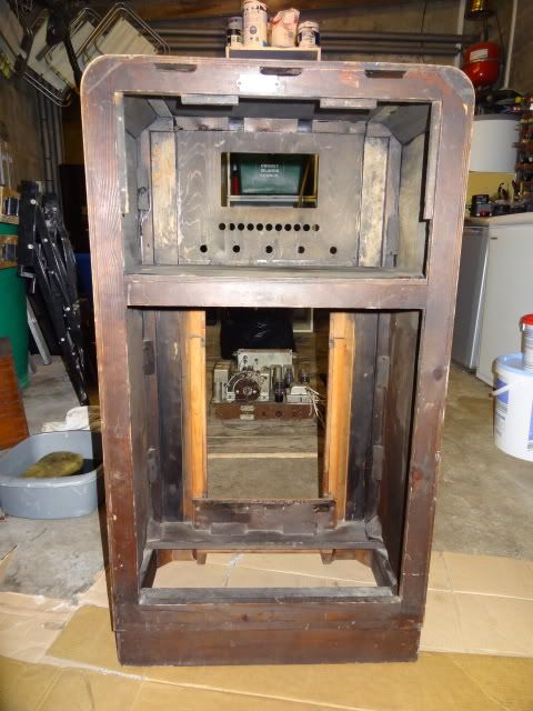

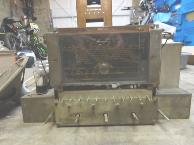

For anyone who's interested here's a pic of the whole workings. Undid 4 wood screws and with a little gentle persuasion it slid out.

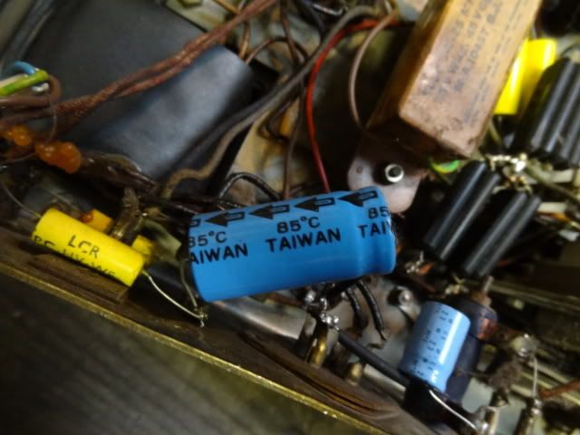

And underneath you can see where someone has fitted a whole lot of new electrical stuff which is way above me  :D
In wanting to keep this looking as original as possible I don't want to make any holes bigger than they are so it could be returned to original condition if need be. I'm thinking a 7 inch touch-screen will fit in there perfectly right enough  ;) Any leads for decent priced touchscreens in the UK?
Close-up of the front dial. The marking are on the actual glass and what I'm thinking is I'll try and remove the glass, clean it up and scan it in with a bit of black card behind it and use that image as a screen saver if/when it's all complete  ;)
