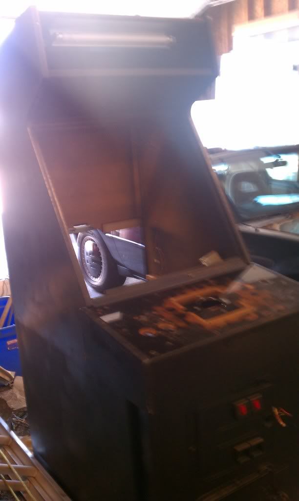

Hey, everyone.  Just wanted to show off a few pictures of the work I've done so far.  I still need to re-paint the sides of the cab as I had to patch a few screw holes, change the t-molding to red, wire the coin doors to be used with the ipac, finish the shelving underneath/behind the coin doors, etc.
This is the cab I was given.  It's an original MK2 cab, but had been converted into World Class Bowling before it was gutted.  (Can you spot KITT too?)  Sorry for the quality of these pics.  I currently have this at my work so I only carry my cell phone.  Once it's finished, I'll have some better pics.
