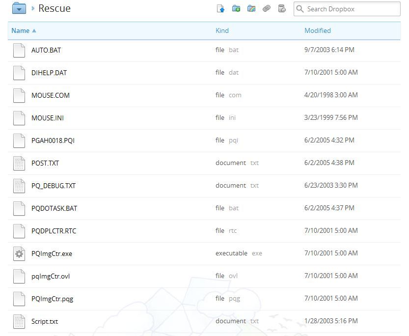

Good day all.  I have a PGA with Challenge III version 2.2.0.0 on it (I have 2.2.2.0 disks but they appear to be bad).  I can get the game installed and running with the 2.2.0.0 version. Couple of problems though:
Is there any way to set it to $.25 a credit? 1 Credit a game?
And the BIG one, how can I change out the video driver so I can use a later version Nvidia card?  The card in the machine is dying (corrupt screen blocks).  What I tried:
Used the recovery disk to format the machine
Copied the NVidia 93.71_Forceware driver onto the machine (but didn't install it)
Rebooted and finished the 2.2.0.0 install to the point the machine came up to game mode.
Turned it off and swapped video cards (I had hoped XP would detect the new card and ask for a video driver, but it didn't).
Game starts to boot but ends up at a black screen.
I am trying to install a BFG Tech GeForce FX 5700.
Open to any suggestions on how to get around this issue (different software versions, different process to get the driver onboard, etc).  Thanks.

hi
DavidShoemaker
i went through this in great detail
your problem is >hercule's<
it is called to look for a specific set of :nivida-driver's:
u have to rember we are running on a very short window's set of driver's
winxp>>e<<
now with that a page back or even this page i posted a way to do the edit and the how,just loading them into window's mean's jack..unless u repoint :hercule's:
start read here >>
                       A simple walk through for gobal vr pga golf

Hey thanks Ed but I seem to have a VERY different software layout than what your seeing.
I don't have a PGA directory on my drive.  And there is nothing Her* on the entire system. (Also no GVRDongle.*)
There is a PGA_TOUR_GOLF directory.

« Reply #684 on: December 13, 2012, 10:13:34 pm »
hi
DavidShoemaker
u are reading the harddrive
what u need to do is follow my readme
it explains how to find hercule's
which is a .bat/.exe file
it is in cmd32.exe
u  MUST FIND IT
it is there
unless u know how to break window's down? u will not find it
to search for it live remove my hifen >'<
go to search
find hercules
open in notepad/wordpad/and or any other txt editor
u can then edit
but as i said U CANNOT DO IT TO A LIVE HARDDRIVE
U MUST FOLLOW THE STEP'S I LAID OUT
ed

I removed the drive from the machine, installed it into an external IDE -> USB enclosure.
Connected it to my PC (Win 8) drive shows up as an external disk G:
To be safe I copied the entire contents to a backup folder on another drive.
I have view hidden files turned on, I did a search for her*.* on the drive.  No results found.
I am seeing else where talk about a rescue disk?  I have an emergency recovery disk (050-0024-01 Rev B) and two software disks Version 2.2.0.0.  I don't have a rescue disk.
It's obvious I am missing something here.

Well I was able to get the game up for posterity here is what I did:
Using the (2.2.0.0 emergency recovery disk 050-0025-01 Rev B) with the original video card I started the install.
Then I used the 2.2.2.0 disks to install the game
After the game was up I shut down and swapped video cards.  The new card was a FX5200 which the drivers installed by 2.2.2.0 worked with.
I had to reboot twice to get things to configure correctly.
I also had to jump into the start menu in that quick second it is up because the video was defaulting to 640x480 and I had to change it to 800x600.
Now if I could just figure out how to get it to be a bit more $ friendly (this is going into a budget location).  I would REALLY like to be able to configure it for 1$ for 18 holes.
Thanks.

I must be doing something wrong because I cannot find Hercules ANYWHERE on my rescue disk for Team Challenge. Has anyone else been able to find it on the Rescue? I can only find it on the install CDs. I copied the Rescue to my home computer and when I explore each folder I don't see Hercules listed anywhere nor do I see any reference to the dongle call. I only see the GVRdongle.exe on the three installs. If someone has a few minutes to check their Rescue I would appreciate it. Ed, is it possible that my rescue is different for some reason?
Ed, would you consider posting your complete Rescue CD that has the edit completed prior to waiting for the online server to officially launch? It seems that it would help many here to play their PGAs again. I've personally fallen on my face trying to get anywhere with my Rescue CD for weeks. I've asked for some help from a few other friends and they were not able to do this either.
Im ready to throw in the towel and humbly ask for an upload of your edited CD. If you say Hercules is there then I believe it. For some reason I just cannot find it. You would be putting an end to months of frustration by uploading a complete edited Rescue. It will certainly fit in Dropbox! What do you say, buddy?  :applaud:

Ed...I don't really know how else to explain this to you.  I must be a complete moron because it's not there that I can see.  Can you show me a screen shot of what you are seeing at least?

hi
yes
i could have answered u from the office when i seen the request
but i cannot log in from the lappie ?
it may not be the best pic but i will up-load
ed

« Reply #696 on: December 14, 2012, 08:45:36 pm »
When I copied the Rescue CD to my home computer and opened it up I don't see a file structure that looks anything like this.  Should I be doing an install of the Rescue on a separate hard drive and then edit from the installed software on the hard drive versus trying to edit the files prior to installation (if that makes sense)?
Offering commercial grade vinyl decal printing for cabinet side art, control panel overlays, monitor bezels, marquees, etc.

This is what I see when I explore the files on the Rescue on my home computer.  I don't see any of those file folders that you show in your pics.
ed12
  • Posts: 3972
Re: pga golf vr-gobal
« Reply #703 on: December 14, 2012, 11:59:34 pm »
hi
do u see the pq ?
that is parition magic
i went trough this 15 post's ago
it put's a layer on top of the hard-drive >it not olny chk's it,but layer's it<
the pic's i up-loaded are right out of the server box
GOBAL-VR-PGA-GOLF u can clearly see it in the back-ground,even with my lame arse pic taker :):)
i did biatch about it,then i broke the code down,posted what was nessary to fix it
NOW if u cannot get your's running without dongle ?,just hold tight
i will post the how to
ed

Are you editing within those folder by slaving your PGA drive versus popping in the Rescue and copy and pasting it's contents over to another computer's C Drive and then exploring the contents?  When I copy and paste the Rescue to my home computer's desktop and open it up I have the file structure as displayed in my last post.  I do not see any of the folders you are snapping pics of.  The only thing I can think of is that you might be looking at a HD that has the Rescue installed already or it's because Windows 7 is displaying the contents of the Rescue differently then XP?  I'm not using any special program to look into Rescue either am I?  Just Windows?
Has anyone else been able to do this dongle bypass from the Rescue?  Can anyone give this a try and see if it's just me being an idiot about this?
