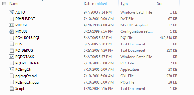

open it,:REMOVE THIS BATCH FILE >>GVRDONGLEMONITOR<<,it is in :HERCULES:

This is what I'm seeing when I go to the rescue.  I was using "freefileviewer" to search within each file and I don't see the "gvrdonglemonitor.exe" anywhere.  Am I overlooking it?  This is Team Challenge.  Interesting is the amount of Need For Speed files are in the PQ_Debug file.  Have no idea why those are there.

hi
stpcore u are right
i must have grouped them
this is exactley what u are looking for
in !!hercules!! u will c the call
to gvrdongle.exe
i do not believe u overlooked it
it could be in disk 1
let me double chk the disk's
