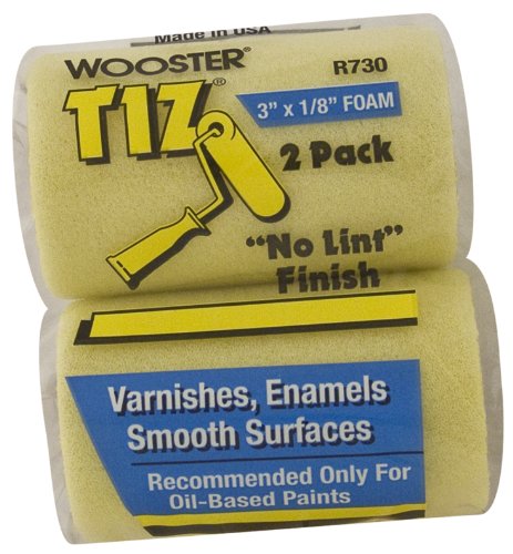

Thanks. So far the laminate process has been headache free.
I just ordered two sheets of laminate for the sides. I hope to finish the remaining while that's shipping. This week I want to finish the rear door by installing a paddle latch and laminating it.
I believe I have enough remaining laminate material to make strips for some of the exposed edges. I worked out a way to cut the formica on a table saw without chipping by dropping down the saw blade and laying the formic underneath scrap plywood.
For laminating I used
And a small 3" roller
I used a small roller I got off ebay to push adhere the formica and force out any air.
I found a cheap paddle latch on ebay. I'll use that to open the back.. (I hope)
