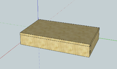

Design
Here is the design broken down into steps from Sketchup.

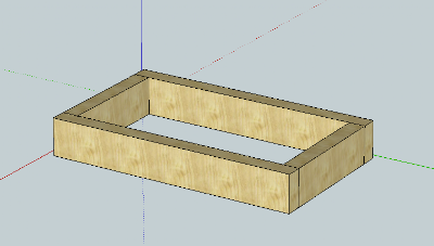

First, the base is constructed of 2x4s and a piece of 3/4" plywood on top.
I use an additional 2x4 trimmed and installed at a 45 degree angle to support casters that will be used to move the cab when it is tilted back at an angle. Here is a view from the bottom of the base. (I have a question about the stability of this caster design)
Next, the left side is added to the base.

Questions
I'd love advice and feedback from this forum on any aspects of the design, and I also have a few questions:
1- Does the design seem stable? Any concern it would tip over?
2- Should I use partial furring strips (as shown in the design) or full strips top to bottom?
3- Does the caster design seem feasible? They are positioned at a 45 degree angle on the base.
4- Is there some way to make the control panel removable? I'm thinking about some kind of sliding lock mechanism on the bottom of the CP.
5- Paint or vinyl?
6- Any advice on joining?

I built a slim cab, check out my sig. (man I need to update the pictures of the completed project.)
My thoughts:
1- it's plenty stable, just make sure it's wide enough to fit you pc in the way you want.
2- I used 1x2 batting. Doesn't matter ful or partial, just glue and screw and you will be fine
3-casters- design seems fine, but I would ditch it all together, unless you plan on moving it around a lot.
4- yes, most common way is control panel latches. I got some, but in the end used washers thumb screws and wing nuts along with l brackets
5- depends on what look you are going for. I lean towards paint, but really for no reason
6- simple butt joints, glue and screw, counter sink the screws, putty over and sand flat.
Other observations
1- put a couple vent holes in the back bottom for airflow to the pc
2- don't use a piano hinge in the front door, use hidden euro hinges, it will look better
3- ditch the keyboard drawer , it adds complexity with not much benefit. I would just PKU a mouse and keyboard into the pc to set it up and leave them ther. Once the machine is set up you should rarely , if ever need a keyboard, and having a keyboard out is just asking for trouble from guests screwing around
4 - 19 inch monitor is an okay siR. But it's still pretty small, I would ditch the trackball to save space on the CP. Nothing looks crappier than a huge bezel around the monitor. I have a 21.3 inch monitor, the screen is 17 inches wide, the internal width of my cab us 24 in. giving me a 3.5 in. Bezel on each side. I would not want a bezel bigger than this . Keep that in mind. You don't want a huge bezel it a beefy overhang on your cp box. It won't look right.
Good luck!

@Donkbaca, thanks for your input! Very helpful.
You've convinced me to drop the casters. I'm not going to be moving this regularly. In fact, I'll probably earthquake strap it to the wall.
On the monitor size, what is the ideal size and aspect ratio for an LCD monitor? To keep this slim, I don't want to use a CRT or TV.

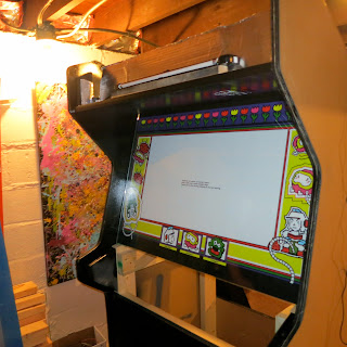

I added a mockup of the Bezel to see how bad it looks and I see your point. It's big.
The issue is that I'm hesitant to reduce the width of the cab in case I ever want to upgrade the monitor. But maybe that is not a smart strategy?
I'm also hesitant to reduce the width of the cab because I don't want to reduce the width of the CP.
Alternatively, I was thinking I could use the extra bezel area as a place to have game codes, like the MK bezel below. It would be cool to have different bezel overlays that could be attached based on what game is being played.
Other ideas?

your pic is basically what my 19" looks like.  the bezel is 4" on the sides, 6" on the top/bottom, and the reverse when rotated.  It doesn't bother me but I would def. desire to go bigger for horizontal only.  I would go with 24" width on the cab, looks proportional and it's easy to upsize the display at any time.
I used 1/4" gray tinted glass, 30% light transmission.  You really can't tell much if any difference on the screen, even when you AB compare it.  I may have bumped the brightness up a few clicks.  Mine is back painted black to create the bezel area.  glass shops will give you samples to take home and look at.

« Reply #15 on: September 29, 2011, 11:37:48 am »
OK a few things:
 - I wouldn't worry about upgrading the screen, In my mind, the biggest pain was cutting the bezel ,just build it more narrow
-alternatively you can try and get a 21.3 inch screen.  You can find used ones on ebay for under $200.  If you get one in good condition, they are totally worth it as a lot of these are top of the line ones that sell for $500+ new
I just used plain plexi and grabbed window tint and applied it myself.  I know that people on here have bought smoked plexi online before.
Applying it yourself kind of sucks, you need to be patient and do it in the most dust free place you can find.  Its pretty cheap though, and looks really good.  You can't see anything when the monitor is off, the whole screen area is black.  I also used the tint on my marquee since Its edge lit etched plexi.  I need to upload pictures, maybe tonight, if I have the chance
Whatever you do, just be mindful of proportion, and remember the number one rule, build the cab around the monitor!

Here are updated design pics.
Base frame (2"x4"s)
Base with plywood top

New Update! The arcade cab construction is complete and playable!
[Photos from October - November 2012]
In this update, I complete the construction of the cabinet, including all plexiglass cutting and assembly. I attach the speakers, LEDs, monitor and computer. I wire up the control panel and am able to play the first games.
Problems: I can't get the trackball working. Need some electrical help!  The speakers are buzzing. Don't know why.
Open items: I still need to attach the spinner and the admin buttons. AND I need to get some help on artwork!
Plexiglass
I purchased samples of acrylic ("plexiglass") and Lexan ("polycarbonate"). Ultimately I decided to go with acrylic. Acrylic was easier to cut, less likely to scratch, and does not yellow over time. http://www.hydrosight.com/technology/polycarbonate_vs_acrylic.php
I went to Lowe's and had them cut the plexiglass to the proper rectangular sizes for the marquee, monitor bezel, and control panel. Then I went to work on the control panel.
Here is a test of a pushbutton.
And here is the test of the Lexan (left) and Plexi (right).
Now I was ready to cut the main control panel plexi. The first thing I did was align all of the holes.
Here is the control panel with the trackball.
To align everything, I turned the control panel upside down and clamped it to the plexi. I had the plexi sandwiched between the CP and another board so that I would drill through the other board.
To cut the pushbutton holes, I needed a 1 1/8" bit. I originally tried a spade bit but that didn't work, so I purchased this hole cutting bit which worked great.
All of the holes are done.
The plexi melts as you cut it and leaves some plastic on the hole. Just use your fingernail to break that off.
Here is my trackball test cut using a 3" hole saw.
It fit, but the edges were a little rough.
The final cut was much smoother.
Fits perfectly
I would end up sanding the inside of the trackball hole with 250 grit sanding block just to smooth it out a bit more.
Speakers
I installed the car audio speakers. They fit perfectly.
Connected the amplifier.
Mounted the amplifier in the cabinet.
Marquee
For the marquee, I used two pieces of plexi and I plan to sandwich an art printout between them. To mount the marquee plexi, I picked up a plastic wall corner protector from the hardware store and cut it with a hacksaw.
Monitor bezel
For the monitor bezel, I first drilled holes into the plexi in the corners where the screws would go, then attached the bezel to the cabinet using black screws with neoprene washers.
LEDs
I purchased NovaMatrix LEDs from GroovyGameGear. They connect to 12v power which can come from your computer or a power adapter.
I needed the LEDs to face forward, so I added a 2x2 beam inside the cabinet where I would mount them.
I mounted aluminum foil with a staple gun to reflect light behind the marquee.
I also left the protective film on one piece of plexiglass to make the light more diffuse. Overall happy with this.
Finishing the Control Panel
First I had to cut the angled front of the plexi. I decided to use a utility knife to score and snap.
The result was very good. One minor nick. I then sanded all of the edges and drilled holes for the mounting screws.
I attached all of the buttons and the mounting screws.
Here is the inside. The control panel top is attached with a piano hinge.
Wiring
Now it was time to wire it up. At first I tried to use cat5 cables. That failed. I ended up using single lines for each connection.
Playing the arcade!
I was super excited to connect it all up and be able to play some games!
Mortal Kombat 2
Pac-Man
And my son loves Bubble Bobble
Now I really want to play Golden Tee, but my trackball is not working!
Please help me with open issues!
  • Trackball - I purchased the GroovyGameGear 3" Trackball (no solder version). I connect the 3 inputs to the OptiWiz board and the USB cable, but nothing happens. I see there are two 5v connections, but I don't know what to connect there??
  • LEDs - I purchased the NovaMatrix LEDs from GroovyGameGear. I attached them to my PC using the molex connector and the motherboard blew. I had to use a hardware reset of the CMOS to get it back up and running. I'm wondering if I had loose wires that shorted. What do you do with the additional molex wires?
  • Speakers buzzing - I think I must have electrical current non-grounded and running around causing speaker buzzing.
  • Artwork - I'm looking to contract someone to help me with artwork for the marquee, control panel and sideart.

ambush
  • Posts: 46
  • Last login:February 11, 2013, 08:55:29 am
Re: Long time reader, first time builder: MAME Slim Cab
« Reply #73 on: November 24, 2012, 04:32:05 pm »
Here is the trackball connection problem broken down.
I purchased the Groovy 3" trackball http://groovygamegear.com/webstore/index.php?main_page=product_info&cPath=74&products_id=363 and the OptiWiz no-solder USB interface http://groovygamegear.com/webstore/index.php?main_page=product_info&cPath=76_85&products_id=260.
The trackball has 4 wires that come off of it. 3 of them are for motion and connect directly to the OptiWiz pin connectors.
The 4th is a green wire with a circular terminal connector. I have no idea what this does. Maybe ground? Where should it connect?
On the OptiWiz interface, there are two pin connectors that say 5v. What do I connect to these? There were no supplied cables for this.

The connector with blue and purple is for the X-axis.  Connect to pins A+B.
(Looks correct in the photo below.)
The connector with green and yellow is for the Y-axis.  Connect to pins C+D.
Red and black are for 5v and ground respectively.  Connect them to the pins you circled in this photo.
If left/right are backwards, reverse the blue and purple connections.
If up/down are backwards, reverse the green and yellow connections.
