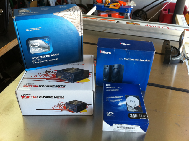

The Brains:  I bought an Intel Atom motherboard, memory, power supply and hard drive.  I didn't feel like messing with older hardware.  In retrospect, I wish I had just bought an old PC off Craigslist (it would have been cheaper.... and couldn't have been any more frustrating. :))

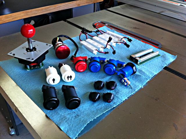

Controls:  I picked up a U360 with an octagonal restrictor, some leaf switch GGG buttons, couple of standard micro switch buttons, four volcano buttons (for admin), a spinner from Ultimarc, and an IPac.

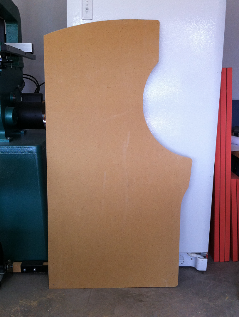

I made a template out of 1/2 inch MDF.  I'll use this to route both side panels.  I made the template deeper than it will end up (I'll likely take an inch or two off the back.  I made it oversized so that I would be able to fit my monitor.  Once the monitor is in, I'll trim whatever I can off the back.
And some components I've collected this far...

Spent a LOT of time in the shop today, and got little to show for it.  I picked up a sheet of black Formica laminate from Home Depot this morning and got the insides of the two side panels covered.
I got a little more done than just these sides today, but I'll wait until I have some more interesting photos before I post them.
Also, you can see the profile is not as deep as the previous post.  After I got the monitor mounted on the board, I was able to make sure how much room I needed, and I ended up taking two inches off the back end of the sides.

Got some goodies from Groovy Game Gear in the mail.  I ordered a new black anodized spinner top to replace the red one I got from Ultimarc.  I liked the red one, but it seems just a hair too large for my control panel, and the anodized red didn't work for me.  I really do like this new spinner top.  It has a nice satin finish, and the smaller size seems better suited to my control panel.  Also, I think it is going to look nice with my volocano buttons.
I also got a new Hand-Candy joystick ball top.  I didn't mind the seam or the dimple on top of my old ball top, but I added this to my order to better justify the shipping (I know there's no logic in that :)).  Anyhow, I really like it now that I have it. http://groovygamegear.com/webstore/index.php?main_page=product_info&products_id=368
