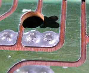

Ok.  The good news is that I pulled the chassis and I'm still alive.  Even better, I think I can actually put it back!
Good job! See, wasn't that hard, right?
My problem now is with the soldering.  Are you kidding me?  I have no idea where to start here!  Here's a picture of the back of the chassis in general.
Looks normal to me.
Next is the part where I was jiggling the wires.  It doesn't look obviously bad to me like I was hoping.  Also, am I really supposed to get the solder so that they don't touch and make a big mess?  It doesn't seem like there's very much room!
Do you have a soldering iron with a pencil tip? The big 'gun' style soldering irons are usually not suited for this kind of work.
Also, there's quite a bit of gunk (which I believe is the technical term).  Is that a problem?
That's just flux residue (helps the solder adhere to metal when soldering.) There's always a bit of flux visible in each solder joint.
Here's a picture of what a cracked solder joint looks like:
(by the way, to embed an image into your post like this, just type img tags around the address of your picture...like {img} and {/img} but with brackets instead of braces)
Look for cracked joints like that on the bottom of your chassis. Get a magnifying glass and use very good light -- sunlight, if you can. Don't be afraid to wiggle the posts with your fingernails to see if any are loose.
Let us know what you find out.

I did this up on your pic just to show some of the more common areas on a K7000 that need touched up, most of yours looks to be in good shape, but just double check since you actually have it in front of you to look at.
Hard to tell in that second pic of the headers pins if there is any circular cracking on those solder joints. I know it's hard to get a good macro shot that close. But double check those, if in doubt just touch them up with a hot iron anyways.
Great example.  :cheers:
Sometimes they will also look like a perfect hairline circle/ring around the joint.
I always forget about the "embedding" option.  :P

Holy crap!  You guys are amazing!  I think it hopped out at me like a scene from The Da Vinci Code after reading your posts.  It does look like the first 2 (if not 3) all have a bit of a circular crack!  Anyway, I'm trying to attach them straight away so I don't have to mess with flickr.  The first two are different views of the pins.  The 3rd one is the neckboard and the last one is my awesome soldering iron that is not opened yet.  It has a 5/32" end so I'm hoping that's small enough.  I know it's not great, but to be honest I'm probably not going to be using it often.  If it's totally unrealistic to do the job with it, please let me know though.
Also, I've looked over the rest of the solders and nothing really jumps out at me, but I'll keep looking.

Yep, you've got cracked joints. In a perfect world, what you'd do is suck off all of the solder on each bad joint, then resolder each one. But it should be acceptable to re-heat the solder and reflow each joint. As long as you see it pool up and re-cool nicely on each pin, you should be fine.
While you've got the chassis out, feel free to look it over and get familiar with it. Look over the rest of the joints while you're at it. But looking at your pictures it's clear your issues are coming from your video input pins.
90% sure that will fix your issues.

FYI - the first 3 pins are red, green and blue, so at first your missing red was due to cracked joint number 1. When you wiggled the cord, you caused the cold joints at the green and blue pins to crack loose too, and at one point blue went out too, leaving you with just green.

Yup.... thems be broke all right.
Heat, dab of solder while heating, remove heat....should fix it right up.
About 3 seconds each tops ought to do it.
