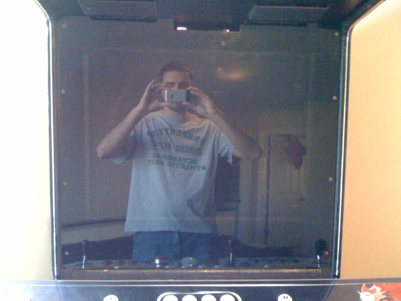

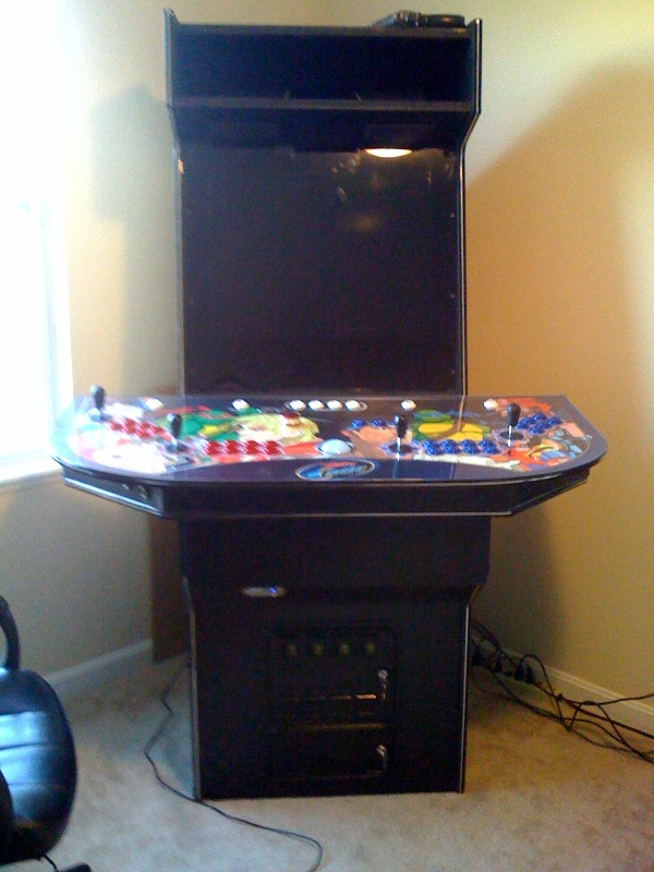

Today my wife and I introduced a new member of the family into our house.  She's not done yet, but she's home.  :cry:
So I have the coin door and the CP art from GameOnGrafix hopefully on the way.  Once I get going on the finishing touches, I think it's going to look nice.
The plexi came in yesterday.  Here is the smoked plexi in front of the TV/monitor
I think I like it, but something in the back of my mind is saying it is too dark.  I'll install it for now, and swap it if I don't like it.

MVC2!!!! Thats awesome, Im jealous! I dont know if Im feeling the angle of the CP though. Looks kinda steep for my taste.  ;D

I think the CP looks deeper in the pics than it really is since I was taking the pictures at an upward angle.  It has a 4.5 degree slope on it, going down 2 inches from the back to front.  It's about right imo.
As long as it holds a beer without sliding, I'm happy :)

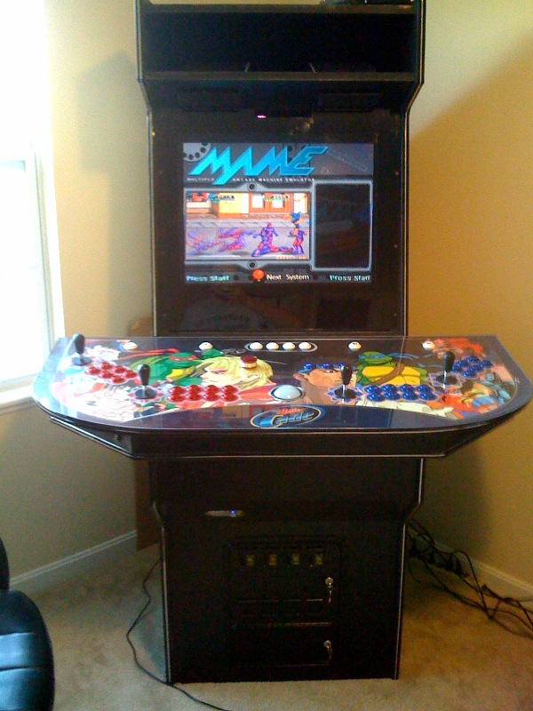

Finally completely finished my CP using my art I ordered from gameongrafix!  It looked great.  I'll post higher res pics when I take them.  I really like the way the CP turned out.  There are imperfections if you look close...as I cracked the plexi while cutting the trackball hole  :angry:  But I'm not a perfectionist, and I really didn't want to do all that plexi cutting again.
Here are the pics!
I also installed a new 4 player Happ coin door.  I don't have pics of that on me, but I'll post them when I do.
I'm nearing the finish line!  All I have left to do is come up with marquee and side art then put it up.

Looks awesome man. I would have put spiderman on the left(red) side, but hey, thats my taste. Everything looks amazing! I like how you put the admin buttons on Ryu's headband.  :applaud:

Here it is with the new CP installed and my new coindoor!
I also cut out a spot for the volume controls (the blue light).  This needs spray painted and mounted better.  But aside from that, the control panel and below is done!

So I was finally able to add my bezel/plexi over the TV, and it turned out ok.
I had to cut a chunk out of the top for the aimtrak.  This is because I wasn't thinking and spray painted the entire outside bezel without thinking of leaving a non-spraypainted portion for the aimtrak.  After the fact, I tried removing the spraypaint with a sharp knife with no luck, so I just cut it out.  Not a big deal, just another little mistake I made.
The plexi I ordered was 1" too small for my opening, but it was the widest peice they offered in the grey plexi.
You can see the opening at the bottom of the screen.  This is another annoyance, but I'll live with it.  I might just cut a 1" strip of plexi to piece down there
And the last thing is I drilled the plexi to the furring strips, but now the screw heads just glare at me.  They are dark, but a little off color of the plexi.  Also, the screw heads are not flush with the plexi.
In this picture you can easily see the hole in the bottom of the plexi, the chunk cut out of the top, and the screw heads.
Maybe spraypainting the screws black, drill bigger holes for the in the plexi (to hopefully flush the heads to the plexi), and cut the 1" strip of plexi for the bottom will fix my annoyances.  Or maybe I'll just re-do the entire thing?...although I don't want to have to do that.
