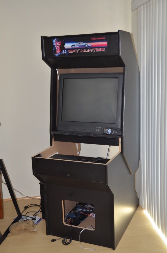

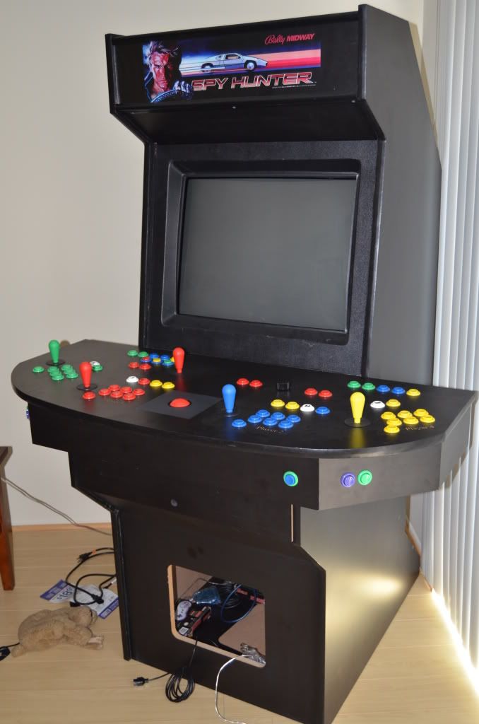

About 6 years ago I had a MAME cabinet made. The design laid out by the cabinet maker was great. It came apart in 3 pieces as I am an apartment dweller and I am prone to moving for work. I am in the process of putting it back together after a recent 4th move (Chicago to LA) and I am motivated to make some improvements on it while I'm putting it back together and have some $$$ with which to make it happen. Bear in mind that I am not a wood worker and I did none of the control panel wiring though I did Frankenstein the PC together that ran it. So I do have some skill and a willingness to learn and experiment. Actually seeing the various home builds here has given me a lot of ideas.
Here is the machine (It's not a Spy Hunter machine. I just LOVED that game as a kid so I made a marquee for it)

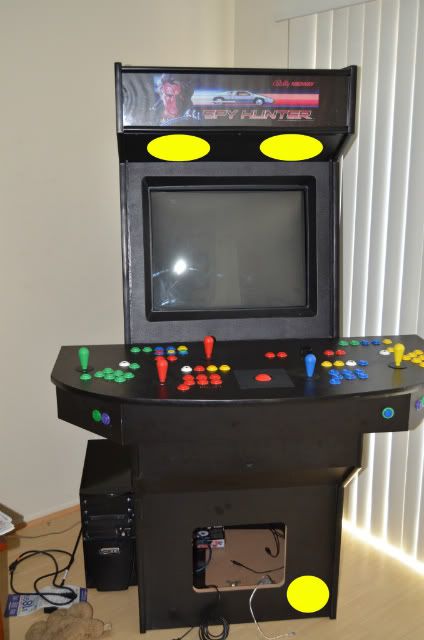

Upgrades I'd like to do:

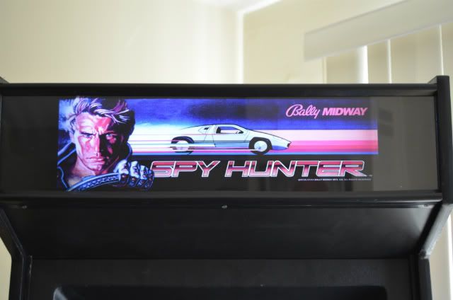

Marquee:
Illuminate Marquee with an LCD light source
Design original Marquee with various video game elements. Specifically incorporating Kinky Pinky from NARC.
Power
Install a MASTER power switch on top that powers on PC, Speakers, Monitor.
Finally configure PC to auto execute hyperspin upon power up.
Monitor
Replace TV with sharper LCD panel.
Speakers
Install 2 speakers and 1 subwoofer into the cabinet.
Coin Door
Replace door with a coin door.
Marquee
I just installed a lcd light bar. http://www.amazon.com/gp/product/B000IV5PCY.
I'll be working on the actual artwork last.
Power:
I'm not sure what kind of switch to buy. I've seen a few threads here of people saying to use the smart power strip but I'm going to have read up on the best way to get this accomplished. My goal is single power on switch. I believe the FE's have a power down option. I'm currently using Hyperspin.
Monitor:
The cabinet was designed to hold a 27" CRT tv. I'm contemplating getting an LCD monitor. Maybe without having to rotate the orientation of the monitor. I'm still looking at this. I've already seen how MAME can crop the game display. I might be nice to have some of the bezel artwork displayed if it doesn't cost any resolution.
Speakers
I'm looking at finding some decent but not terribly expensive PC speakers and install them in the yellow areas. (Subwoofer at the bottom) I'll have to find a way to get these pieces cut. I don't have a jig saw.
Coin Door:
There is already a door, it's just not attached at the moment. Once I get the machine able to power up from a single flip of a switch (push of a button?) I'll seal off the front with a coin door. It looks like this might be a pricey facade.

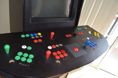

That looks really cool. I hope to have time next week to start cutting into the wood. I need to get my drill back. It's on loan.
How hard is it to replace hardware in the CP? Are the Joystick, spinner, and trackball housings standard? THey look similar but I'm figuring they are not. I was contemplating replacing my existing buttons with LED's and maybe the joysticks and trackball. Below is a pic of what I found when I opened the control panel.
I can manage reconnecting the wires as is, I'd just like to avoid having to rewire the I-pac and the Optipac. I can't really follow all of it as it's laid out. The number scheme is wrong and the color scheme is ignored. Plus I don't have a lot of experience with it.
 I'm hoping LED's have their own power that I could connect and manage separately. If I did get LED's I'd like to employ the LEDwiz or whatever app lets me mess around with the light scheme. Ideally lighting up during games when in play for certain games and flashing around when the machine is powered on and idle. Is that even done?

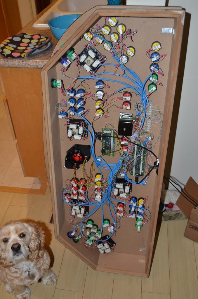

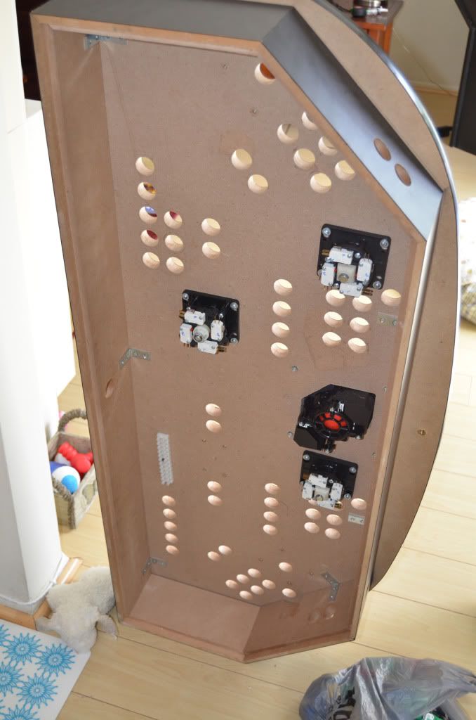

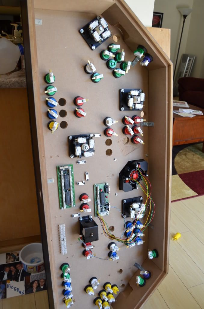

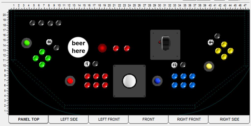

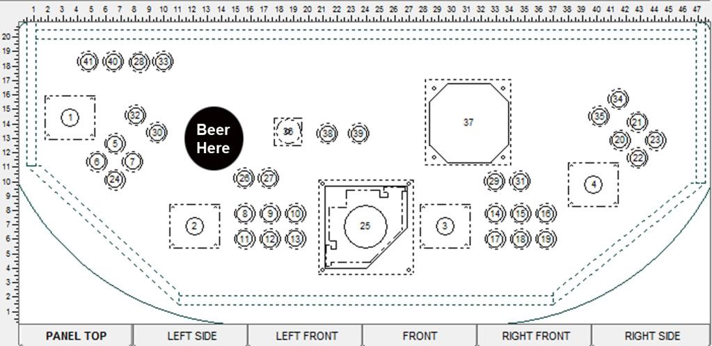

Update: I ripped out the old wiring. I removed superfluous buttons. I received the first of many test LED buttons but there are some issues with getting them seated in the CP. I also decided on a LCD monitor that fit my needs and was within my price range. So the old TV is on it's way out. The Smart Strip is on it's way along with some new wiring and a new PC switch to power on the PC.
I abandoned plans to drill many speaker holes after reading about some sound quality issues and my wife wants me to make this into a juke box as well so the sound needed to be great. The search for good mountable speakers begins.

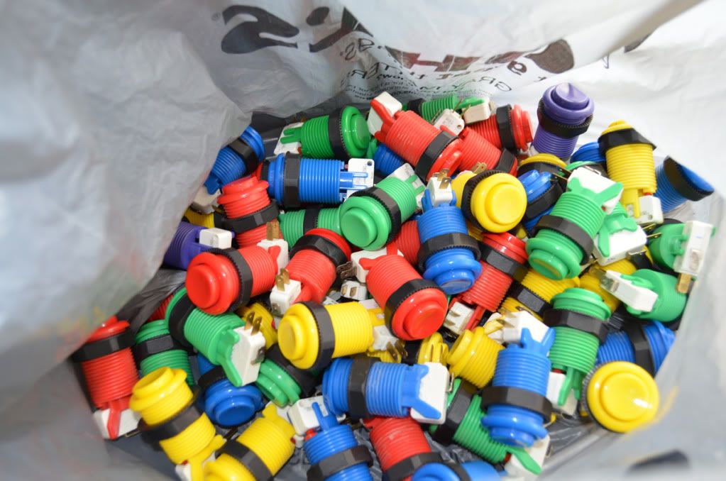

Buttons
I removed (11) buttons that I felt I would not need anymore.
(4) buttons (2 pair on each side) wired to the optipac serving as L and R mouse buttons. (utter overkill)
(3) buttons hard wired to a modified remote control that used to run the power and volume on the old 27" tv set. With an LCD on the way it was launched.
(4) 7th action buttons from 1-4 players. I will soon remove (2) more buttons from players 3 and 4 as well. I can't think of a reason to have (6) at all 4 players if they are not playing anything but arcade and older console games.
Does a 4-player cab really need all 4 players to have (6) buttons or just players1&2 with (6) and players3&4 with (4) buttons each? I'm not using these controls for anything beyond arcade and early console emulation(NES,Atari, SNES). I'm inclined to think it doesn't. For simple symmetry I can't justify the added expense of extra LED buttons. Not sure if how it will look.
I plan on filling the holes with pieces of wood and wood glue. Towards the end of the project I plan on getting a nice custom overlay to cover it.
There is a row of (10) buttons at the top that I never actually used. They were wired into button #8 on the ipac. I'm not sure how many extra buttons I'm going to need with Hyperspin running the machine. What's buttons will I need besides Esc?

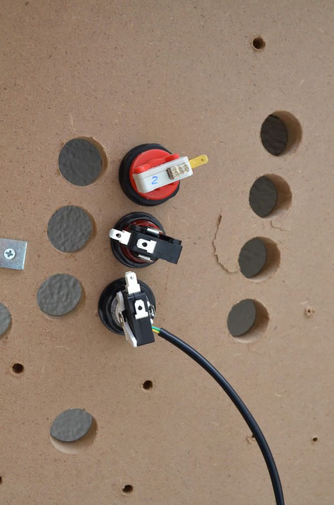

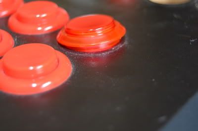

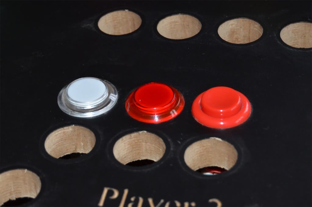

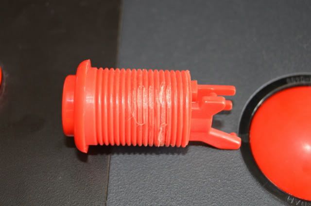

In removing the buttons, I noticed that the holes might not be exactly 1⅛". It took a considerable amount of force to remove them and many of the threads appeared to be smashed.
I received a new test LED button from Paradise arcade. It's not wired but I wanted to see how it felt next to my Happs. I have a used Ultralux on order as well. I'm hoping to test some Electric ICe and Nova gems as, based on what I've seen, I am interested in them the most. They appear to have been sold out for a while now.
As you can see, the button doesn't quite fit into the slot. I am not going to smash these in there. I'm going to try redrilling these holes with a basic set of hole saw drill bits that are on order. I'm using them to make make speaker and power button holes in the cab. The set does have a 1⅛" bit. I'm hoping it's as simple as running that bit slowly and evenly through the existing holes edge. Worst case I get a new control top. I'd like to avoid that though. $$$
Here is the inside all cleaned out. There is a superficial gouge under player 1's buttons. It was there originally and never affected game play or how the buttons sat.

Wow, someone finally decides to actually get all the buttons and test them!  Tell us what you think.  I have the paradise arcade buttons, but I have the chrome bezels on them.
Don't use the hole saw, get a file and grind out the holes to make them larger.  I bought a chisel set at Home Depot/lows that had rounded files to file out holes.  It doesn't look like you have to go that much larger...
drventure
  • Posts: 4152
Re: My old MAME Cabinet Revision
« Reply #11 on: July 22, 2011, 02:46:53 pm »
+1 on donkabaca's hole saw comment, That'll be hell getting to to cut right.
One other possibility is to put together a quick router template and use a router to trim out the holes, but really, a file might be quicker and easier.
TopJimmyCooks
  • Posts: 2098
  • Last login:July 12, 2026, 05:42:15 pm
« Reply #12 on: July 22, 2011, 03:48:44 pm »
suggest Dremel rotary tool or even a corded power drill, with a drum sander attachment.
http://www.dremel.com/en-us/Accessories/Pages/ProductDetail.aspx?pid=438
or similar.  You won't have to take much off.  you can get a dremel knockoff and some attachments at harbor freight for cheeeeeep.
Perfect, I actually have an old dremel. I'm 95% sure I have a sander bit that came with it.  I don't have a router otherwise that would have been ideal with a template. I'm not real woodsy.

Dremel with sander drum, probably best bet!

Monitor arrived. It almost sits perfectly with the old Bezel over it. I'll have some time on Friday to snap some pictures.
Still waiting on GGG to make Novagems and Electric Ice buttons available. Anyone know if these buttons are holy grail as far as availability? I only started researching and looking for LED buttons in June and I have no expectations as far as turn around time as I don't order parts with any regularity.

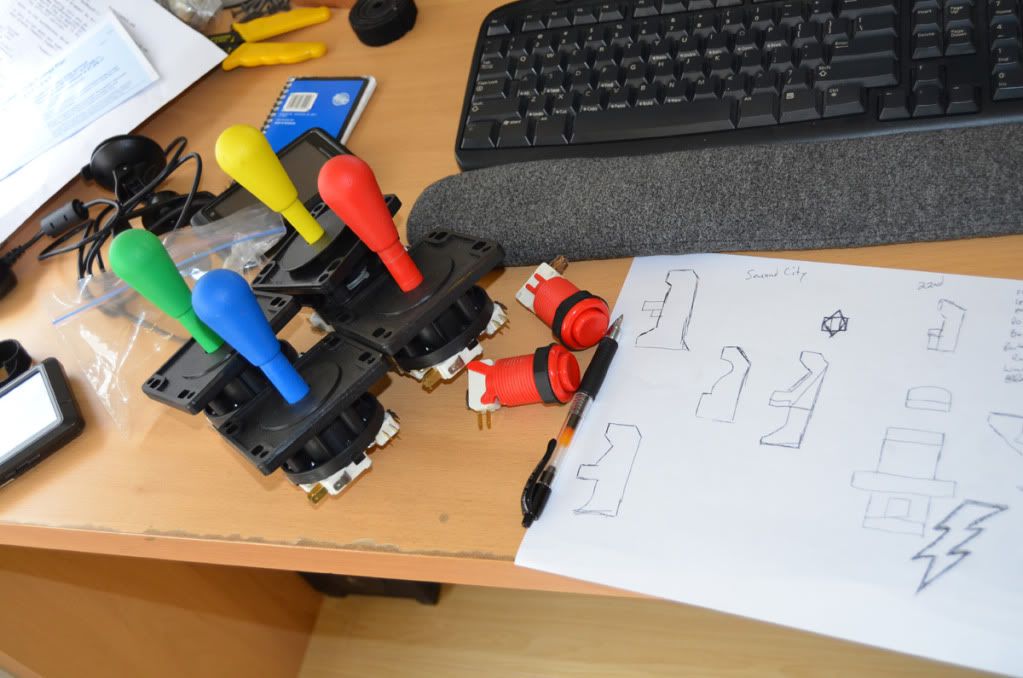

I'm going to use 24 LED buttons. (6) for players 1&2 (4) for players 3&4 and (4) for the spinner and 4 way controller.
I started sanding out the holes with a dremel to make way for the Ultralux and Paradise LED buttons I currently have to test. I'm going to have to figure out a way to power them without their proprietary harness.
I intend to add new joysticks to the list. I'm leaning towards GGG's Leaf Pro joystick. The Happ one's I currently have make a lot of noise and do that annoying thing where they spring back into place with a lot of noise if you let one of them go. I'm also thinking I might unload the Happ 4 way controller for a top firing flight stick a la Tron or something similar.
If I do end up with GGG electric Ice buttons I plan on upgrading my 3" ball to the EI RGB ball. The upgrade kit is $36.
An artist friend of mine offered to design my speaker hole cover. I was about to use a hole saw and drill a (2) 4" holes. I'll take a stab at letting him design something cool looking and see if I can pull it off. Worse case, it looks like hell and I just cut it out all together.

Still waiting on GGG LED buttons to become available again. (Novagems and EI2)  It's just a matter of time until they are. I've gotten a few friendly emails from Randy in that regard. (Thanks Randy)
I'll order a Classx LED button from them as well though I don't believe I want the flat competition styled buttons after trying out the Ultralux and a Red Convex LED button from PA. (just based on feel and tension)  I'm just "all in" for testing the major LED buttons and making a nice, albeit subjective, side by side video showing the buttons in action. (Ultralux, Classx, Illuminated translucent IL buttons from PA, Electric Ice, Nova Gem, and their convex LED button)
Here is my plan for the CP.
The measurements are not EXACT but this is the general idea. That's a drink holder on the left and a flight stick on the right. I've seen fairly inexpensive poker table chrome drink holder inserts in many many colors. Should be a snap to install. I might move the flight stick towards the center and add a 2nd drink holder to the right of it. I used to have a 4 way controller that I almost never used. I've omitted it from the plan but could easily add it back. I just never used it. I also never reached the kill screen on Donkey Kong so maybe I should put it back.
I'm not sure how many system buttons I'll need on the CP. I used to use mame 32 and just used the keyboard. Now I'm hoping to use hyperspin and run it off the CP as much as possible. Anyone know what a good number of buttons on the control panel for the OS is? I'll need one for the Esc key and the Enter ket but what else? Volume?
With all I want to change and the amount of work it will take to fill in the old holes I'm considering making a new CP (top) Additionally, the mdf as lots of cracks in it. The buttons were too small for the holes drilled and I believe the stress of, I'm assuming malleting them in, left cracks and more than a few breaks. Notably one over the Player 1 buttons area. OR it could be the mdf swelled after some time.
I might even make a new cab all together and sell this one. The new LED monitor saves SO much space I should charge rent for the empty space left over. I've been looking through the wood working section and I might invest in a router and some tools if I am brave enough to try. THis is all your fault guys! I was just interested in getting new LED buttons. All your fault for being so amazing and inspiring.

+1 for the Dremel Idea.  I got my old Demel and, using the sander bit, made the holes wide enough to fit the Ultralux and the PA LED button. I have it along side my old HAPP button. I'll wire them all once I have the remaining buttons installed.

I'm already doodling new cab profiles. You guys did this to me!
