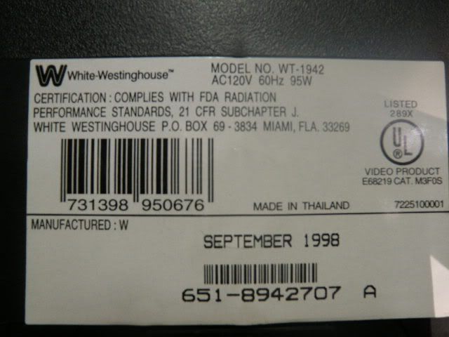

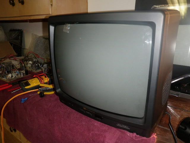

Here's my likely candidate:
It's a Westinghouse 19" TV, model WT-1942, manufactured September 1998.

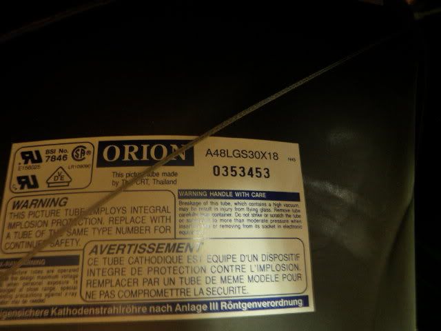

After removing the back of the TV and looking for the tube number, I see:
That tube number, A48LGS30X18, is found in the B&K rejuvenator setup guide charts (click here) and lists as the correct heater voltage (6.3) and correct socket, a CR31, a thin neck tube with 8 pins.
I ohmed out the horizontal and verticals, and they're very close to my broken tube, so I may be able to get away with not having to swap yokes. I wrote down the ohm readings somewhere; when I get back to the workbench, I'll post them here.

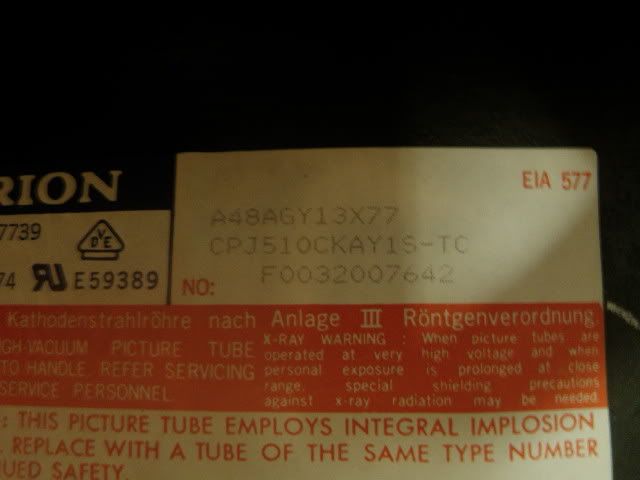

I also got a 19K4900 from a fellow KLOVer with bad Pac burn. I found an Orion 19" TV, model 1929. Took the back off that one, and yep, it's a CR-23 10 pin fat neck. Here's a shot of the tube sticker:
A48AGY13X77 shows up on the B&K chart as a 6.3v, CR-23. Good candidate for the K4900, but it ohms out around 14.4 and 2.5, so the TV's yoke is not gonna work with my K4900, which ohms out at 35 vertical. Looks like I'll be swapping yokes on this one.

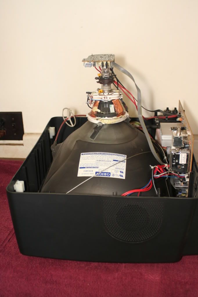

My Westinghouse TV, with the back off.

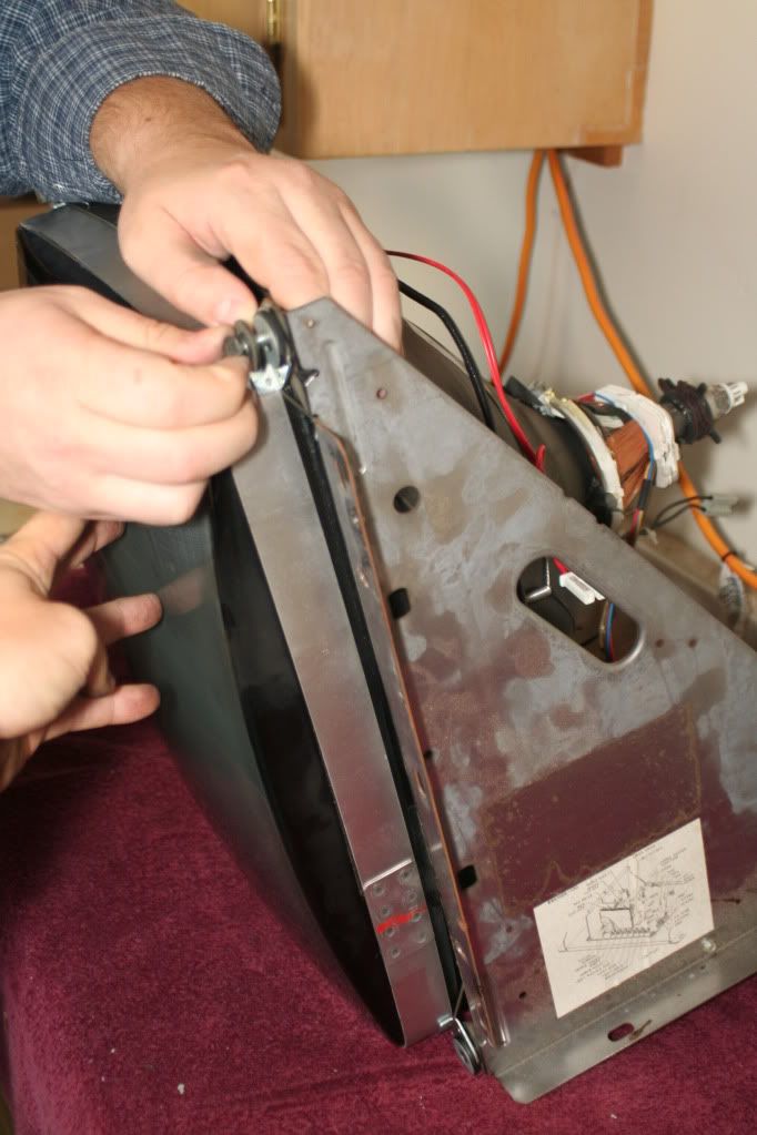

Bolting the TV's tube into the monitor frame.

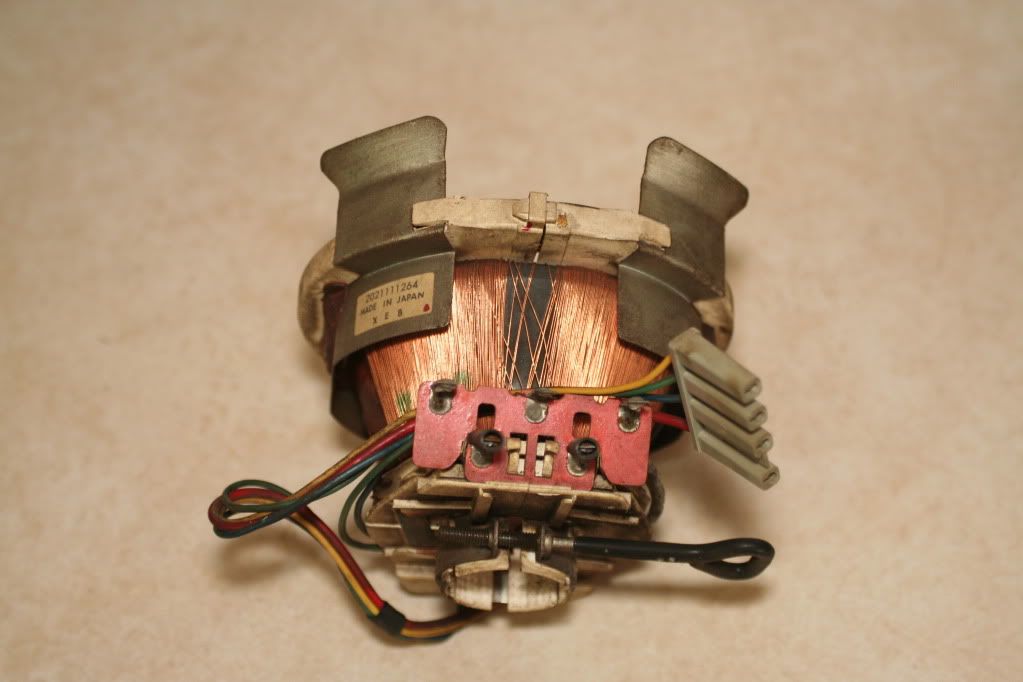

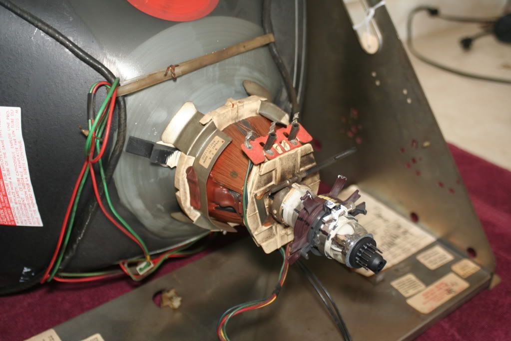

The yoke from my K4900, removed.

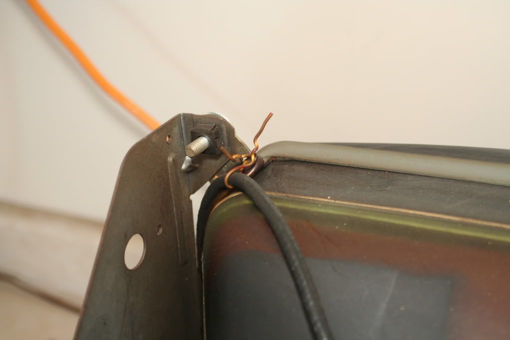

working on removing the degaussing coil and grounding strap. I ended up keeping the original degaussing cable, but I had to use the TV's grounding strap.

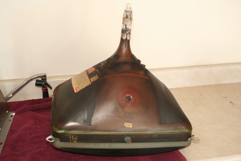

The burned tube, completely extricated :)

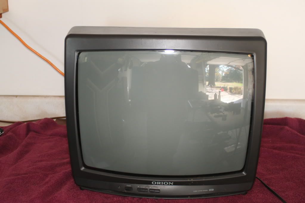

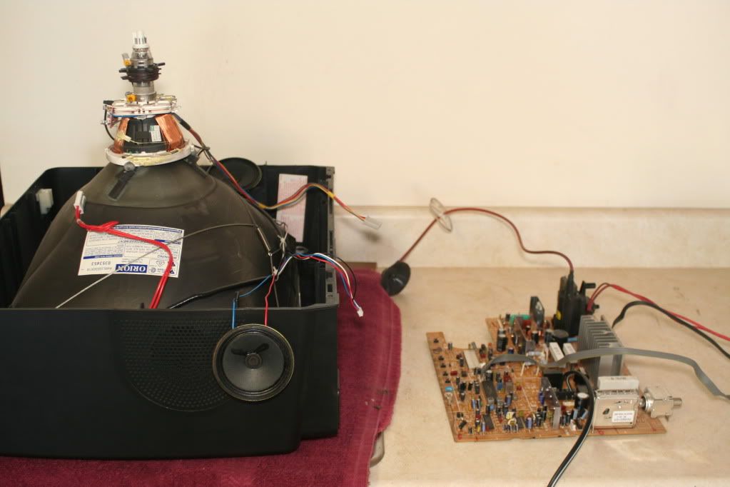

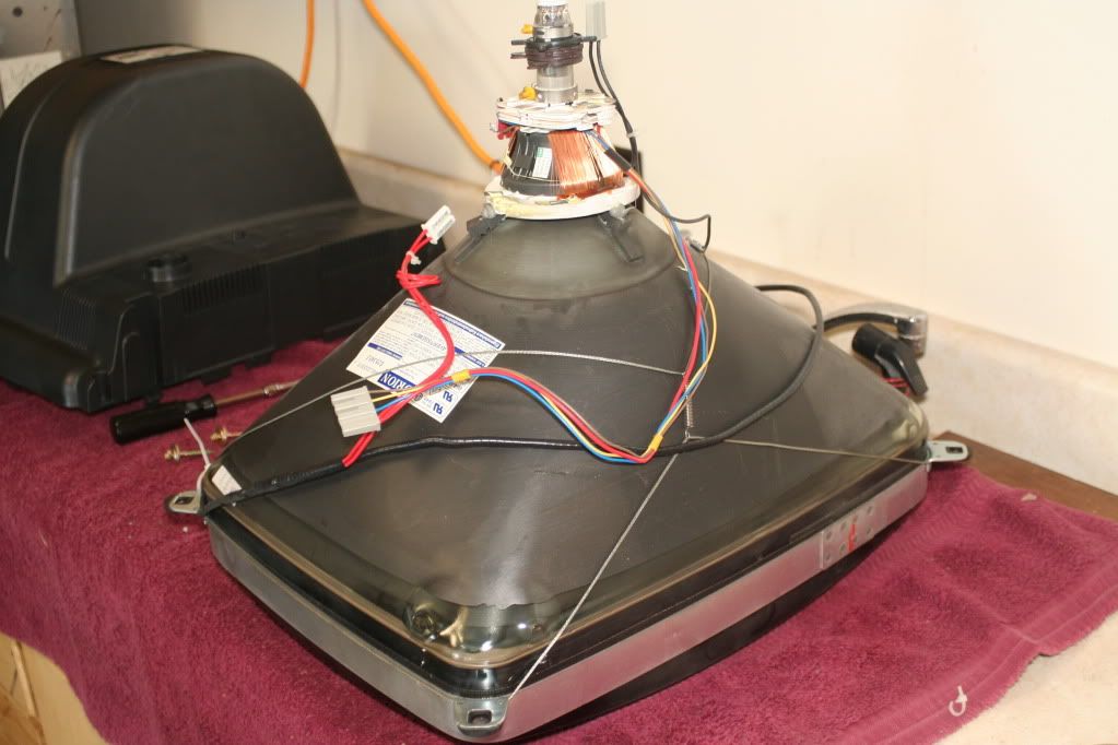

My donor TV, an Orion TV1929.

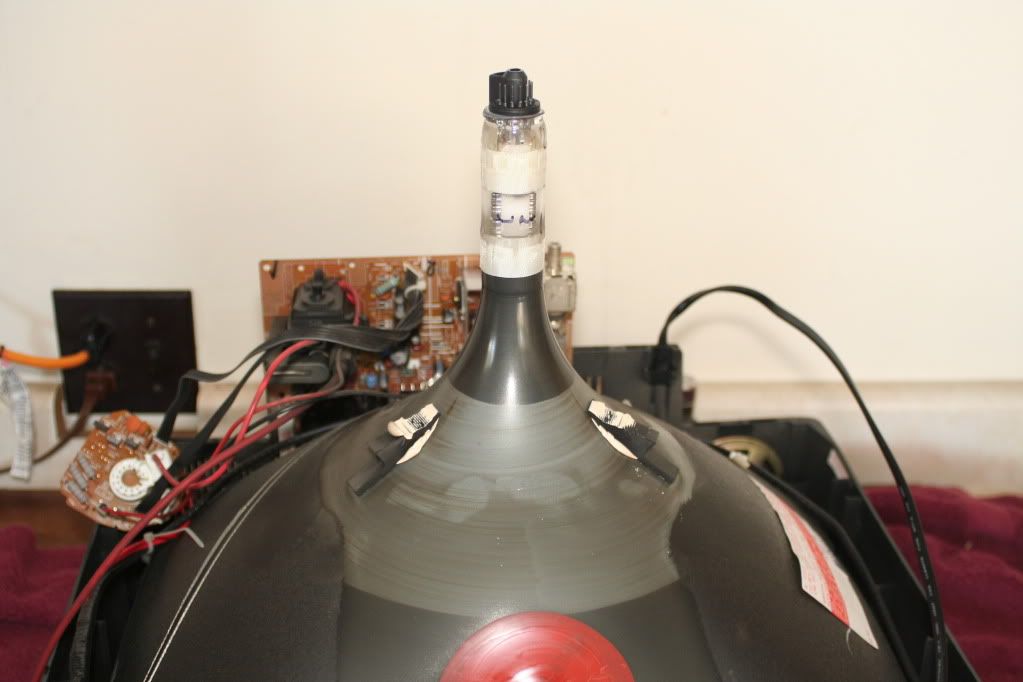

The TV's yoke, removed.

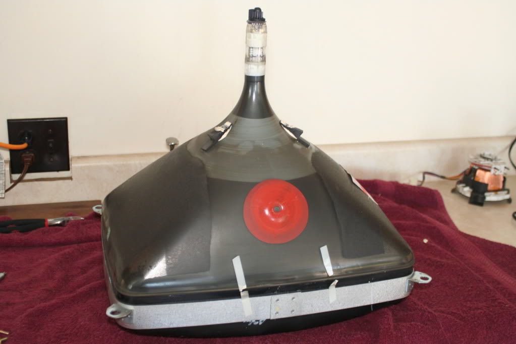

The donor tube, completely free from it's TV surroundings.

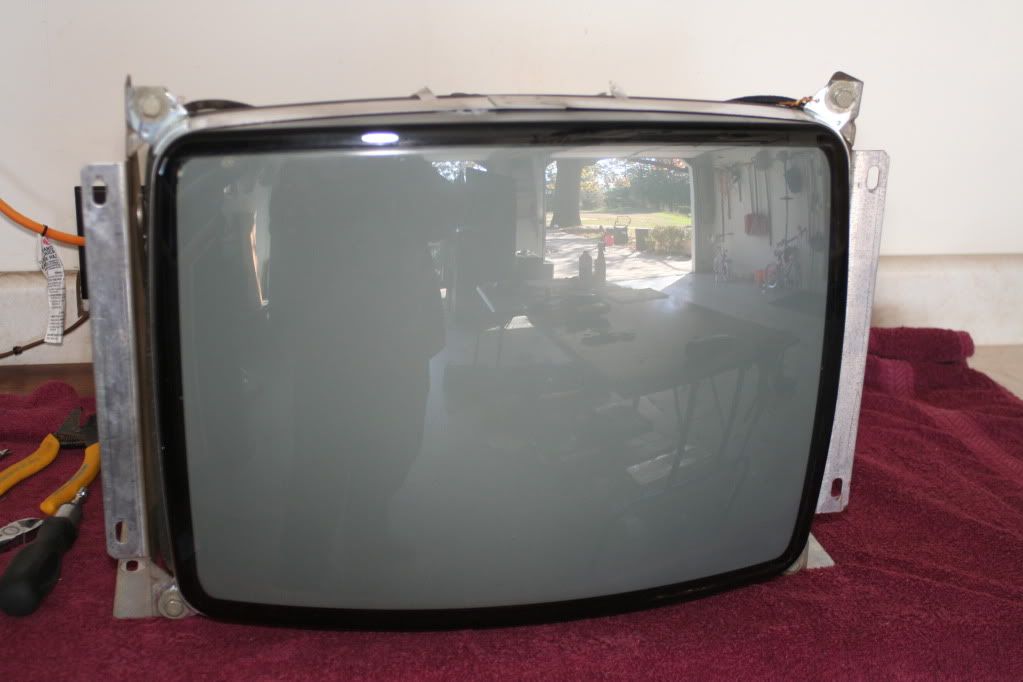

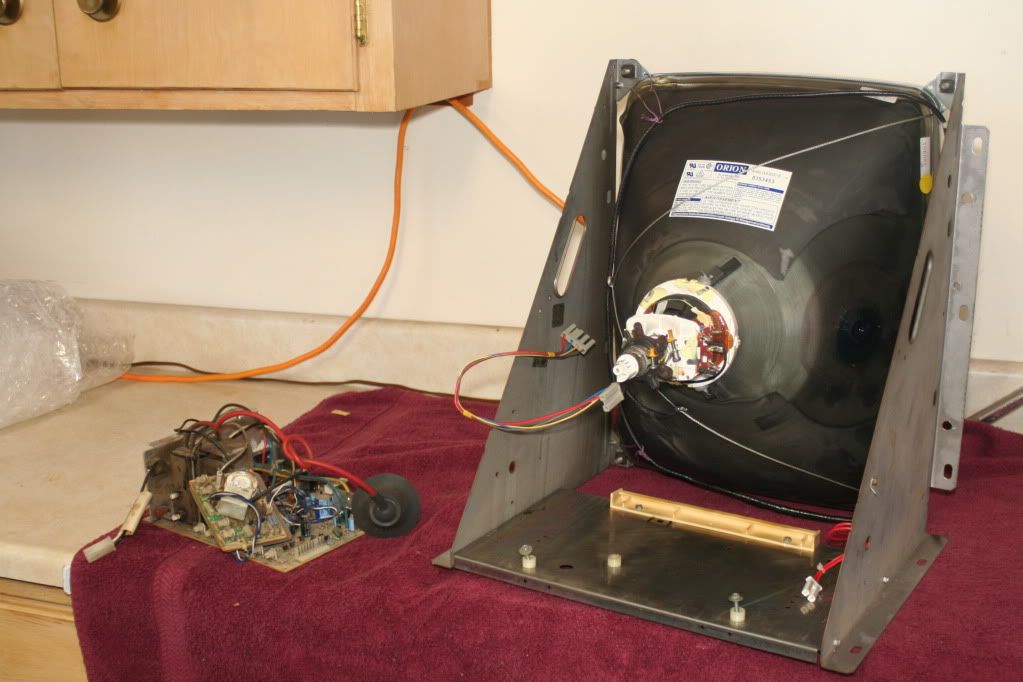

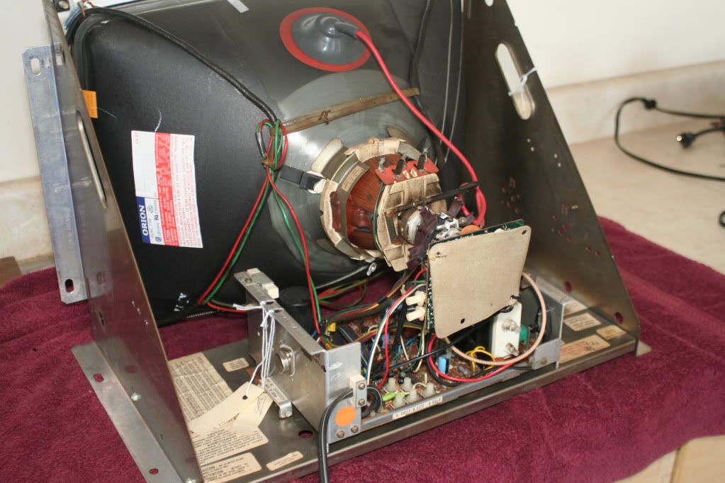

The new tube, bolted into the frame. I've already reinstalled the K4900 yoke, and here I'm ensuring the purity ring assembly is aligned to the marks I made before removing them. Remember, the purity rings stay with the tube, so these are the rings from the TV.

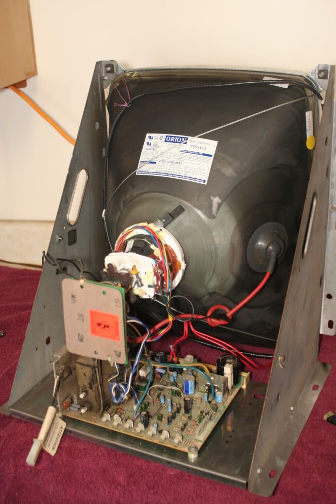

The chassis is installed, ready to go.
Done! Let's fire it up and see what happens!

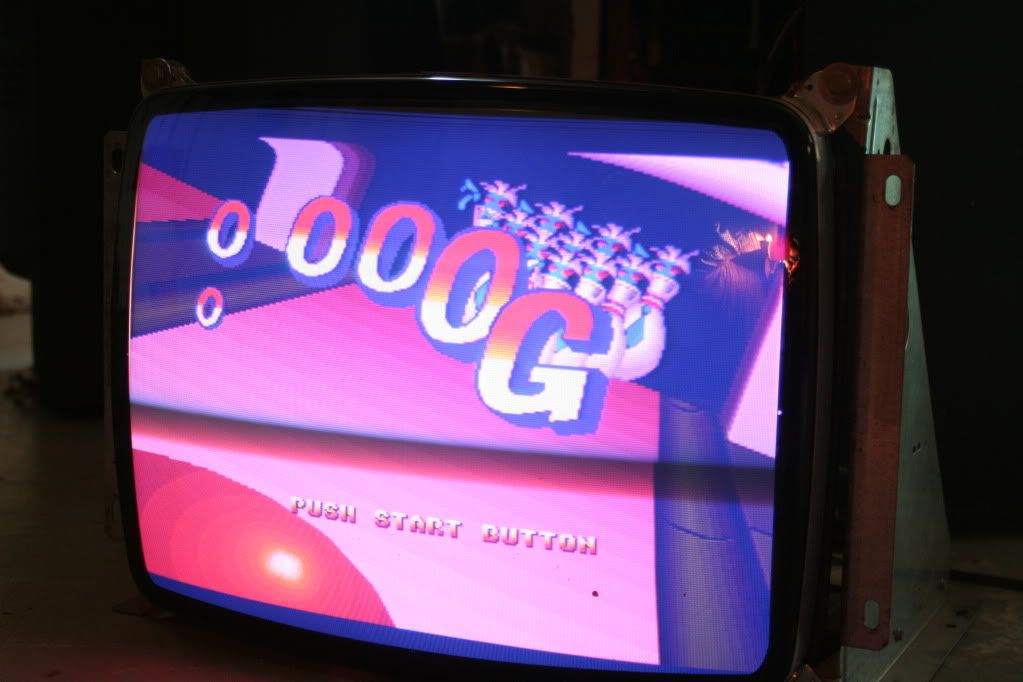

Not too bad! A little bit of color adjustment is needed, but I should be able to tweak the color pots to get a nice picture.
So, with that, I'm able to button up the Neo Geo cab, since I now have a fully functional, burn-free monitor in it.
