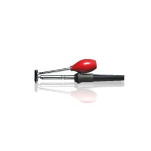

My Sanyo 20EZ cap kit arrived today, so off to the soldering bench I went. I must say, my recent purchase of a de-soldering iron was a very wise decision. What used to take me 3 hands I can now do with one. Very cool tool:
