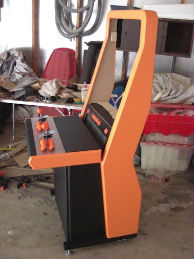

Started working on it sometime in may, took some time to figure out how to use all these tools right lol.
http://picasaweb.google.com/mariox2098/VewlixCustomSlim
Once i get the cash, I'm gonna get orange sanwa joysticks and buttons. The unpainted sides of the cabinet and the sides of the CP are going to be orange too. Il try and post new pics in the topic. Tell me what you think so far

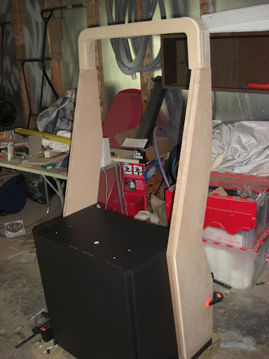

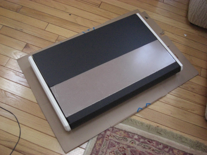

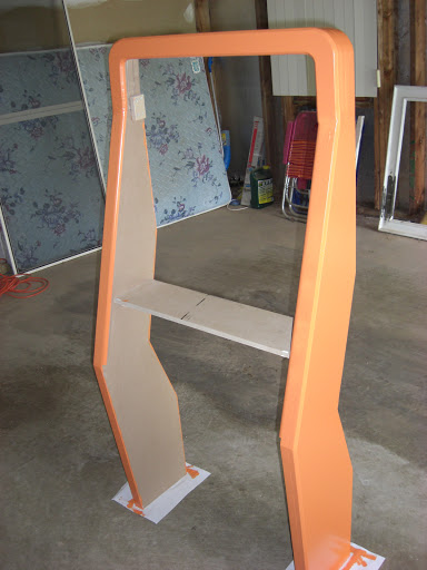

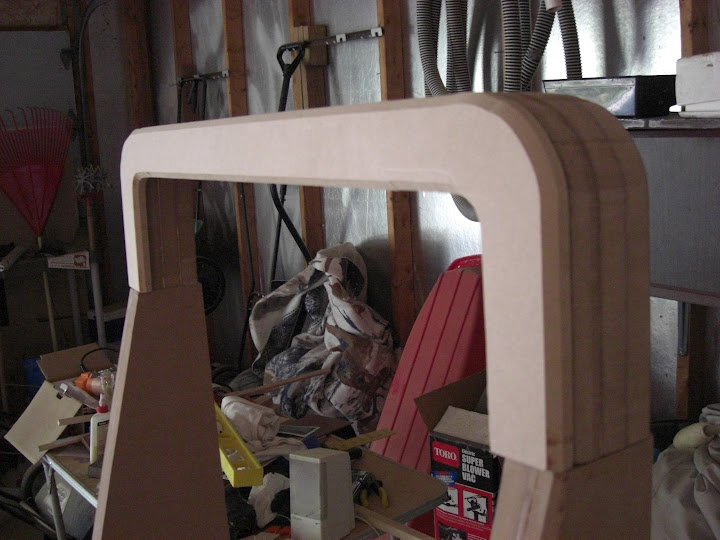

Top piece finally finished, this has been holding me up for a long time
So tommorow, i will be glueing it on top, applying bondo, sanding and then il be ready to prime and paint.
Also, I forgot to say before, my design is based almost completely off this one i found on the Shoryuken forums, incase anyone was wondering: http://forums.shoryuken.com/showthread.php?t=210552

« Reply #7 on: July 23, 2010, 10:25:00 pm »
is that four pieces of MDF glued together? Sucker must be heavy

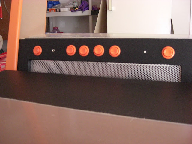

« Reply #13 on: August 17, 2010, 02:31:25 pm »

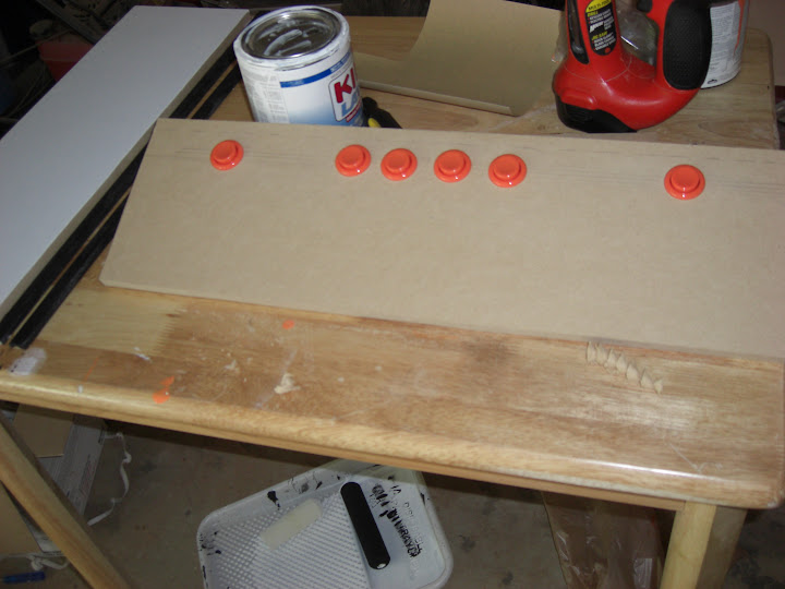

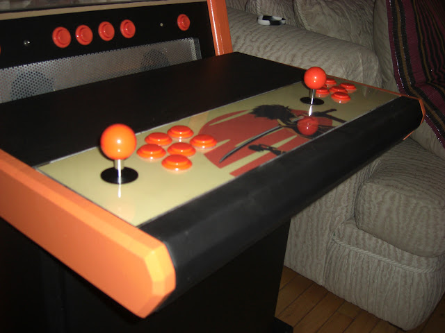

This looks AMAZING.  One question, though.  Is it just my eyes, or is the fourth button (third in the centre) of the Admin panel a bit out of line with the others?

« Reply #15 on: August 17, 2010, 02:47:47 pm »
Naw, its not your eyes lol, it is out of line. I realized that too after I cut the hole. Its not too bad though, right?

« Reply #16 on: August 17, 2010, 02:50:16 pm »
If it were me (and believe me, I'm irritatingly picky) I would be cursing and swearing, and doing it over.  If you don't mind it, of course, it's perfectly (as a friend's father once said) "within tolerance".  I love your work so far, and that's the only thing I really saw that stood out.

« Reply #18 on: August 17, 2010, 06:41:51 pm »
You can always over-bore the hole and push the button up slightly. The rim on the button would cover up the hole, so when it is screwed in, you won't notice it.

« Reply #23 on: August 19, 2010, 08:56:21 am »
Nice call.  Or you can put arrows all around pointing to it.  Make it look intentional.

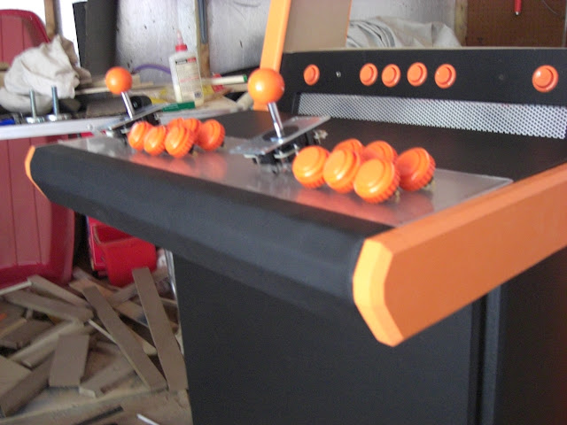

« Reply #24 on: August 19, 2010, 12:11:36 pm »
Looking great! Love the colour scheme and the control section below the monitor. Also jealous of the 2 player panel - gonna have to make another panel for mine ...... Keep the pics coming!
It fit two players surprisingly well, you should definitely make a second panel

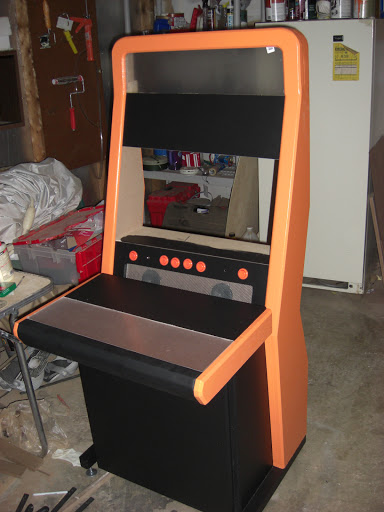

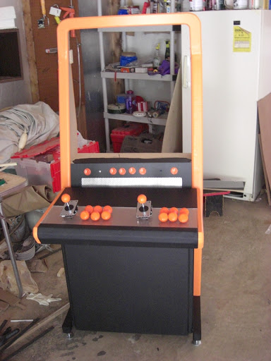

So i did some shifting and it seems like that button is lined up now lol

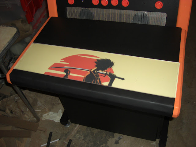

I also cut out the CP artwork finally. I might reprint it though so the orange in the sun matches the orange on the arcade. Im gonna print the marquee artwork later today.
just another more complete looking picture (still lacking a monitor for now)
Sadly, im goin back to school tommorow so that halts everything till thanksgiving break  :( but i will finish everything then. Thanks for all the feedback!

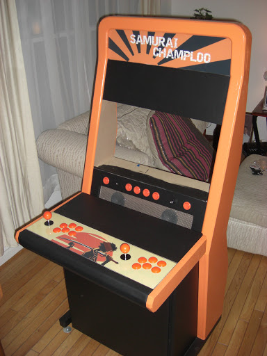

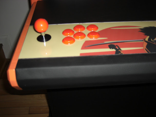

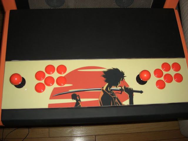

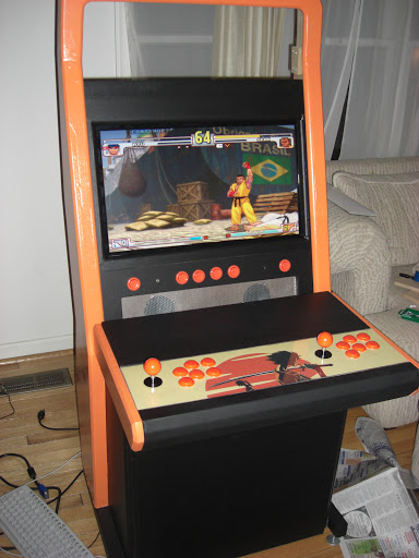

« Reply #30 on: November 23, 2010, 07:49:38 pm »

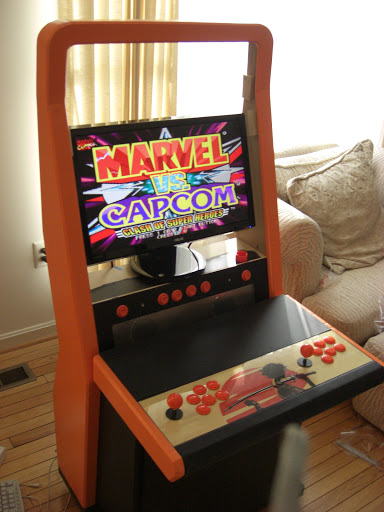

Back for break and finally finished the control panel! Waiting on my ipac now and hopefully il get the monitor i need on Black Friday. The pictures don't do it justice haha

« Reply #31 on: November 23, 2010, 08:29:25 pm »
That thing looks damn sexy man. Dig the Champloo CP as well.
Guessing you're looking at a 26" or so for the monitor?
What are you planning on throwing inside of it? Just PC or are you planning on wiring up a console as well?

Thanks alot! Yeh, a 26" will fit if i decase it but a 24" will fit inside normally. Im still deciding what to do. Theres just a PC inside for now.

« Reply #35 on: November 26, 2010, 03:13:29 pm »
Thanks for all the compliments everybody. This is the most completed picture i have as of now, still saving up for the monitor.  Going back to school again on Sunday so hopefully il finish it all during winter break

Looks good man! You mentioned a 26 inch decased tv/monitor. Definitely go for that if you can (seriously thinking about upgrading mine with one of those). Also, if you're going to drive this pimarily with an XBOX 360 or PS3, think about going for a 720p tv rather than full HD monitor - the image mapping is much better/clearer and the viewing angles for tv's on the vertical axis tend to be better than a monitor's (well at lest when I compare mine anyway). If it's just the PC that you're currenly using, that's a different matter.... (I was hoping that CAPCOM were going to relase all their games for the PC - SSF4, MVC3, SF x Tekken etc - looks like that's not going to happen now sadly  :'( )

Almost there, only a few cosmetic things left (mount marquee, cover up the back, etc.) Ended up settling for the 24" monitor, didnt feel like worrying over breaking something decasing it
