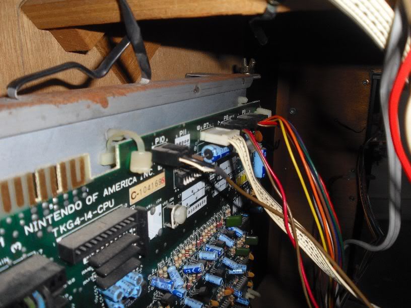

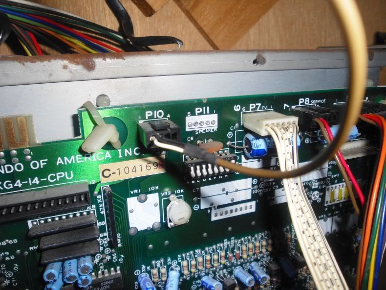

I have a Donkey Kong stand up arcade game I just got done installing a monitor for it but I'm missing some cables for it
i have the audio cable but I'm looking for the missing cable that goes here
And is the video cable on the same harness as the  highlighted part shows in this photo
 Thank You. Bobby M.

That connector is not in use when installed in a DK cab. Here are some pics of the cables and where they are connected. The one you don't see is the video cable, that one has to be connected with the video pcb (the second board in the board set).
It is also written down very well in the DK manual (see the schematics) which you can find for instance here: http://pdf.textfiles.com/manuals/ARCADE/A-J/

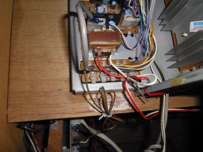

The cable that goes from  P7 were does it hook up at?
I took some photos of what I have
Thank you for this information.
Bobby M.

The cable on P7 goes to the monitor chassis. You can see it in the next picture:

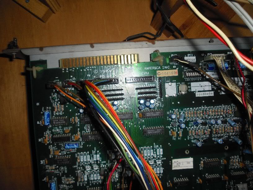

I have a wire that is hook up there already here is a pic of it

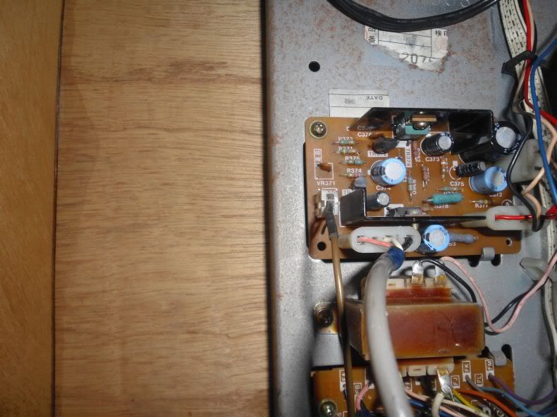

what is that little PCB on the metal shield for? I din't have that in my setup, as you can see here:
On my setup the P7 cable does go to the monitor chassis.
Is that extra PCB perhaps a video inverter to invert the RGB signals? I would be interesting to know which make and model your monitor is.

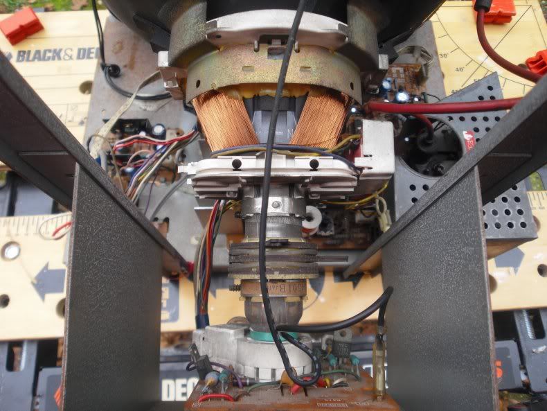

I'm not to sure what model but it does seem to be a rgb it is but I took a photo for you I just got it of ebay it said its for dk and dkjr the one i had before this one went out and someone said they might can fix it and took it than later said it was bad =\
If thats not the right info you need about what type of monitor it is can you tell me how to find out
this is my first time dealing with DK
and my lil drawing of whats on the board
Yes, that's an inverter board for use with standard games.
His model looks like a typical 20EZ. Some came with it, some didn't.
But you also need the single red power wire in order to use it for standard games.
In a Nintendo game like yours/his it's actually just bypassing that board and more or less going straight to the chassis in the same fashion as yours is without the board.
Non-Invert Out = Nintendo / Invert Out = Standard game
Long story short - Donkey Kong does not use the inverter board.
