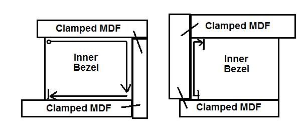

I would start with screws or L Brackets for your first time...make sure everything aligns...only use glue once you are happy with it...or for your first build just stay with screws and brackets.
As for your bezel. I wouldn't waste time using a jigsaw...go with a router.
Here is how I would recommend cutting your inner bezel.
1) Get the dimensions from your screen...place the screen in rough position and measure from inner side of cab to screen...top/bottom and side/side.  Pencil those dimensions on to the MDF bezel (1/2" is good).
2) Use a router flush trim bit with top bearing and clamp MDF along the pencil lines like so:
Working from the top left to the right in a clockwise motion to keep your feed direction proper (outer edge you would go counter clockwise).
3) Use 3 pieces of MDF as per the picture...starting at top left go to the line i indicate on the picture and then reclamp and go to the next line.
Once you have done this you will have nice straight lined inner bezel. You can then use a 45 degree angle bit and mold the bezel at an angle so it creates the illusion of touching the screen etc.
Same applies to your sides...only the top side becomes your template that you run the router along...going counter clockwise this time. You clamp them both together...always leave a bit of over hang on the 2nd piece (bottom piece) so the flush trim can trim it.  End result is that both pieces will be identical and line up properly.
« Last Edit: March 16, 2010, 12:40:41 pm by Epyx »

great walk through there on the Bezel, so I guess Im gonna have to wait til payday and get down to the pawn shop to get a router... :hissy:
How about on the sides of the box?  Do you normally clamp two peices of MDF together and cut at the same time or do both separately?
Personally...I do all my lines on the MDF first...then cut with a circular saw/jigsaw/tablesaw. Then I sand/fix imperfections on the first piece...the 2nd piece is then cut quickly with jigsaw, well outside the lines (1/8" etc)...then I clamp that piece on bottom or top (if you have bottom or top bearing flush trim bit).
The first one becomes the guide and trims the rougher one into an exact copy.
The more material your jigsaw has to go through (ie stacking them like you suggested) the more wonky your lines are going to be as the jigsaw blade will almost certainly do things you didn't expect...a line may look straight but halfway down the blade bent a bit and the side is no longer flush.
Definitely scour Craisglist or pawn shops etc for a router...you will see many common posts on these forums...they mostly all agree that a router is the single most important/flexible tool for a cabinet.
Each time you throw away wood is money you could have put towards a 2nd hand router  :cheers:
