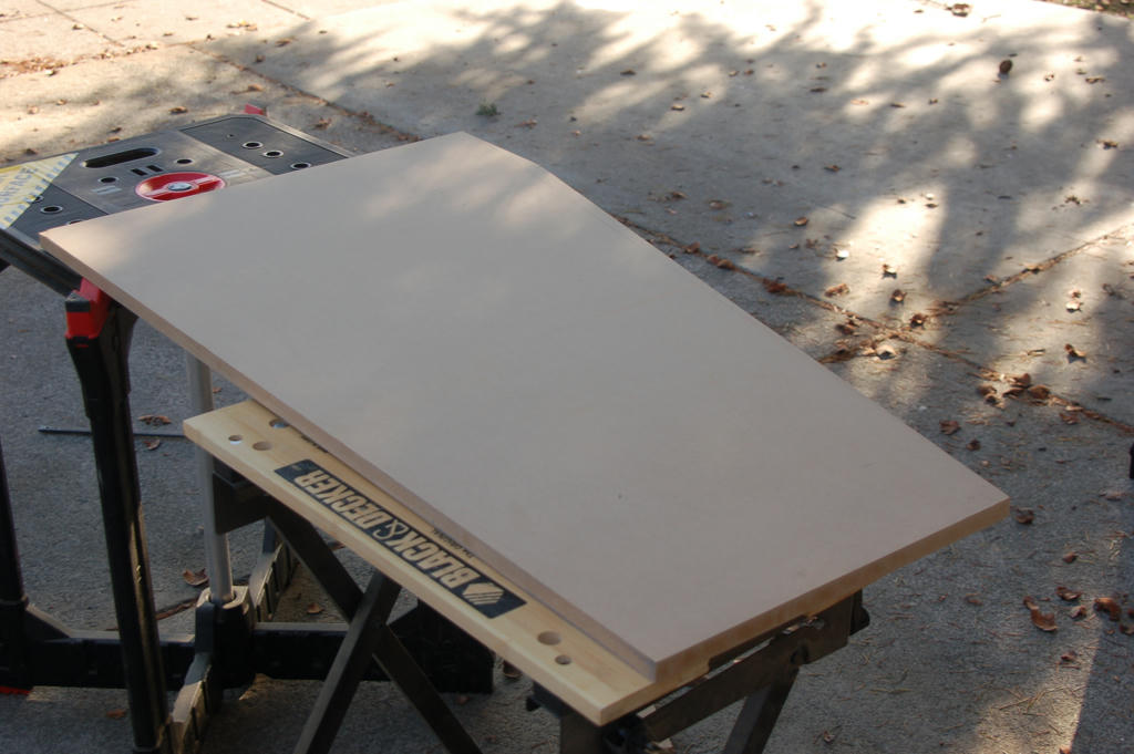

Hey guys,
I have been working for the past 3 months on my Visual pinball cab. I decided to wait to start a post because I wasn't sure if I could take this one all the way or not, but I have almost made it so I thought I should start my thread.
My cab consists of a 32" 1080p playfield, and a Dell 21" LCD monitor for the backbox. I am running an Intel Dual Core CPU, 4GB of memory, and a 9800GT 1GB graphics card. I also just swapped my 200gb PATA hard drive out for a 32gb Sata SSD drive, so no worries about hurting the hard drive if people are bumping the table. I am using an Ipac-2 to control all buttons, and have the plunger fully functional using a leaf switch wired up as normally closed (it works great!).
Initially I had the Nanotech Mot-ion plunger and controller board, but the calibration was complicated and the plunger worked on very few games. I gave up on that and switched to the Ipac for controlling buttons, and two plumb bobs to control nudging. After using the plumb bobs for a few days to nudge the ball (that works really well) I decided I don't want people shaking around my cab with two LCD monitors inside. I decided to switch to two nudge buttons that reside next to my flipper buttons. It works just as well, and I don't have people slamming my cab around.
For now the cab is painted black, but I have some ideas for artwork and will be inlisting the help of someone from the Hyperpin forum to design my art for the backglass and the sides of the cab. I love the Lord of the Rings pinball, so my theme will be similar to that cab, however I will call it "Lord of the Pins". I installed two red LED fans inside the cab, and two red cold cathode lights underneath, so it gets a cool red glow under it while it’s on. (you can see it in the youtube vid I linked below).
I am 90 % done with the project, I just need to get a back door fitted to the cabinet, and plexi for the backglass. Then I will order up my artwork and that will be it.
Here is a Youtube video I posted prior to installing the playfield plexi, but it will give you an idea of how the cab looks and functions:
And here are some pics from the build and a few of how it looks right now:
The first cut:

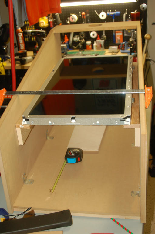

Assembling the bottom and side:
Test fitting the playfield:

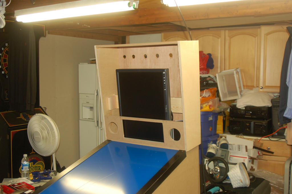

Attaching the backbox

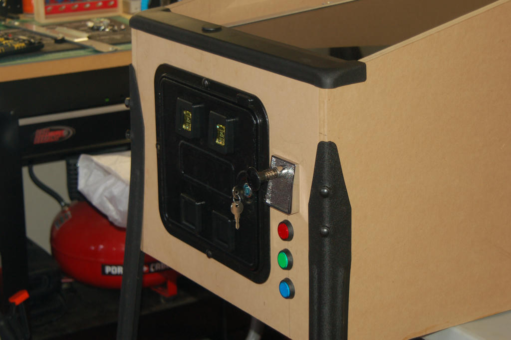

Test fitting the coin door, lockdown bar and buttons

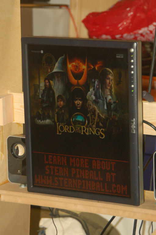

Backbox monitor:
Test fitting the DMD panel
