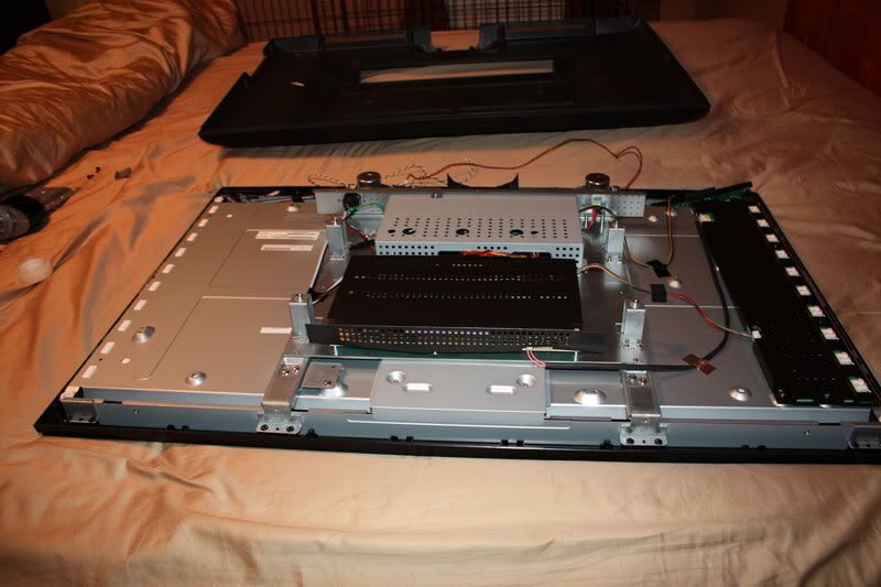

Anyway, my biggest dilemma has been the playfield monitor. I decased the 40” last night, and I BELIEVE that I’m going to be able to fit this into a 22”(ish) box and use a standard lockdown bar. The LCD measures 21-5/8” width decased, and 37-3/8” long. I’m looking at using ¼” “Plytanium” plywood (from LOWES) for the sides, so the total width of both should be 22-1/8” wide. Terry from pinballlife.com (great folks) provided me with the INSIDE measurements of a standard Williams/Bally lockdown bar: 22-3/16”. This will be CLOOOOOOOOSE, but I think I can make it work (maybe a bit of creative routing). We’ll see…

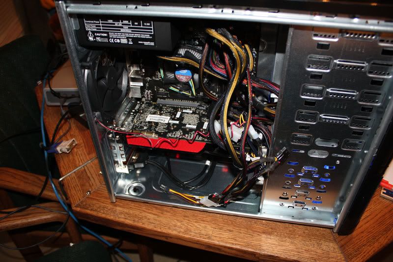

I’ve put the PC parts into a cheap mid-tower case. On my MAME cab I have the MB mounted with an arcade PCB holder, but I don’t like it that way for a couple of reasons: Grfx boards in PCI slots are wobbly: Screws etc. falling from work on other parts of the cab might land on running MB: RF interference will be cut down with a proper metal case. It’ll also be easier to work on the PC by removing it quickly and moving it to the bench.

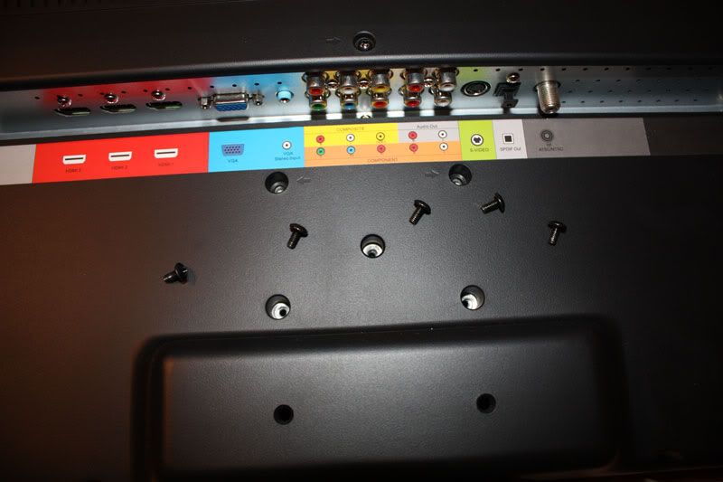

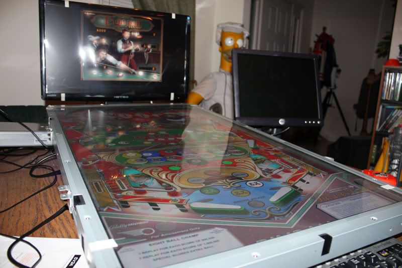

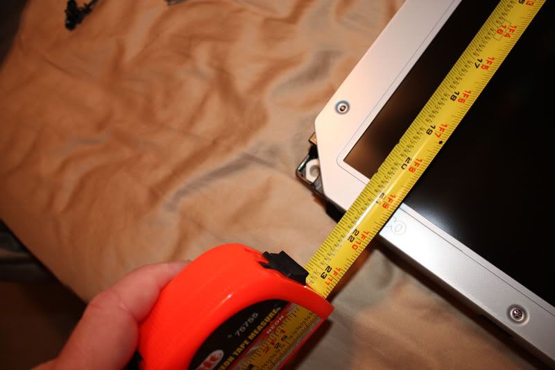

A few pics:
Here are a few pics:
mockup before decasing
The 'puter
Perfect surface to decase an LCD on!
Easy as pie
Almost there
All done
Length of the 40" LCD
Width
A tab that's in the way, but nothing a dremel can't handle.
2nd Mockup. I had trouble configuring my second NVidia card (an older 9600GSO 512K) for the third monitor. (Running 64bit Vista) I'll work on that later.
...on my way! :afro:

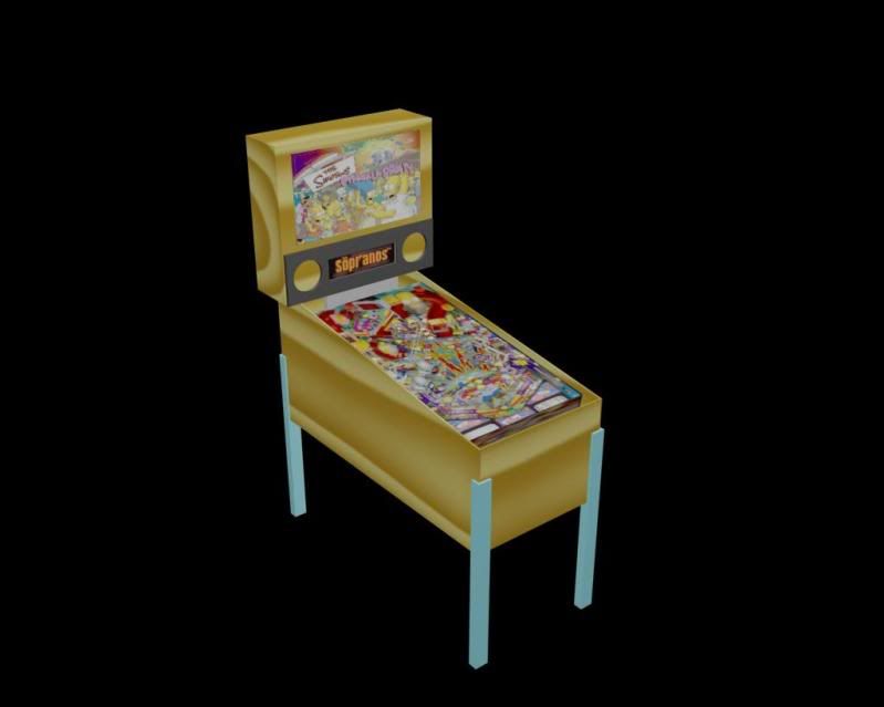

Super-quick 3dsmax render for layout/sizing.
I wondering about scaling the backglass box up (vertically) a bit so that the DMD monitor doesn't have to go down into the cab.
Any thoughts?

Yes, pretty much. I want as little a bezel as possible, since I think that just looks more realistic, as a pinball cab. I wanted to be able to slide the 40" down into the table a little bit, or else I would have done like some others have done and "rest" it on the top of the sides, which really cuts down on the bezel size. That way though, the glass sits right on top of the LCD, and my preference is a few inches of space between them, which gives a more 3D look.
And since I was going to mount it de-cased, I needed to get measurements ASAP to plan the rest of the cab. Hopefully my measurements of the 40" can help others in their planning without ripping into theirs right away.
As for the de-case, I tested the monitor for several days to try and make it screw up, but it worked fine. Also, the de-casing itself is so clean that I should be able to put it back together with no issues (although I'm sure the techs could tell, but there weren't any obvious stickers saying "WARRANTY VOID IF REMOVED" or anything. Of course, if I lop those metal tabs off, there's no going back... >:D
But yeah, it's taking a chance, and probably isn't for everyone. :)
