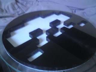

I was hoping to maybe make the Space Invader out of perspex and light it from behind somehow,  but then again maybe i'm getting out of my comfort zone.
Maybe something like this? ;)
I'll shoot you a PM as I may be able to help you.
Thanks for the offer Franco. Your cocktail is an inspiration to me. I followed your build very closely and showed it to many of my friends. I'll hit you up for some advice when i get the build under way.

« Reply #37 on: February 16, 2009, 03:17:09 am »
Small update,
I got myself some 24mm Seimitsu buttons from Chad at Lizard Lick Amusements and i thought they might look cool if i could light up the clear plunger from behind.
I'm reasonably happy with the way it turned out and i think i'll definitely go ahead and build it in to the machine when i start it.
So the following pictures are how i got on.
