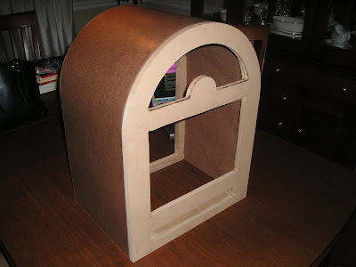

Here's where it starts to get fun (sort of - more on that in a bit).  Once the Griffin Powermate arrived I was able to take the measurement of the diameter of the knob [1-11/16"] and make sure the openings for the marquee, monitor and speakers were laid out properly.
This part of the project is very very complicated. Not only do I have to cut out the openings but after I use the template to cut the 1/8" black plexiglass (which will be the front face of the jukebox), I have to remove additional material behind the openings in order for the monitor, marquee and speakers to fit. This is going to be especially tricky for the monitor because the mounting brackets are at a different height so I'll have to set the depth of my router to be as precise as possible.
The first section to cut out must be the curved marquee opening. In order to cut out the curves perfectly you need a pivot point for the circle cutting jig to turn on. If you cut out the monitor opening first there won't be any place for the pivot point!
In order to cut this opening accurately, I used my router, a 1/2" dado bit, a straight edge and my circle jig. It was quite complicated to set everything up and I had to make 4 passes with the dado bit removing about 1/8" at a time to cut through the 1/2" MDF.
I really like working out in the garage with the radio on or whatever (although the Mets bullpen makes me mental) but I was at the end of my rope when I was cutting this out.  I messed this up on my first try - I couldn't seem to control the router properly. I lost about 4 hours worth of work that I had to make up just to get it to this point.
Here is what the panel looks like attached to shell. Pretty cool!
Next up is the other openings and cutting everything to size.   :cheers:

Looking real good javeryh.
Make sure that you write down the distance between your two center points as well as each radius. It will come in handy when you go to make the jig for the marquee plexiglass as well as the artwork.  ;)

That's a great idea.  I've already had to remeasure those distances for various reasons.  I'm a little nervous about the marquee art lining up perfectly but I think I'll be OK as long as I don't have a background that follows the curves exactly.  I have NO IDEA what I'm going to do for artwork or a name.   I've been kicking around a few ideas but nothing has stuck so far.  My favorite band is Pearl Jam so I was thinking about a subtle reference:

  • Posts: 7994
Re: Someone call the cops! I stole a Jukebox!! [09.15.08]
« Reply #78 on: September 15, 2008, 08:27:54 pm »
Here are a few shots after I cut the openings for the monitor and the speakers to final dimensions. I used a 3/4" pattern bit (for most of it) with the router and ran the ball bearing along a straightedge.
This was quite tricky to accomplish. There wasn't much room to clamp down the straight edge so I had to get creative. Check out this clamping nightmare:
After I finished the edges, I cleaned up the corners using a Japanese hand saw and some sandpaper. Finally, I went over the interior edges of the entire panel with some sandpaper to make sure everything was exactly flat with no noticeable bumps in the corners or anything. This panel will be exactly what the black plexiglass looks like when it is cut so everything has to be as perfect as possible.
More later.   :cheers:
