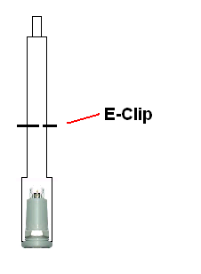

The problem that has been bugging me is to get a socket down the shaft for the jack to plug into. The e-clip groove diameter is 5mm and so the maximum size the socket OD can realistically be is 4mm. I'm not sure how Bender managed it but he did somehow
I have been having a bit of a think this morning and I have come up with a solution which will suffice my needs.
Since the e-clip groove is the thing causing the problem, I'm going to remove it completely. This gives me the whole 9mm of the shaft OD to play with. I'm going to drill and tap a thread in the bottom of the shaft for one of these coax power socket to screw into:
I can then just use a small washer between the knurled end and the end of the threaded shaft (where the nut is in that picture) to act as the e-clip which will keep the spring in compression and will keep the shaft in place.

OK, can anybody get his hands on one of these?
What is the diameter of the thread?
I also thought of removing the e-clip gap and give the shafts the maximum of diameter (what fits though the stick from above). Then the bottom of the shaft is hollow and has a thread to allow the jack to be screwed inside the shaft. For replacing the e-clip you could use a ....erm.....
What about that?
OK, the problem would be to find a jack that is thin enough for the 9mm-shaft  :-\
edit: I attached a picture that shows what I mean...
« Last Edit: July 17, 2008, 09:26:54 am by Luigi »

Yeah thats the setup I was thinking about.
I had a major calculator malfunction tho  :dizzy:, that socket I posted wont fit as the OD is about 11mm.
I don't think the jack you posted will be small enough either, there is a similar version on the page that Twin x posted and the OD on that is also around 11mm
The data sheet PDF is [here] if you want to have a look but it doesnt give any relative dimension for the jack you are looking at.
I think we may have a problem finding a 4 pole socket under 9mm  :'( The problem is that the shaft has to slide through the joystick from the top.
A-HA!!!!!!
Actually, if we used an larger e-clip or similar in place of the retaining collar in the center of the shaft we could make a shaft with a larger bottom section to hold a 4 pole socket!  :)
Kinda like this (paint skillz ahoy!):
The shaft would then enter the stick from the bottom and you would put the e-clip in place. It may mean we have to modify the spring retainer (or make a replacement) to keep the jack inside the body of the joystick (so not as to make it any longer) but its definitely possible.
Twin-X

Why not tap the outside of the shaft (and shorten it) and tap the inside of the bigger tube to fit it over the original shaft. Shorten the spring retainer and the outer shaft can be the clip that holds the bottom of spring.
I hope i am making sense.
erm...I'm not sure if I understand what u mean  :dizzy:
Franco's idea is brilliant: instead of removing the e-clip gap we place it in the upper half so the shaft doesn't fall through.....simple and brilliant...the hollow shafts are your baby, Franco...so go on :)
If you start making those shafts it would make sense for make them for 4 pole sockets....if people only need two wires....ok but they have the opportunity to "upgrade" without replacing the whole shaft.
« Last Edit: July 17, 2008, 11:17:37 am by Luigi »

Cheers buddy, It seems like  it should work. Ill get working on a prototype this week. I emailed Calrad earlier today about their UK/Euro distributors so ill get hold of a couple of sockets and have a play. I'll let you know how I get on.  :)

Finally I can offer controllable 5mm-RGB-LEDs (common anode for use with LED-Wiz), prepared to fit into the balltop. Including wires and resistors (120 for green/blue, 100 for red). 5 Euros/each + shaft and balltop (if needed)
Franco B
  • Posts: 3766
Re: Offering drilled (hollow) shafts for Joysticks
« Reply #33 on: September 23, 2010, 04:11:58 am »
Good work Luigi  :cheers:
What did you do in the end? I did some ones for Haruman and I ended up making a shaft with a 5mm bore, M8 thread and opened the thread in the bubble tops out to M8.
Luigi
  • Posts: 612
  • Collecting/restoring cabs
« Reply #34 on: September 23, 2010, 02:17:36 pm »
I tried some things to have the connectors inside the thread but it always ended with damaged isolation of the wires and so there was a short and some LEDs didn't work or even died.
So I tested how deep I can drill the balltop and finally had the LED sit on top of the thread :)
Of course the LEDs have to be modified so they fit into the balltop.

Since people keep asking me I have to point out that I NEVER had hollow shafts for U360 !!
With the wires coming out on the side you have to take care of the fact that some people twist the stick while playing.....don't know how to avoid that.

I am fairly new to this stuff but have a quick question.
I am in the process of buying 2 seimetsu ls32's.
Can I buy these, get the shafts from luigi and install the led myself?
I will be using 2 blue bubble tops with a white led hopefully.
I read somewhere that the bubble top might need to be drilled aswell?
any advice appreciated.
I basically want to add 2 blue led seimetsu's to my setup.
Thanks
Sham.

I'm sorry for the delay people. Haven't had much time recently.
I have only a few JLF-shafts left.
@push2reject: I might have two JLW-shafts that were ordered but never paid...I'll take a look.
www.arcadeshop.de should have some LS-32 shafts left...he bought some of them from me a while ago.
@sham69: of course you can do them on your own. Just solder two wires to the LED (cut the connectors to 3-5mm) and isolate them with shrink tube. YES, the balltops MUST be drilled! There has been a batch of them with open thread so the LED would shine through without drilling (if you put the LED completely inside of the thread!!). Otherwise you have to drill them (3.2mm) to make room for the LED. Be careful not to damage the thread!!
You can see a picture of two balltops here...one drilled, the other one not.
http://www.thludwig.de/arcade/galerie/index.php?gallery=LED-Sticks&image=gewinde_offen_gebohrt.jpg
