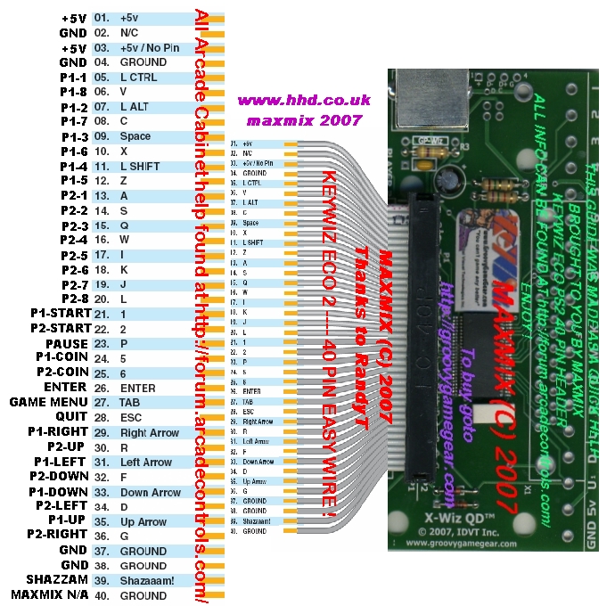

Well thanks to Randy I've come up with this, to help all involved with Keywiz Eco 2 inc IDE :)
Enjoy

Thanks :)
Well hopefully it helps somebody... Certainly a little easier having a printoff of this next to what you are soldering :)
I'll update the (Pic) V C X Z A S Q etc's to what they actually are tomorrow.... ie 1P UP, 1P DN, etc....

I thought one payer up/down/left/right connect to the pins marked up/down/left/right arrows?

I was just using them as examples.... Anyone want to run through the letters above and I'll update the diagram again.... Like to hear from someone whoi uses these...
There are some i'm not sure about because of the Shazzam etc....
ie
P2 Button 1 = A
P2 Button 2 = S

I have a diagram somewhere with all the pins identified for mame, I will have to find it and post it later.
BTW, great work on posting this info, I could have really used it a couple of years ago when I  wired my first eco2.

That would be great... I just dont want to fill in the A,B,C 's etc wrongly... If you can email me the
info with what all the letters and numbers equate to I'll modify (For the last time lol) the pic again...
either to maxmix@tiscali.co.uk or hd@hhd.co.uk or just send it to both lol

Nice - when I got my Keywiz a year ago, I did a continuity test to get the pins right, this is much easier!

Well here we go... Revision 3 of the picture and special thanks to 'DaOld Man' for some more diagrams....
I managed to convert them easily.... Going to run through about 10 button panels next week with my diagram lying next to me lol (Randy have you still got loads of these in stock ?) ;) (Should be around 15 mins each now :) )
All pictures updated....
Enjoy

Thanks everyone, this is Awesome!  I have my 40 pin wired up AND working properly.   :cheers:
