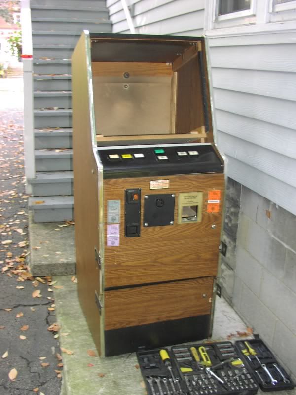

Cabinet

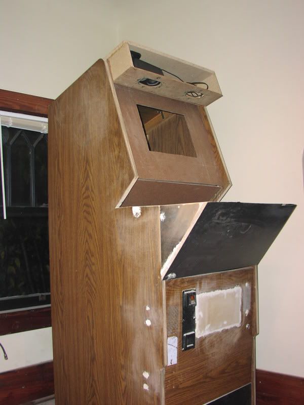

Picked up this old draw poker cabinet from a vending company down the street.  The cabinet was free since it was just heading to the dumpster anyway.  I actually laid the cabinet on a skateboard and pushed it several blocks to my house!  That was a fun experience in itself.
original cab
Roughed out modified cab
Current Status
I will be receiving the controls for this cabinet via usps this week.  I am putting in two 4/8way happ joysticks, six buttons for each player, 1plyr, 2plyr, credit button.  I will run the controls via GP-Wiz eco usb device.  I will also have a female usb input on each side of the cabinet.  The simple marquee art is also being printed on Backlit Film by Kinkos.
The entire cabinet will be sprayed with primer.  The sides and some other sections will be coated with spray on truck bed liner.  Black spray paint will be applied to other areas.

Interesting.....If it were me, I'd get rid of the marquee/speaker? box and mount them flush with the bezel, inside the cab. It just looks out of place to me  :dunno  The control panel design is different thats for sure. Looks like you could injure yourself on it!  ;D  I'll have to see it populated to get a better idea if I like it or not.

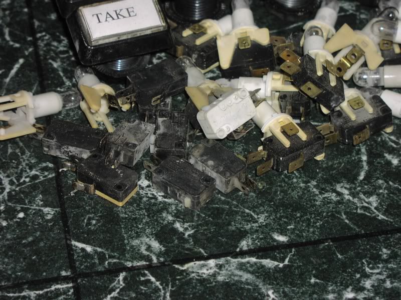

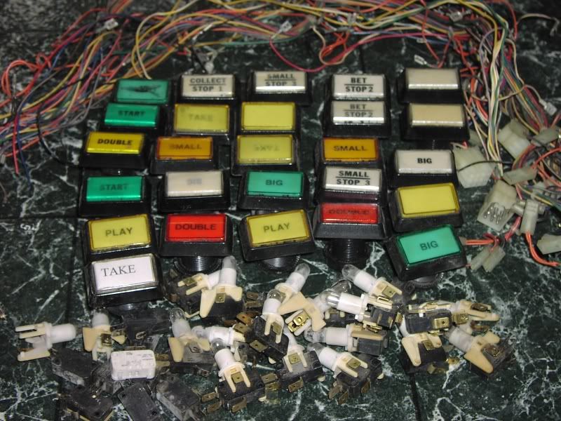

I realized that I didn't order enough buttons for the admin features.  I ordered one black button for credits, and totally blanked on pause and exit.  Well after calling around local shops, nobody had any round buttons to offer me.  No problem though.  When I got my free cabinet, I was allowed to canabilize parts from the other draw poker machines they were throwing out.  So I have plenty of buttons and switches.  I didn't want to use them due to their rectangular shape.  But I think three rectangular admin buttons would be a-okay.  I also will probably use the wire that I gutted from those machines to wire up my cp.
If you look close at the second picture you will notice the ever-ellusive albino microswitch.  It's a pleasure to grab a glimpse of thise freak of nature, usually only seen in encyclopedia entries.  ;D
One thing I also noticed was that my lettering on my marquee isn't big enough.  Too bad, as it's already being printed.  Next project won't be so rushed, and I might actually do some planning before jumping in!
Free buttons, switches, and wires
Albino microswitch
*edit*  I see that the white microswitch is a Cherry switch.  It seems to have a much better button action than the others.  Probably use this for the credit button.

Those 2 red ones could be your credit buttons. If you print out a 25 cent logo, it would look pretty sweet. In fact, it would look like this.
Aha! now I know what I can do with all them dang Trivia Whiz buttons.. thanks!

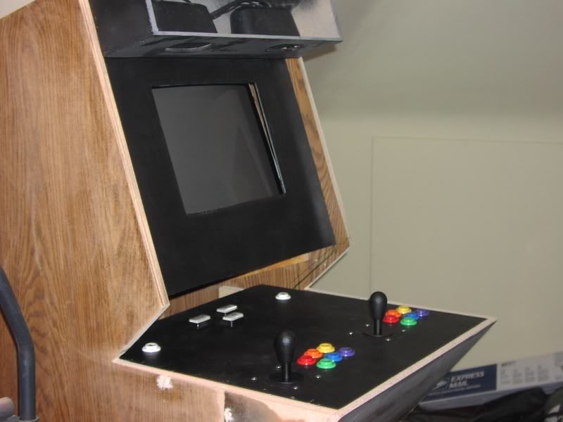

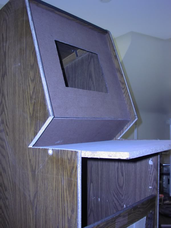

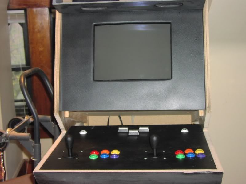

I received my joysticks, buttons, and gp-wiz eco in the mail.  I couldn't wait to get the entire cabinet done, so I put my cp together.  One reason I couldn't wait was that I ran out of truck bed liner.  I'm flat broke and couldn't afford to go buy a new can at $6.50 :(
I have been very pleasantly surprised with the bed liner.  The first couple coats kinda feel like sandpaper.  But if you get a fourth coat on there, it feels like textered molded plastic, Very nice.  Here's a couple pics of the bezel and cp.  There's a lot of dust....one thing my gf isn't to happy about.

1/8" masonite bezel
Bedliner'd Bezel
Rough/Finished'ish Control Panel
Green Giant

Looking good so far for a budget.
One thing I think you should do is switch the buttons around.
Make player one buttons green blue and purple and make player two buttons red orange and yellow.  Looks like skittles right now.
Otherwise keep working as you get more supplies.
Hmm, I could redo the marquee to read, "Skittle-Cade", and read, "taste the rainbow!" on the cp! ;D
That's some good advice.  I wanted colorful buttons, but the ROYGBIV setup is rather fruity.  I'll have to try out some other arrangements.  Your suggested setup sounds asthetically pleasing.  If I could go back, I would maybe just stick with red/blue buttons.  Since that is what my marquee is going to be.
On another note: not sure if anybody has done this, but I filled the t-molding grooves in with strips of cardboard.  Sanded them down, and will bedliner over them...We'll see how well that works.
