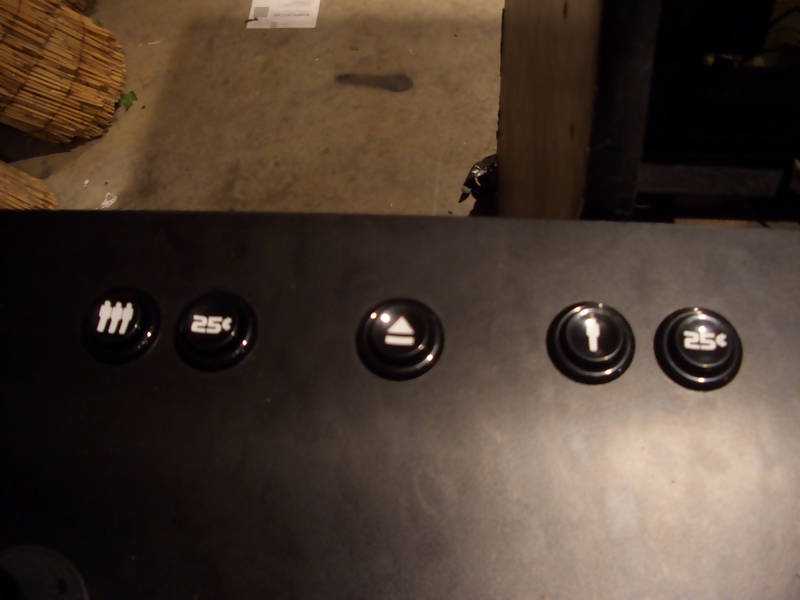

"Control Panel"
so, well i get my hands on this thing.
and I start monkeying around a little....
at this point i had only ordered 1 of the u360s "for testing" .. and i had taken one of the 7 blitz 49-ways out to check it out.... and was also experimenting with 1-led-per-button.... and hadnt gotten the rgb leds yet.
i thought that the 1 led approach in the ggg-ice buttons didnt make any sense..it seemed too kludgey/tweaky of an install....  and the intensity levels of the 3 colors of leds i had picked didnt seem to quite match.... so i ditched that idea and decided to go full bore with the rgb led's after all.   i figured the rgb's made for a cleaner and more functional install.... since the color/intensity could be varied in software and they came on nice little pcb's that snapped in.
so, i end up with 28 of these things.
and, well,  i start setting up the cp.
the cp has a cut out that works for a happ 3" but the  betson trackball is not fitting exactly.
this makes me take some time and look at things a bit....
i decide to turn this thing into some uber high ball.  so i leave the top cover off, make some nylon spacers to set the base so its just low enough to not hit those ggg upgraded stainless steel encoder wheels .. or the pcbs inside .. and mount the thing directly to the Happ steel plate .... and make some 'adjustments' to the cp underside cut out using a dremel....
and ... well, the cherry's on the main player buttons get substituted .. with these uber little guys (love them) ...

So.... I got this GREAT set of decals ...  from Pongo
( if you want some too they are here: http://forum.arcadecontrols.com/index.php?topic=64645.0 )
and start.. well,  sticking them all over stuff :)
here are all the buttons across the top of the panel .. (only other buttons are the 4 * 7-btn sf2/neogeo layouts)
3P start, 3P credit, EXIT, 1P start, 1P credit
VOLUME down/up, PAUSE (also used as shift for some 'advanced' keys;)), the modded GGG-TT Spinner, action button, mouse left/right btns
2P start, 2P credit, "service" button (F2 ... shifted is TAB for MAME settings .. which noone knows except its owner basically) .. and 4P start .. 4P credit
all the black buttons except for the 1 action button next to the spinner ... are connected to the IPAC-2 .. and use cherry microswitches ...
the 1 action button next to the spinner .. is wired to Player 1's U360 button #1 .. and uses a micro-leaf switch ..
so basically the only admin buttons are:
exit, vol down/up, pause .. and an unmarked button for service (F2) ..
the volume keys work off the "volume autohotkey" app ...
and the pause key acts as a shift .. so shift+exit = reset (F3), shift+service = mame config (TAB)
pretty simple.  regular people seem quite capable of understanding it quickly.  and no one has to hit any weird multi-button combinations.

I didn't realize black 1-4 player buttons were an option, where did you find those?
Your posts made me realize I may need another admin button or two, didn't add one for volume or F3.  I like the idea of a handy volume and I was trying to get away without the F3..some Williams games seem to require it.
metahacker
  • Posts: 166
  • Last login:January 17, 2024, 03:09:39 am
thanks everyone. :) :)
i got those by taking the standard happ black buttons.. and using this decal kit
although, if you just want the 1/2/3/4P start buttons and nothing else you could try these from lizard lick.
http://www.lizardlickamusements.com/pages/pushbuttons.shtml
you can also use a spinner  to control volume which is neat...
there is an app posted on the forums here called (IIRC) cabvol.. you can hold a key and spin your spinner/trackball to change volume.  its pretty neat.
i tried it, but ended up with the buttons for simplicity .... expecting a new user to know " hold this key while spinning the spinner " for volume .. i thought was a bit much when i wanted maximum 'newb friendliness'  in this particular application.... but its a really cool way to do volume.
and yeah i noticed that a lot of games (i.e. midway ... nba jam, mortal kombat, etc)  seem to need u to go into the service menu and turn the volume up the first time you load them ... things like that make that key more of a necessity than a luxury sometimes
