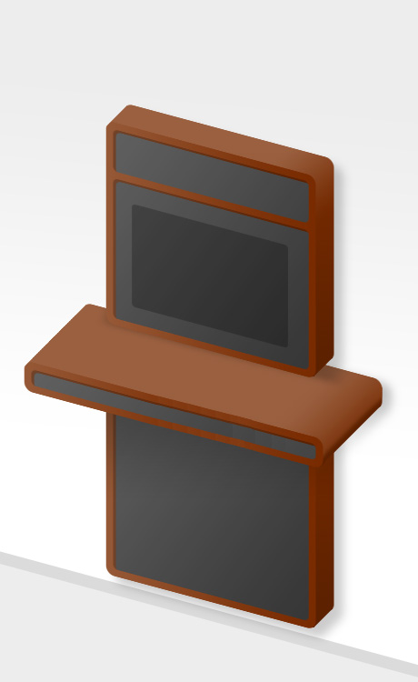

Hi everyone,
I have been collecting arcade games for a while now but never got around to building my own cab. I realized that one game I really loved was Dragon's Lair and always wanted to have one. I also wanted something small enough that my young daughter could play too. I started building a four foot tall (2/3 scale) Dragon's Lair.
Here's a pic of where I am today with this little guy.
I have been making lots of mistakes along the way. The biggest ones were the weird shape for the marquee and the monitor brackets. But, I'm learning.
Can anyone suggest how I should proceed with the Control Panel? I would like to make it out of sheet metal but I have no idea how to properly cut it (15 3/8" wide), bend it and drill the holes and mount it properly! Maybe I can make it out of wood?
Suggestions and comments are very welcome!

The marquee wood is cut at weird angles because both side (top and bottom) are at angle to each other and not perpendicular. They are also three sides instead of straight like most other games. I used the measurement pics on Jakobud's website for inital cutting and assembly. My first mistake was in the calculations I made to scale by .67 (2/3). I had to recut some pieces. Then when I tried to make the weird angles I messed up again and made them too steep. More cutting. Finally I had to use some trial and error. In the meantime I got a real Dragon's Lair machine and used that as a reference point.
I wish I would have taken more pics along the way. I also wish I had made some templates since now I would like to build some more of these cabs (the next one I will make some templates!!).
Here are a few more pics that illustrate what I meant above:

You can go to a local sheet metal shop and have them cut, bend and put the holes in it for you.
You will end up paying more for the labor than the metal, but worth it for a quality job.

Thanks for the suggestion. I have already asked two metal shops to do this kind of work and both have refused (they said I would need to order a minimum of items, 20 for one, 100 for the other!). I'll keep on checking other places.

Can anyone suggest how I should proceed with the Control Panel? ...
I'd go with wood.  It is more forgiving, and mere mortals have the means to work with it.  A lot of people have done great write-ups on the topic.  I'd recommend the following:
5/8" plywood with a 1/8" Plexiglas top.
3/4" tmolding that holds the Plexiglas in place.
Artwork done in Photoshop, or other graphics tool, printed either at a local print shop or one advertised at this site.
Artwork sandwiched between the plywood and Plexiglas.
Drill holes in plywood to match the artwork!  Not the other way around.
Good luck with it.

Well, I'm not going to build an entire cab just to get a control panel (but nice suggestion anyway!)
I think wood is the way to go here too. I will not be using plexiglass or t-molding as the artwork actually wraps down to the front side of the control panel (and I want to leave it that way too so it looks just like the real Dragon's Lair).
The artwork is done, I printed it on adhesive vinyl and sprayed matte clear-coat acrylic on it (I did the same for the side art, came out very nice).

I am back in business with the metal CP! I bought some heavy duty tin snips and it cuts the sheet metal like butter!! I got some metal hole drill bits and hope to finish it up by the weekend (like many of you folks, I only get to work on it less than 30 minutes per day (if that!)).
The metal is kind of thin (20 ga) so I think I will put some ply under the wood for reinforcements. Pics to come soon!

Can anyone recommend where I can get smoked plexiglass? And what type should I buy? I have only ever purchased clear plexi.
Thanks again guys,
Alex
I used a 20% automotive tint kit on my bartop plexiglas.  It is rather dark so I would recommend using the 35% as it is lighter.  Be sure to get the application kit as well, makes installing the tint much easier and you'll have a better end result.

I would recommend going with smoked/gray GLASS - not plexi.  It might cost a little more for the glass but it's worth every penny, IMO.  Plexi can scratch and just doesn't look as crisp as glass does.  The screen is the most important part of the cabinet!
Also, if you aren't dead set on a metal CP, I put an overlay on my latest CP that rounded to the front and I made the CP entirely out of MDF.  Here's how I did it.  Hope that helps.

javeryh, that is a fantastic job you have done with your machine! The control panel looks great. I will attempt that as well as the metal one and see which works out best.
The main reason I want to use metal is because of the shape of the control panel.
Here's a pic of Darth Nuno's Space Ace control panel (very much like the Dragon's Lair CP)
You can see how the top curves upward at an angle.
It would not be the end of the world if I cannot recreate this though, so if I get too frustrated with the metal, MDF it shall be!
As kentoad suggests I will be documenting my metal CP build and will post the pics.
Also, javeryh and kaytrim, I would prefer to use plexi over regular glass because I am building this for my daughter and don;t want any mishaps in case it falls over (or crumbles for that matter! Remember, this is my first build!).
I am not using a CRT but a 15" LCD for this very same reason.
