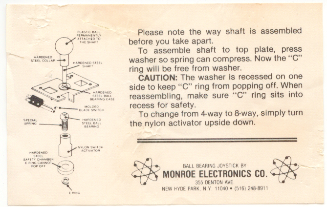

Here's one that you won't find on the Happ site.  I was going to post a Wico diagram as well, but I just noticed that it doesn't show the inside of the stick base, which makes it less than useful.  BTW, I really, really like the feel of the Monroe joystick (Gyruss, Time Pilot and Rampage), and it's made almost entirely of metal, hint hint.
« Last Edit: May 03, 2007, 01:38:19 am by Kremmit »
Wow.  So that's why the stick on those machines always felt so smooth.  It's such a simple design too.  The only part I'm having trouble with is the ball bearing case.  On the diagram, it looks like a washer.
I'll have to see about digging out an actual stick and shooting you some pictures.
i think the simplest way to get adjustable throw is to make a set of interchangeable restrictors. something like the u360, but with maybe 5 different sizes of circular restrictors, instead of just one.
You really need to see the other Monroe joystick design.  I don't have a diagram for it, but it incorporates a super-simple restrictor that can be changed out at will.  I'll have a go at pics of that one as well.
