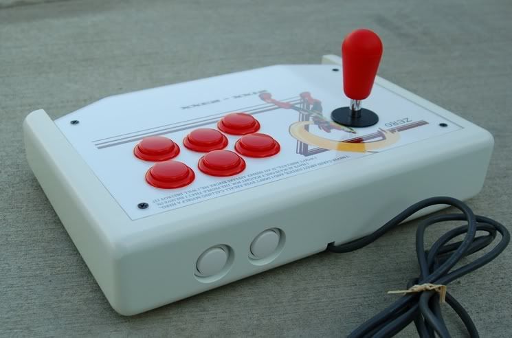

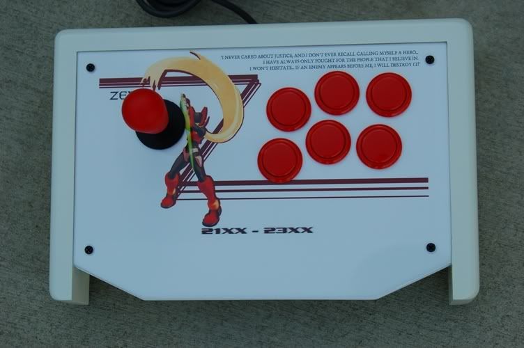

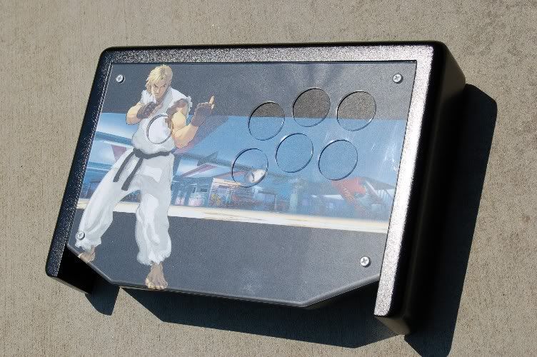

OMG Timoe  :o  those sticks are killer.  What are you using to get the print on the plexi?
Kaytrim
*EDIT, and where do you get the clear buttons where the artwork is inserted?
Kaytrim-
I am a general contractor and my signage guy has a plotter to cut adhesive backed vinyl or .......  PAINT MASK.  So I have him reverse whatever image I need and then he plots it on the painters mask and I apply it like a stencil to the plexi and spray paint it.
The buttons come from Ponyboy and are Seimitsu, they were special order though, I dont think he stocks them.  Akihabarashop.com sells them like hot cakes though
They are freagin tight.  You pop out the plunger and use your off cuts for your button holes and just squeeze the off cut into the plunger of the button and WHA LA.
Kaytrim
Kaytrim-
Are those paint masks reusable and what is the cost?
Yea I asked Ponyboy about those buttons and he said he dosen't carry them.  In your opinion who is a better source for the Japanese parts?  It seems like you have worked with both Ponyboy and Akihabarashop.  (btw what are the part numbers for those buttons?)
Thanks and TTFN
Kaytrim
Kaytrim-
Thanks and TTFN
Kaytrim
vinyl paint masks are not reusable, they should be relatively cheap, goto any signshop and ask if he can cut them for you, if you have the image in vector he shouldnt charge you more then machine time and material, and paint mask is pretty cheap (around 1$ a yard)
i also have a plotter/cutter and i could cut you some stuff but it would have to be a significant amount to warrant paying shipping
btw generally machine time is around 1$ a minute. but if the image is vectored it shouldnt take very long at all

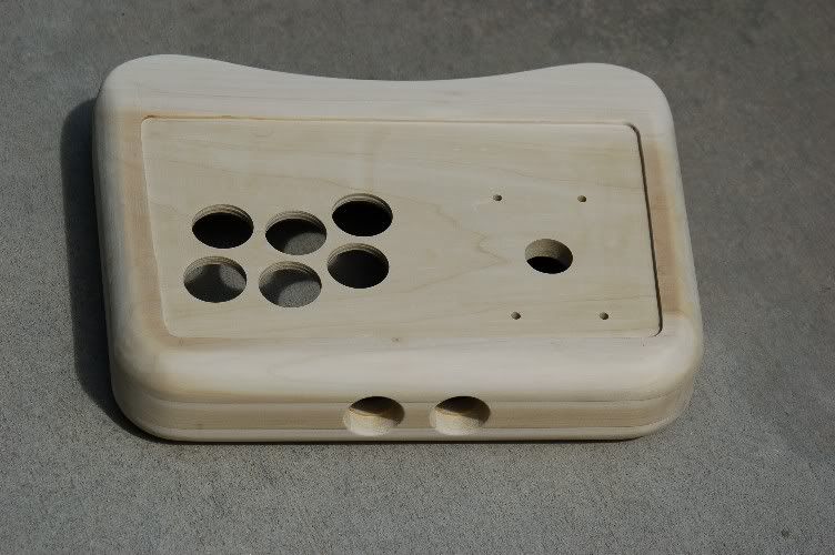

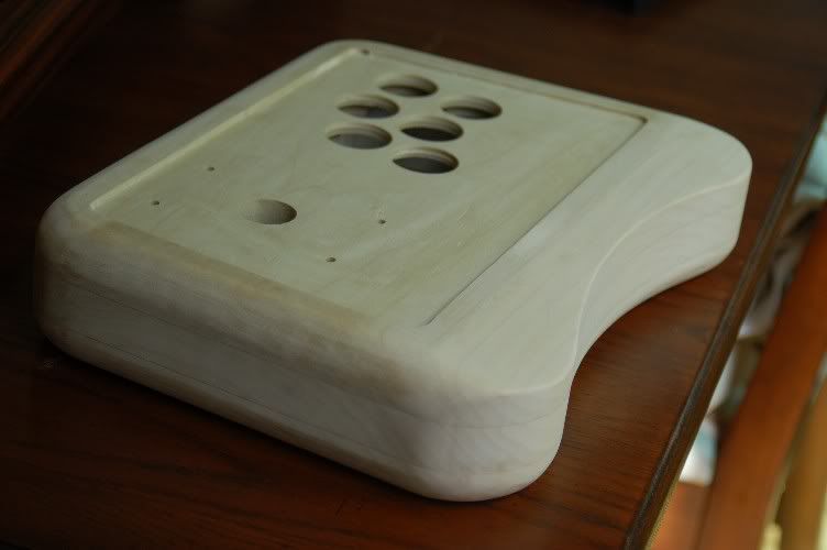

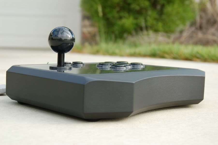

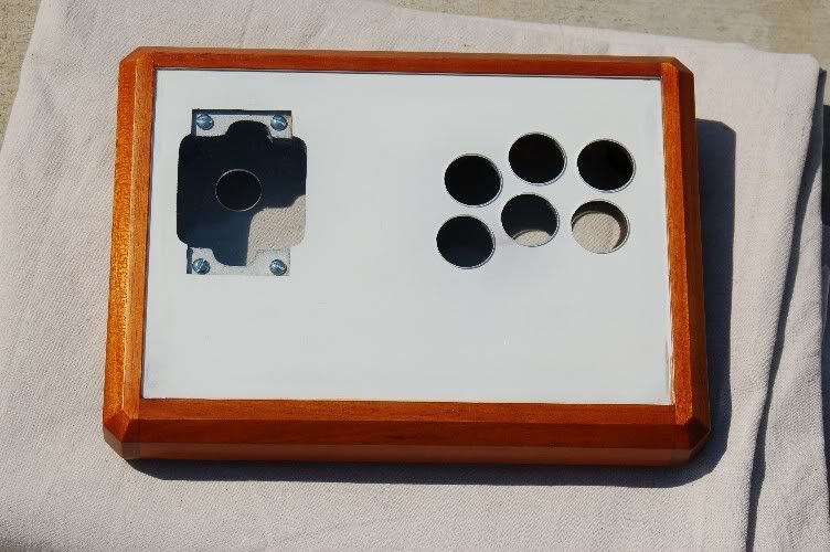

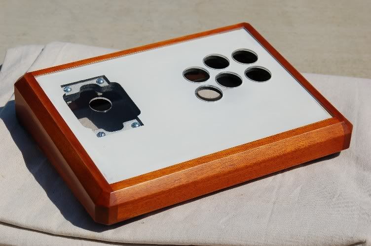

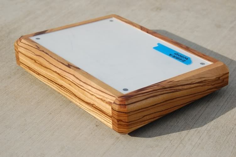

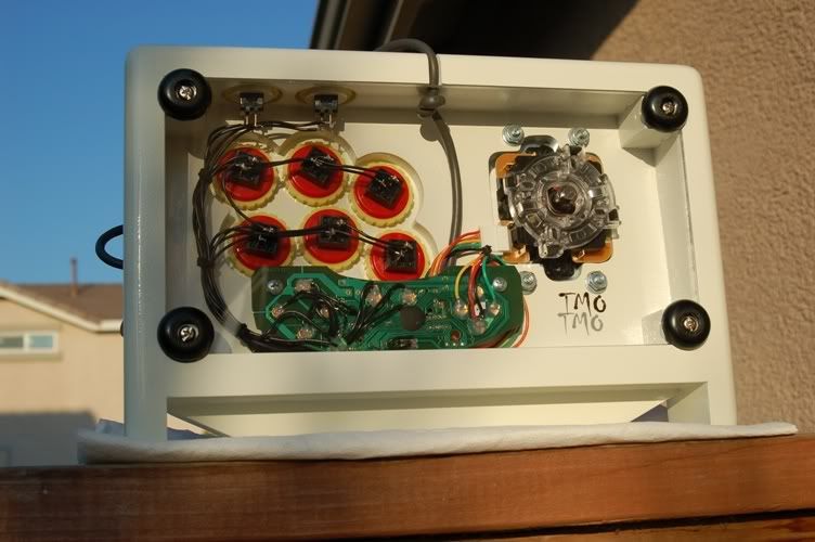

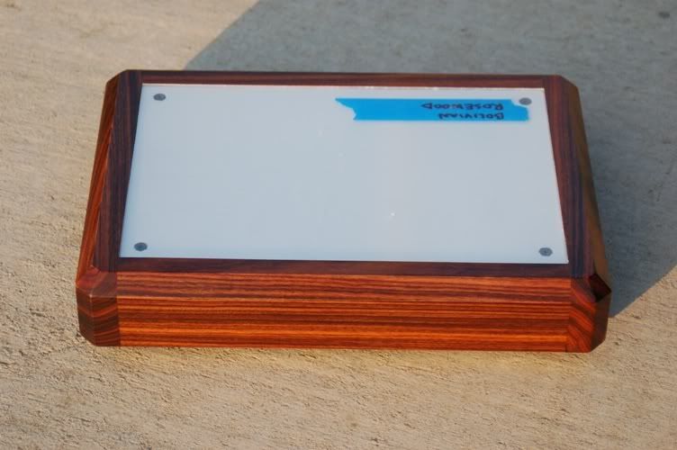

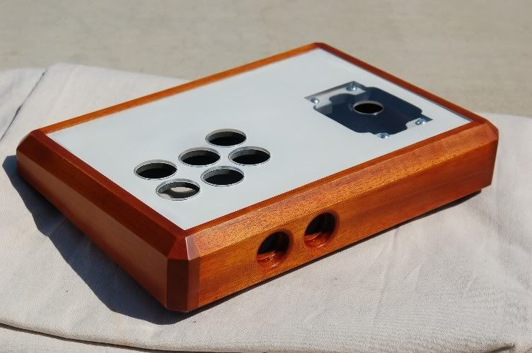

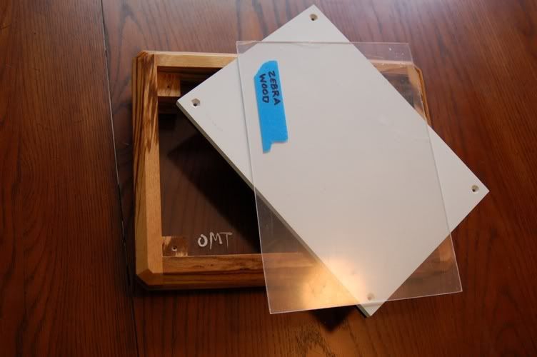

This one was fun to make.  I laminated 3 sheets of 3/4 mdf into a solid block and then carved this from it with my router.
MURDER BLACK
Specifications:
•Sony PS1 Digital PCB
•Sanwa JLF, Octagonal Restrictor, Shaft Cover & 45mm Ball Top
•Seimitsu Buttons
•Individual ground wires for easy button removal
•Routed from a single block of MDF
•Satin Clear Coat Finish
« Last Edit: August 22, 2007, 07:27:43 am by Timoe »

Holy crap Timoe - that is really a work of art.  How did you get such a nice finish on the edges of the laminated MDF?  I built a bookcase with a 1" top so I laminated two 1/2" pieces of MDF but no matter how much I sanded the seam I couldn't get it to disappear completely like you seem to have done... any tips?
Kaytrim
  • I'm too nice a guy
  • Posts: 2095
Re: Timoe's Mini Sanwa Sticks
« Reply #143 on: August 22, 2007, 10:07:04 am »
One word, Bondo.   ;D  At least that how I would do it, slather the edges with the stuff after general shaping then sand it down to the final shape.  Of course several layers of Kilz2 primer and a sanding could do the trick too.  Though IIRC Timoe does it another way but I'll let him tell if he wants to.  ;)
 :notworthy: Sweet stick Timoe.
Timoe
  • Posts: 1662
  • Team-Oh-tAy-Oh
    • Rattlin' Trash
« Reply #144 on: August 22, 2007, 10:38:57 am »
Thanks guys.  I just laminated the mdf, then rough cut it down on the table saw.  When you cut the laminated pieces, they end up flush and smooth.  After that I used a flush trim bit and a template.  Primer and paint.  Thats it.
I did the same thing with poplar and it came out just as well.
Kaytrim
  • Posts: 2095
« Reply #145 on: August 22, 2007, 10:56:57 am »
What type of glue did you use Timoe?  I am guessing you used strong clamps to get the boards nice a tight.
TTFN
Timoe
  • Posts: 1662
  • Team-Oh-tAy-Oh
    • Rattlin' Trash
« Reply #146 on: August 22, 2007, 11:32:44 am »
TTFN
TiteBond II and I go sorta crazy with the clamps :D

I hope you are using a respirator on when you route out that block of MDF.  And that you do it outside or someplace out of the house, that fine dust is killer. :dizzy:  Do you have any dust collection system setup?
There was a lot of dust The inside alone from that stick filled a trash bag.
But I used a large forstner bit to hog out most of the center so that it came out as curly strips of paper rather than dust.   :cheers:

Couldn't you do a rough cut of the MDF layers before you glued them together? For instance cut out the inner section of the bottom layer.
Thats a good idea.  But I just glue up a coupla blocks  and throw em in the corner of my garage.  I come back to them later and I've got all sorts of jigs that I just throw on there and I rip through the blocks with a big ol straight bit.
It goes pretty fast and easy.  You just gave me some new ideas though.  :D

Wow.. that last one is awesome. I mean, they're all awesome... but that one is.. more awesomer.
I think I'd go crazy with that much MDF dust flying around. You do have to think about your health.
I want to see you build a little cab for those sticks, now.  ;D

This one below was a ton of fun to make.  It was my wifes design:
