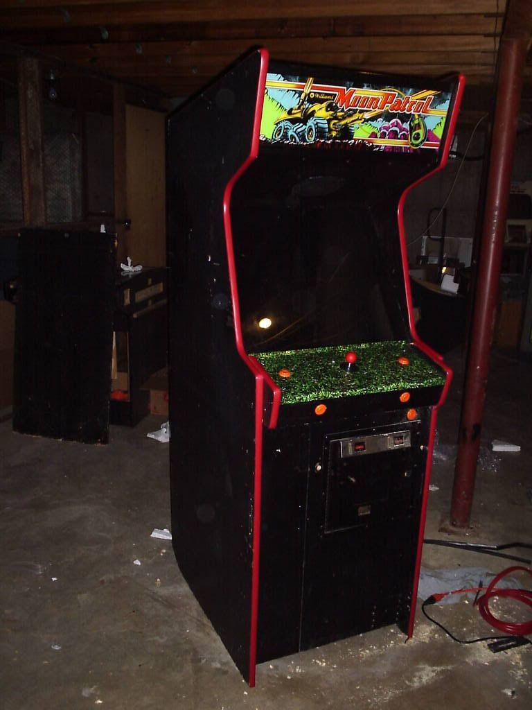

93 in 1 vertical 4-way cabinet. Only horizontal game on it is Moon Patrol (which I stretched to vertical). Only did that because Moon Patrol was the only marquee I had that fit the cabinet.
Total build time 5 hours, half of which was spent trying to get ANY vertical frontend to function. I finally got vertiwah to work.
I'll never see it again, it is going to Superauctions tommorrow.

I am not going to have enough time. I had to come up to the library to check something, so I figured I would post a picture of it. I still need to finish up a couple things (bolt the computer down, secure the innards etc), and I need to do them FAST cause Becky's birthday party is tonight.

Did you build this one just to auction?  And is that a Golden Tee "grass" CP overlay?

Yes, I built it just for the auction. Yes that is a Golden Tee overlay (I had part of one left, it was enough to cover the panel).
Their were 5 Mame cabinets at that Auction. Mine was the only one that wasn't a buyback, mine went for $550, the other sellers all bought theirs back. I also sold my Stunt Cycle for a paltry $120 (it was the LAST working game sold), and my Magical Touch for $125.
