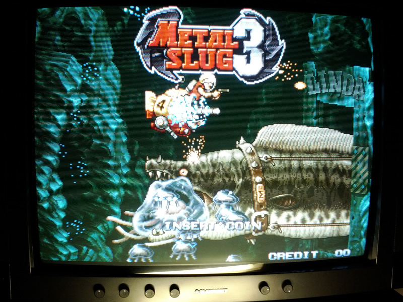

Jack
  • Posts: 22
  • Last login:March 07, 2025, 06:28:36 pm
  • See You Space Cowboy..
Re: How to setup CRT geometry with multiple resolutions?
« Reply #18 on: February 18, 2018, 04:03:55 am »
(the right side of the tv is squished)
I have this problem on my tv.. All i did was select the Arcade_15 preset, use super resolutions and then adjust geometry on the tv. So i didnt tweak anything with VMMaker etc. I know that the "problem" is probably just how my crt is.. but i'm wondering if i can fix this somehow. (like overscan with the tv geometry and then make some software tweaks to center the image back)
Thanks for the help.
Paradroid
  • Posts: 687
  • Last login:December 05, 2025, 10:28:19 pm
    • SCART Hunter
« Reply #19 on: February 18, 2018, 01:49:45 pm »
That's a horizontal linearity issue. Not uncommon.
Most TVs have some kind of control to adjust vertical linearity but I've never seen a TV with an adjustment for horizontal.
There is no fix for this. It's a completely different issue to overscan.
If it bothers you greatly it's time to start looking for a different TV or monitor.
