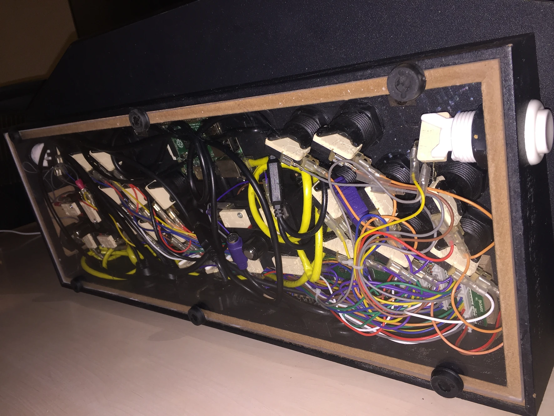

I opted to take my mod a different way. I jammed a raspberry pi inside to make the x-arcade a travel-worthy arcade. Been great to take to family functions and play all the oldies.
https://ribo916.wixsite.com/thebeardstale/single-post/2018/02/04/X-Arcade-Joystick-Mod
Nice job, recommended a friend do the same to his :)
