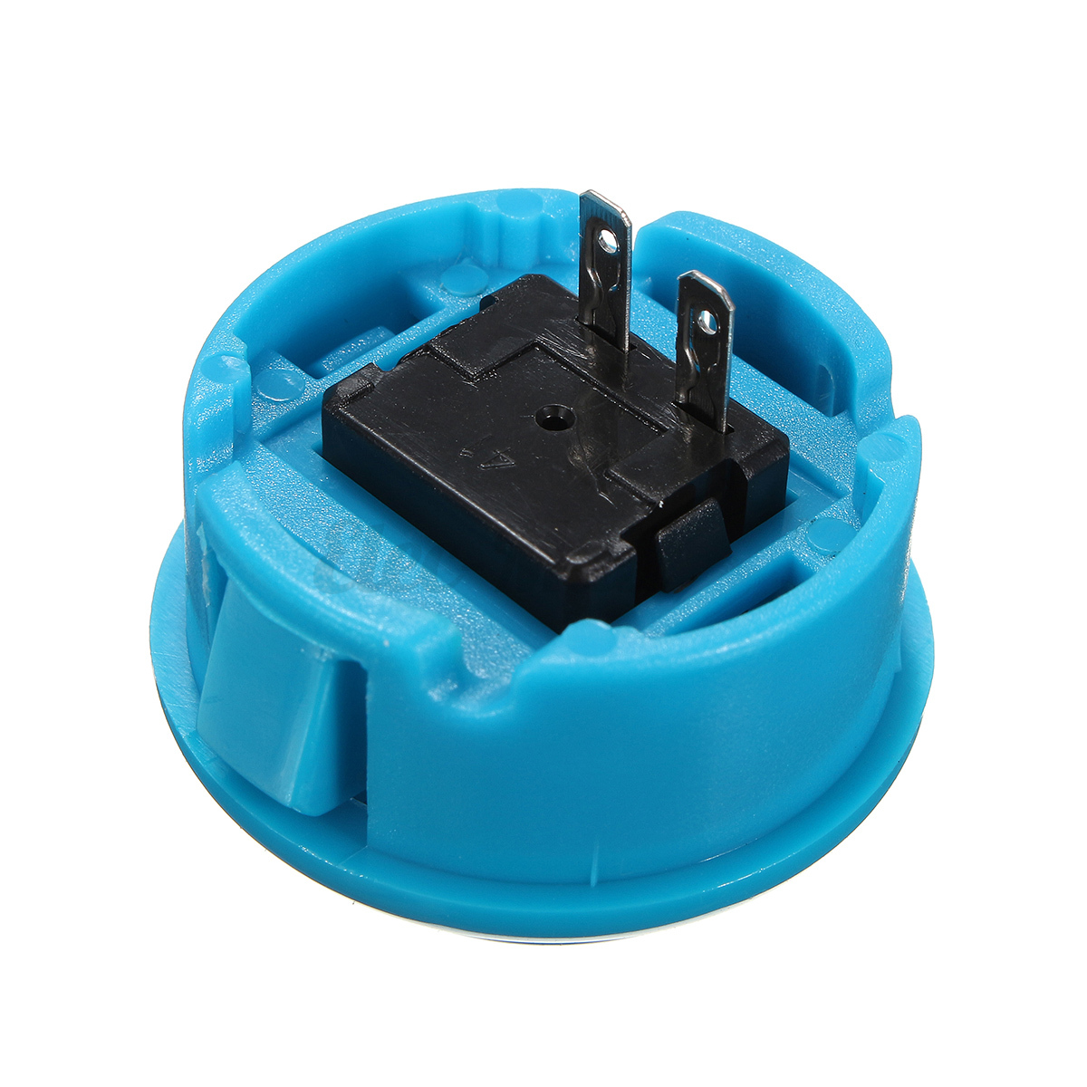

I bought this kit and I wished it came with instructions.
I am an arcade noob here, which side do I plug the ground and which side do I plug the how wire too on the button?

Since you are using the Zero Delay encoder it makes no difference which side you put which connector -- The button merely completes the circuit between the 2 !!
The only time it would make a difference is if you were using a ground loop (ie. the ground wire runs from button to button and then to the encoder) - in which case which side still would not matter but all buttons would have to be the same ground side (ie. if ground is on the left side on 1 button then the loop would have to have all of the buttons have the ground on the left side ) since they are all connected together in a loop. But for the encoder you are using each button has it's own ground wire so it makes no difference which side is which or if each button uses a different side as ground !
THis pic shows a ground loop in case you do not understand - notice how the ground runs from button to button and to a single connector on the encoder - while the encoder you have each button has 2 seperate wires as shown in the second pic !
It doesn't matter because microswitches are just spring-loaded contacts -- they have no polarized components.
When the button isn't pressed, the tabs don't make contact.
When you press the button, the tabs make contact.
Just connect the two wires from each input connector on the ZD encoder to the two tabs of the corresponding button.
