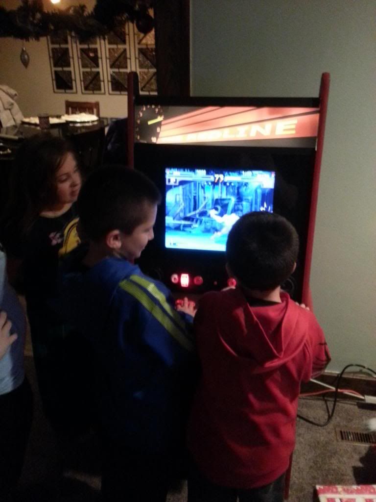

Been lurking on the forum awhile getting ideas and checking out the great builds on here, finally decided to start my own multicade cabinet. After lots of debate, I settled on building a TMNT style cab off the plans on jakobud.com. Always liked the size of it, plus I wanted the 4 player option.
Main cabinet material is 3/4 birch ply -
Layout after lots of measuring -
Cabinet frame standing, no control panel -
Control panel built, I added a couple inches to the length to allow for more button room for players 1 and 2 -
25" Sony CRT I'll be using for the monitor -
I'm expecting the coin doors, leveling feet, wheels, marquee holder, marquee light and tmolding today... so hopefully I'll make some progress this weekend.
« Last Edit: March 09, 2015, 02:47:03 am by zackt69 »

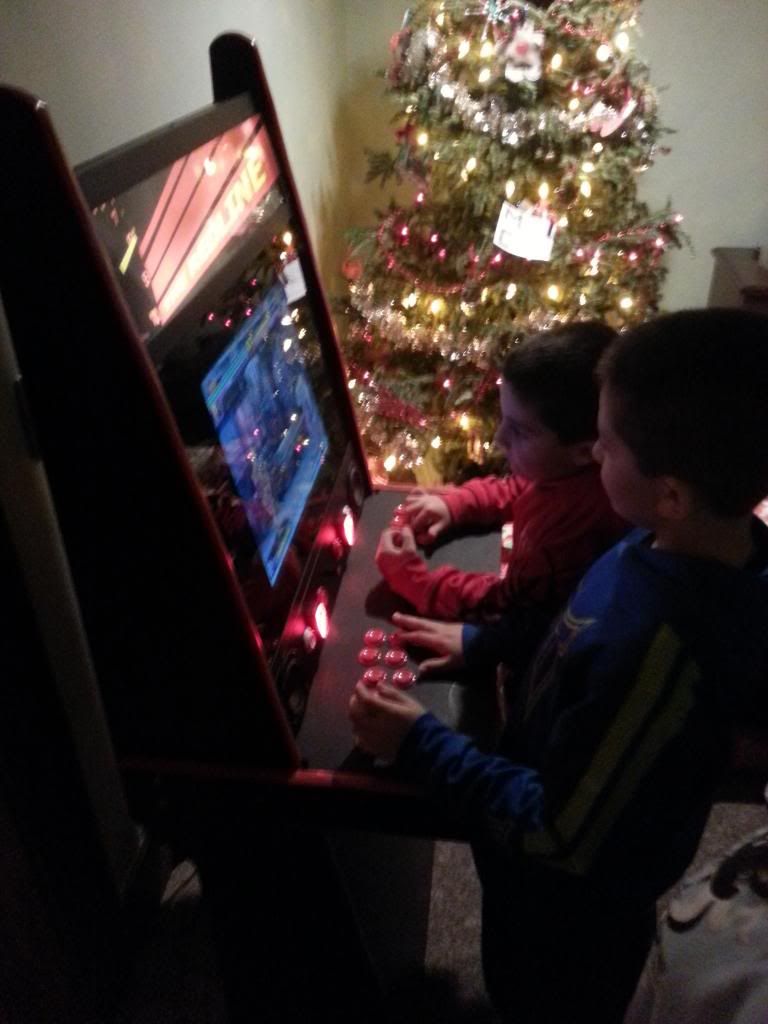

Here's a little update -
Keyboard shelf hidden under control panel (closed) -
Keyboard shelf hidden under control panel (open) -
Marquee plexi and molding installed -
Wheels and adjustable feel installed -
Handle installed on top, still have one more to install on the back -
Rough test fit for monitor to check size and positioning. It's coming out of it's case for final install -
« Last Edit: January 19, 2015, 12:44:45 pm by zackt69 »

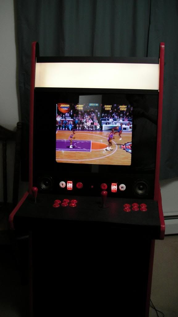

Got the bezel piece cut -
Started on the back panels -
Marquee light is wired up and working -
Cut the hole for the monitor in the bezel and booted up the computer to check it out -
« Last Edit: January 25, 2015, 04:00:12 am by zackt69 »

All disassembled to prep for laminate/paint. Also cut the slots for the tmolding once I had it all apart -
Never applied laminate before, tested on a small back panel -
