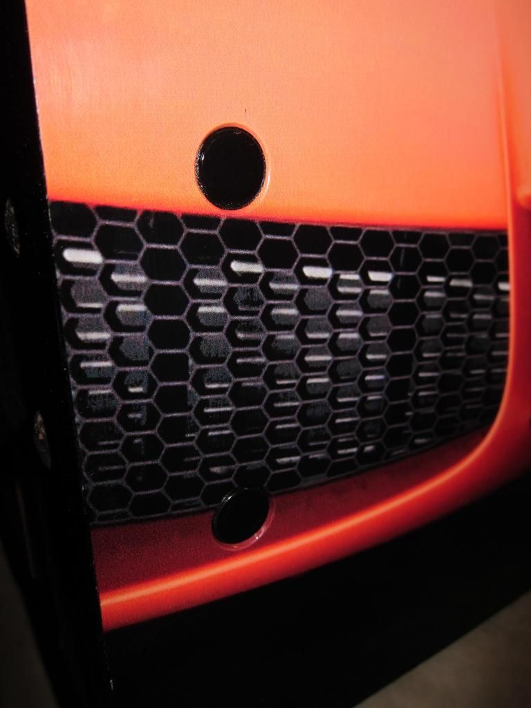

I came home to find a package leaning against the front door.  Clear the dining room table sweetie!  It's time to get this build moving!
Originally, I went over to a local sign store to get a quote for the decals.  $600+ after tax.  Crazy.  Speaking with the salesman, I could tell that he had never printed decals for a project quite like this and his suggestions on the material were questionable.  Spending that much money on an educated guess wasn't good enough for me to pull the trigger.
Then, I remembered that Lucian045 had offered his printing services to the community.  I contacted him, we chatted for an hour and I could tell my artwork was in good hands.  As I mentioned in my first post, Lucian045 is a huge asset to this community.  I made the artwork - he made it a reality.  He is knowledgeable, helpful, and got the artwork to my door very quickly.  If there's any question in your mind whom to use for your next set of decals, Lucian045 (Brad) is the best.  Hands down.
http://forum.arcadecontrols.com/index.php/topic,134866.msg1391705.html#msg1391705
The packaging was top-notch.  It had an outer layer of protective paper and it even came with an applicator!  Thanks, Brad!

Next up was the Marquee Plexi.  What a terrible adventure this was.  Shaping Plexi is probably the most miserable thing I've had to do thus far.  I did a rough trace of the marquee hole, then cut the oval out with my scroll saw.  From there it was all belt sander...  I used the coarsest grit I had (120), taking a little bit off at a time, trying not to leave the Plexi on the belt long so it wouldn't melt.  Once I was satisfied I polished the edges with a buffing wheel.  Maybe took an hour to get it looking acceptable.  Not perfect, but once it's mounted I don't think anyone will be able to notice the imperfections.
Drilled out the holes, pealed the plastic protector and applied the marquee with some soap and water - just a rough cutout to get the air bubbles out.  Now to let it dry overnight...
« Last Edit: December 22, 2014, 02:29:33 pm by ghetoprobe »
