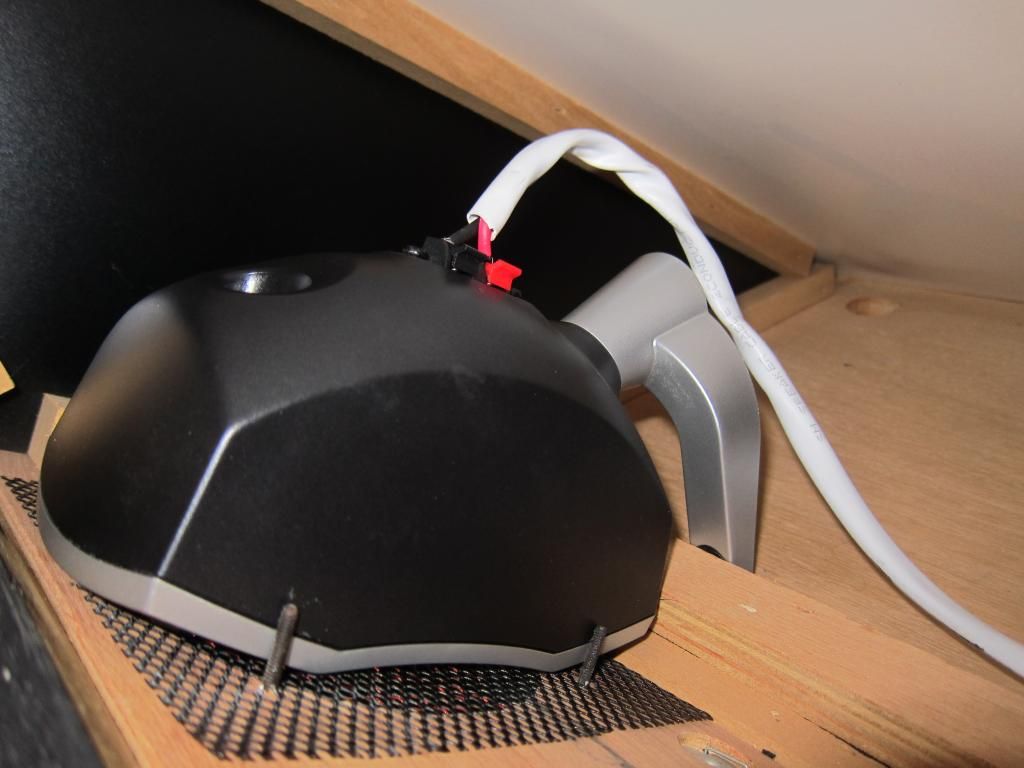

Next up:  wiring the "left" and "right" speakers and mounting the "center" speaker.  I purchased a bulk roll of 12 gauge speaker wire on eBay (250FT Speaker Cable 12AWG Bulk Audio Wire CL2 In Wall 12/2 Gauge).  It barely fit in the speaker terminals, but it's some serious wire and I'm glad I went with such a thick gauge.  For the "center" speaker I just covered the white cable with some black 3/8" shrink tubing so it wouldn't stand out.  I'm sure no one will ever look behind the speaker, behind the steering wheel, under the dashboard...  but I'm anal.  What if someone drops a pretzel and looks up at this hideous white cable?!  We can't have that.
And I know the "center" speaker looks like it would get in the way or you might hit your knees on it, but it's tucked back further than you would think.  The steering wheel will completely hide it from view.

Re: "Streets of Rage - Robinson Edition" : Racing Cab Project
« Reply #23 on: December 18, 2014, 11:01:10 am »
I was with you right up until the center speaker. Other than that, I've been watching with interest.  :cheers:

I promise you won't even notice it once everything is put together.  Thanks for looking!
(I don't really know where else I could put it that would still be "hidden")
« Reply #25 on: December 18, 2014, 11:08:23 am »
same boat, thought you'd cut a hole in the pedal back board and mount it behind that. What plans do you have for the flooring and tmolding?

« Reply #26 on: December 18, 2014, 11:09:59 am »
 :stupid
I think everything else looks outstanding, and I'm enjoying the thread.

« Reply #27 on: December 18, 2014, 11:17:49 am »

So I've started on the shifter housing.  I've read a lot of threads and seen quite a few ways people have tried tackling these.  The shifter seems to be beat up more than any other part of the arcade controls.  People just slam on them.  In other builds I've seen they're either mounted directly to the dashboard, which makes you unnaturally reach out for the shifter - not like a true car at all.  Or, the shifter is precariously hanging off the console and wiggles around, looking as if it will break off at any moment.
It needed to come out away from the dashboard to be in a "real" driving position.  It needed to mount to the cabinet in a straightforward way so I could easily remove it in the future.  I also wanted it to look as attractive as possible.  Oh, and it needed to be build like a tank.  Hmmmmm.  Here was my solution :
