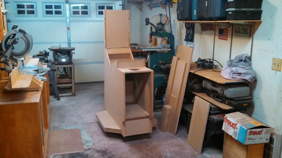

I used a ton of pocket screws.  no MDF is edge screwed in this project.
So all of the joinery is going to be done via pocket screws?   I absolutely love using poket hole joinery - but I've been wondering if pocket screw joinery would be strong enough - in MDF - for an arcade cabinet.
Do I see some biscuit joinery on the side panels too?
I will be anxious to hear as to how sturdy/strong the connections are after you get them together.

The four sub assembled sections (everything between the two side pieces) were pocket holed and glued.  This is faster and easier than biscuits for my purposes, and these pieces are easy to access and hold or clamp in proper alignment while screwing.  it's a little fiddly to do odd angles because the screws are angled and want to slide the two parts out of alignment on the slippery glue.  If you can clamp the pieces in alignment it's easier and that's what I try to do most of the time.  You can also just push the piece about 1/16" towards the screw side and let the screw pull it over into exact alignment as you tighten it.
The sides go on with biscuits.  the reason is that biscuits help with alignment and positioning.  I don't have access or time to screw the sides on through pocket holes inside the case.  it would be trying to screw in 20 screws and pay attention to alignment while the glue is still active.  With the biscuits, I pop them in, glue each sub assembly and drop it on, then apply glue on the top side of them and pop the second side on and clamp.  I can get it all done in 5 minutes or so so the glue is still active when the clamps go on.
With either system combined with wood glue, it's never going to come apart.  the screws never go into endgrain which will not hold screws in mdf.
