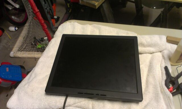

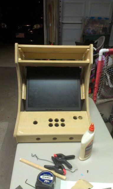

Monitor is MOUNTED!!  The original Dell was scratched on the LCD, so I had to abandon it.  I ended up using the Proview (or whatever it was).  The new monitor didn't fit in my MDF bezel, so I went the more traditional route of VESA mount (which this monitor didn't have...it was a pre-VESA standard mount) and bolted/glued it to the sides.
First, removed the monitor's bezel and painted it:

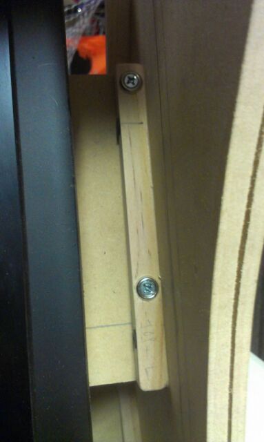

Next, mounted it with 1/2x1/2 hardwood dowels to the side using a 1/2" MDF mounting board.
Here's the back:
Here's the front detail:

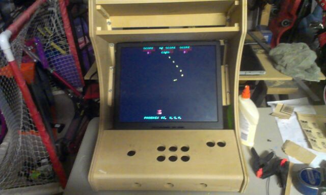

Here it is mounted:
I don't know what it is, but between my phone/camera and the lighting in my garage, everything I build looks effed up and crooked.  But, I assure you it is square...  :soapbox:
Plugged in the garage laptop and ran the only ROM I had on it....PHOENIX!
Next up is ordering the arcade-y bits tomorrow, routing a channel in the back of the CP for plexi, working on the art (I still need a concept...but I think I'm close) and getting this thing buttoned up with paint, speaker cloth and details.

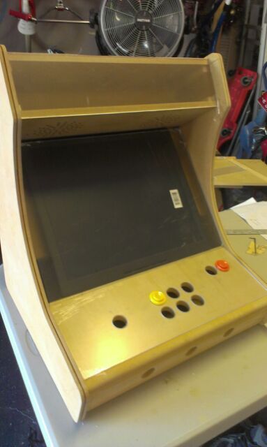

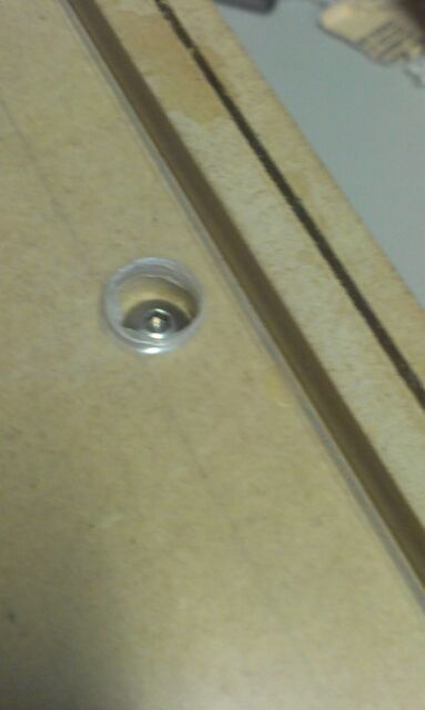

Big issue today.  I was going to bend the plexi around the CP, but when I was routing the plexi, I accidentally dropped the CP and it cracked at the joint.   :badmood: :banghead: :banghead:
So, thinned down some glue and saturated it with several seeping coats.
Re-inforced the back of the joint...
So, I decided to do CP plexi only.  I also got the plexi cut for the bezel and the marquee...
Just have to buy the xx-n-1 card, joy and buttons....get the art squared away and then it's done.

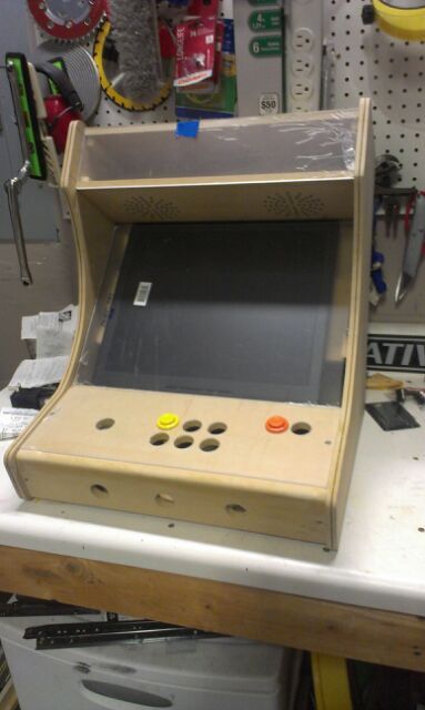

Small update.  I got the plexi for the CP mounted and I was able to mount the CP to the chassis tonight using the cap-screw theme.  Drilled holes in the plexi, then anchored the CP to the batons underneath...
detail:
Overall, a good look.  Should pop with dark CP art and chrome bolts...
To be honest, I'm a bit stuck on the art, so I've been tinkering around with some themes.  It'll definitely be black with some cool mechanical artwork, but I usually start with a name, then work out from there.  :dunno
Artwork to come.  I'm gonna put my head down and get on it hopefully have it done by Friday since I have to go to maine next weekend, so it's a perfect time to get it printed.

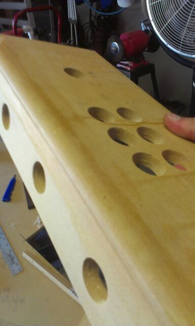

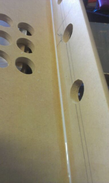

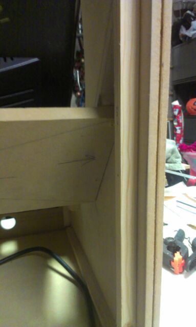

« Reply #54 on: January 27, 2014, 11:29:01 am »

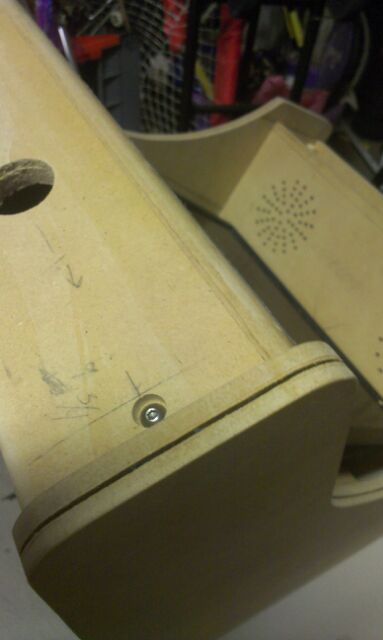

Batons (1/2" square dowel):
CP:
Fasteners used throughout:
Back of CP angle:
CP Mounting:
Thanks,
AJ

Here is the Weecade with the control panel installed and the plexiglass cover on it. Looking pretty slick with the new black skin and controls.
I framed up the speaker area with some extra wood around the marquee area to completely surround the Bose speakers themselves. I drilled 5 holes with forstner bits and glued in some very powerful magnets. On the speaker cover frame, I have 5 short screws in the same areas that hold the speaker cover grill to the Weecade. It works great and allows you to remove it to adjust the volume if needed.
Here it is with the speaker grill back on. Note, that I don't have the plexiglass cover to go over the monitor yet...
