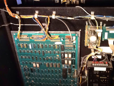

PCB as first removed from cabinet

Back at the shop tested the 2nd PCB, and this one also did not boot :censored: Again, started the diagnosis process, and this time had success after discovering the board was not supplying the right voltage, and replaced some key power components.
Completed PCB with all add-ons and installed in finished cab
