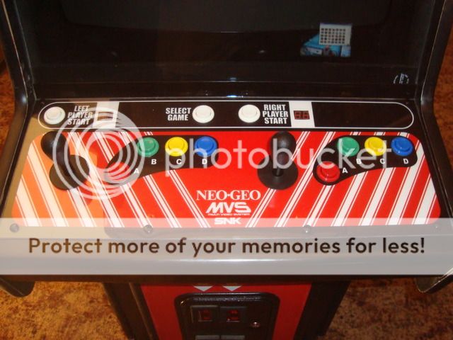

Some people add a 7th button on the lower left not because a game utilized 7 buttons, but to keep the button layout similar to what was on the original arcade game.
Mostly the run button in Mortal Kombat 3:
and the Neo Geo four in a row:
The games are just as playable with six buttons in a rectangle, especially if you haven't spent a lot of time playing them on the real machines.

That layout was made by motorfish, and at one time he offered a download in psd format with layers to make it easy to customize.  I never could find that exact one, but I did find another one made by AceTKK that he even admits is heavily borrowed from motorfish.  I personally like it better and you may want to check it out.  All labels are separate layers.  All graphics are separate, simply select which layers you want and discard the rest.
Here's the pic of it:
And the download is at:
