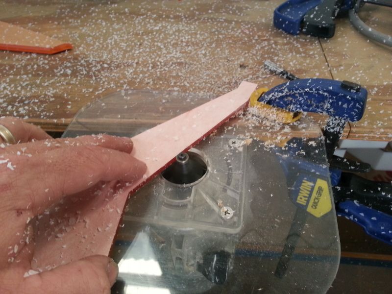

I was bored and had to hang around at work waiting for a client to pick up some work so I thought I'd have a little play.
I've been wanting to design an all acrylic bartop cabinet as I have all the tools to work with it and I can do it in my sleep. The advantages of being able to glue rather than needing to hide screws and  no need for painting make it appealing to me and I hate woodworking...
Obviously inspired by this

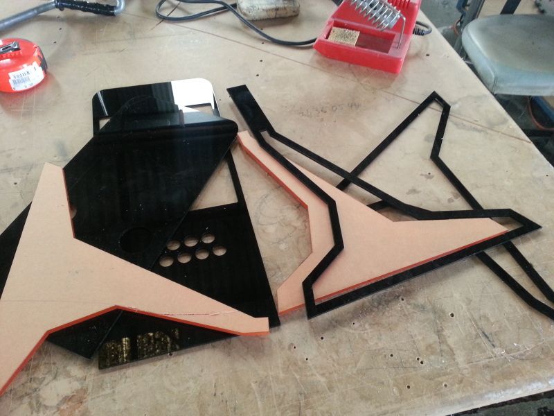

I started with a half scale test run, fired up the LASER cutter, dug out some scrap material and I have this

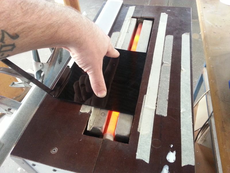

Next to the line bender
A little 45 degree chamfer on the edge
Tidy up the edge with a flame polish

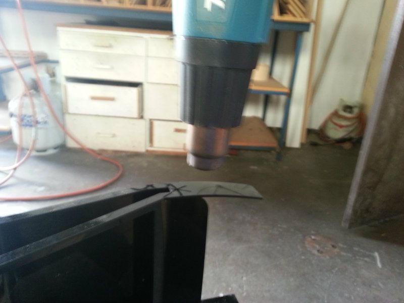

A little heat to form the round edge

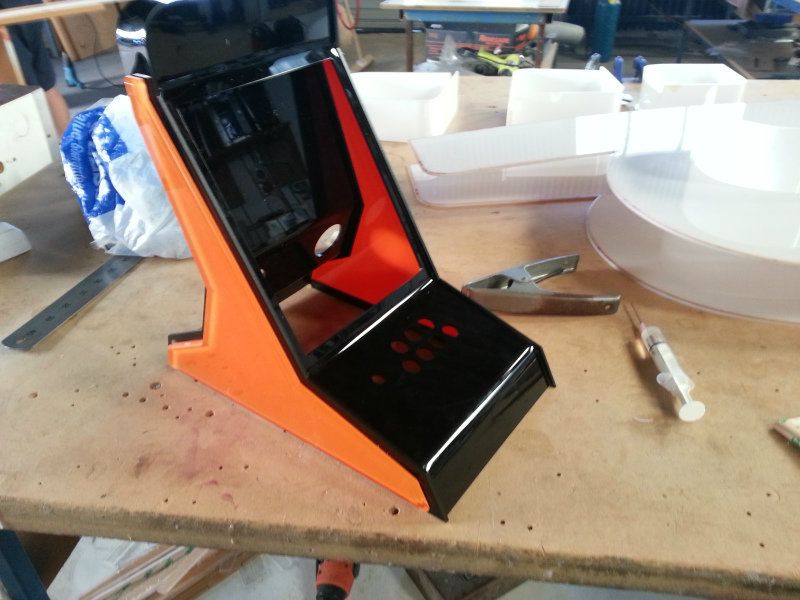

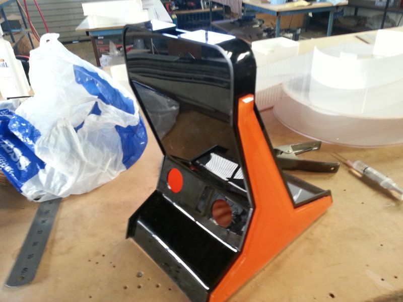

A bit of glue and here we go.
There are some issues I will have to fix before going full size but not bad for an hours work.

Very nice. What if you do not have a line bender at home. Can you recommend an alternative?

A home brew line bender is easy enough. You can make one with some element wire, a motor speed controller and an arc welder. I can supply more details if anyone is keen. The easier way to bend acrylic in a clean line is to use a heat gun and a few pieces of MDF spaced a minimum of 3 times the thickness of the material apart to keep the heat contained to a clean line and fold away.
